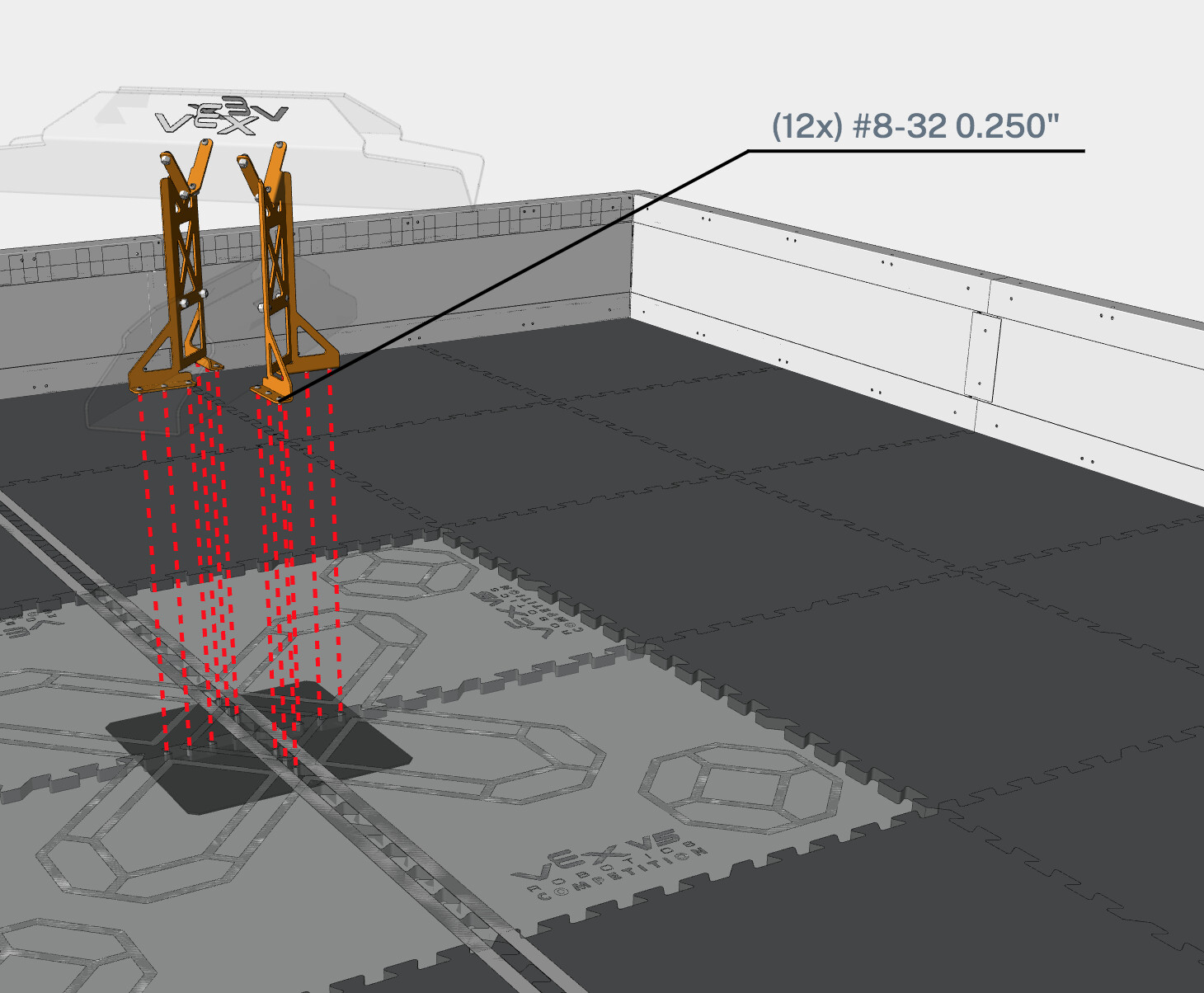

We have mangaged to do the field permiter and tiles howerver its unclear how the game elements work such as the center goal, this is because the plate is supposed to be mounted under the field but how do the connection points reach the goal? How do you install it and the other goals we have read the manual and yet its still unclear.

12 screws in this case.
Screws go through the plates into the standoffs they come with. Then screws go through the center goal into the standoffs

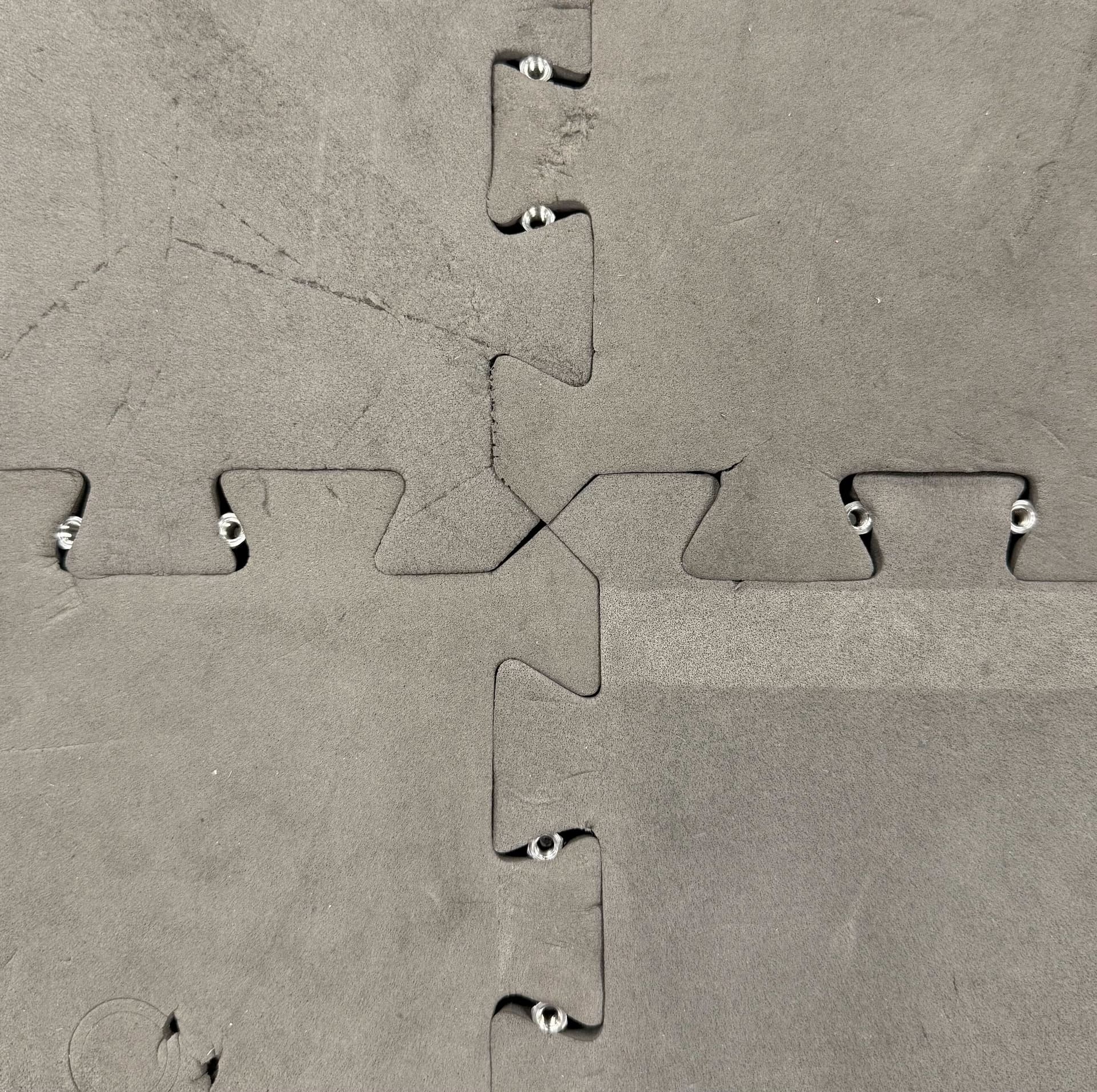

My question is the image shows the plate goes under the mat but how do they go through the mat
As indicated in the assembly instructions, in between the tiles (tabs), fit the provided standoffs attached to the plates to come just to surface level. Use the provided screws to attach the goals to the plates.
Standoffs on the base plates come up between the tile teeth. You’ll have to squish the tile teeth a bit to get everything in place. Then you should be able to see the standoffs poking through like this:

Thanks for this, this image is significantly more helpful than the renders inside the instruction manual

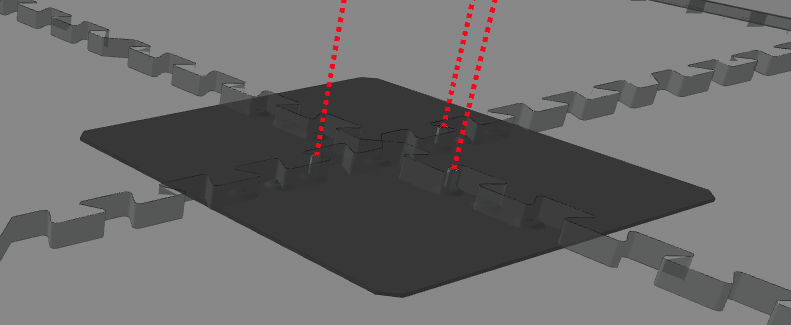

I saw those… but they are not especially clear as to what part of what tab the standoff goes through. I was using PDF…, can you rotate the 3D version?
Yes, the 3D version is interactive. You can rotate, pan, zoom, and manipulate any step to help you get different angles/views of what is going on.
Yeah the pdf doesn’t show how the standoffs go through the mats
yes you can rotate, pan, tilt, zoom into the model. It makes it useful for looking up close at things.
