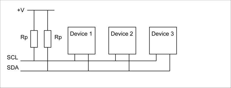

I was curious if this Integrated Encoder Module will work with arduino
Theoretically yes. You would have to write you own I2C driver for the Arduino to support the IME, however, this is not trivial if you have not written low level I2C firmware before.
It is probably a herculean task but here is a write up of someone integrating I2C sensors.
To use the Vex I2C, the message structure would have to be interpreted to the Arduino.
Looks like it includes the wire library for managing the I2C.
Not easy nor for the faint of heart…
So obviously the WIRE library will be a must.

The issue is that the I2C address for each sensor is by default the same so it is hard to distinguish sensors.
Doesn’t the cortex communicate back to each sensor at initialization handshaking to address each of them in the daisy chain differently?
Ah yes, here is the awesome thread by who else? jpearman!
This is JVN’s explanation of what is going on in the handshake
