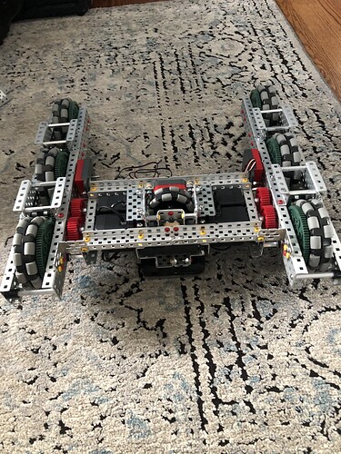

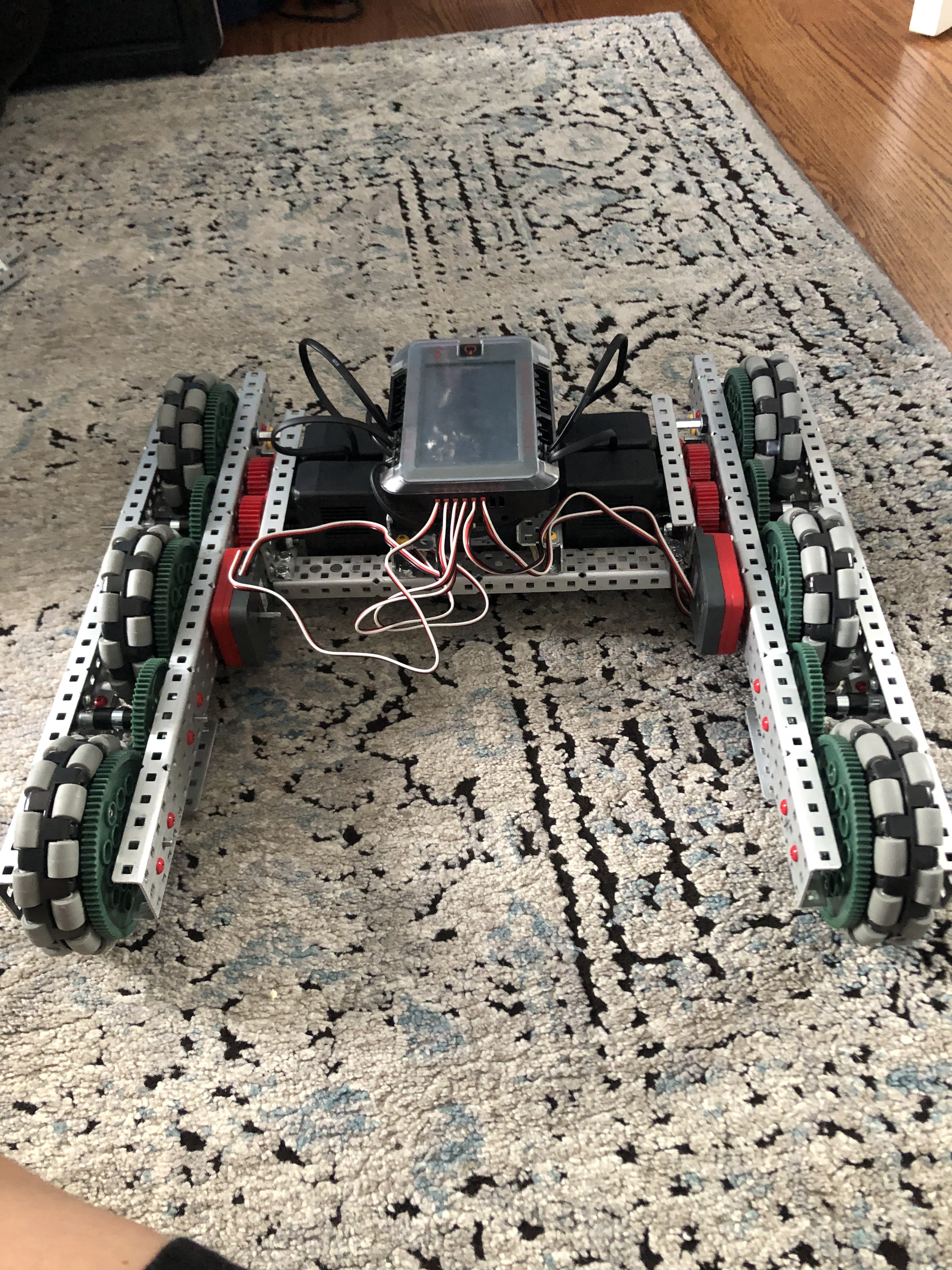

I have completed the drivetrain I plan on my team using for Over-Under, it is a tank drive with a total of 6 wheels connected to the motors via a system of gears. I implemented an odometry system within the chassis as well, but the way I did it was by connecting 2 of the 3 shaft encoders directly to an axle that is connected to one of the 6 driven wheels. The other shaft encoder is connected to a dead wheel. I am concerned that there is something I am doing wrong here, because all of the odometry systems I have seen teams use are connected to exclusively dead wheels. I’m not an expert on odometry or anything, so I don’t know if this is something that isn’t a big deal or will ruin the odometry system.
The issue with attaching odometry encoders to driven wheels, and the reason that most teams use passive “tracking wheels” is because of wheel slippage. When the motors on your drivetrain send power to the wheels to turn them and in turn move your robot, there is a decent chance that the driven wheels will not grip the surface of the field tiles perfectly and will slip some amount. This rotation of the wheel without a corresponding movement of the robot will introduce an error into your odometry calculation which can compound very quickly into a sizeable error in your position. Therefore it is best to use undriven wheels for which the only resistance against the tiles will be their own inertia, which will have negligible slippage if done correctly. It’s worth noting that this is merely one component of building a good and accurate odometry system, and that for small movements or small time slices it may be simply “good enough” to utilize encoders on deiven wheels for odometry calculations.
Adding on to what sazrocks said, there is no right way to do odometry, only a most accurate way. Using seperate dead wheels on a hinge to maintain constant contact with the ground will result in the greatest accuracy by reducing wheel slippage. On the other hand, if you don’t need your odometry to be as accurate, it is possible (though not recommendded) to do odometry using only the motor encoders and no external shaft encoders. The decision ultimately comes down to how accurate you need your odometry and whether you have space to implement seperate dead axle wheels.
