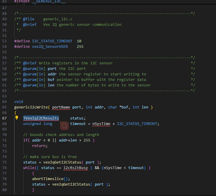

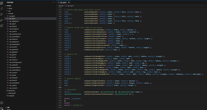

Thank you very much for your reply, and I am very sorry that I seem to have been a little verbose. I seem to have some new discoveries, and here IIC and UART related code, because it is encapsulated into a library file, through the function return value definition and input parameter definition, I can guess what is probably doing, but I still do not know where to find the details of these functions?
The code comes from:
C:\Users\pc\AppData\Roaming\Code\User\globalStorage\vexrobotics.vexcode\sdk\cpp\IQ2\IQ2_20231003_10_00_00\vexiq2\include\iq2_api.h
Great project, that’s a great start, but I’ve noticed that the project seems to be using ROBOTC as a programming tool, which doesn’t seem to be officially supported anymore, and the prevailing approach now is: VSCODE or VEXcode IQ, but I did not find the IIC-related API code in the C++ support page [Comprehensive Guide to C++ on VEX IQ (2nd Generation) — VEXcode Documentation](https://VEX IQ (2nd gen) C++) , and VSCODE seems to be unable to directly fail to? Did I miss anything?

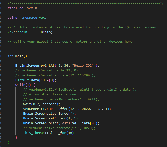

Yea, you shouldn’t use those. There is a C++ class for i2c, uart would just use stdio. Not near a computer for a few days so cont help much more right now.

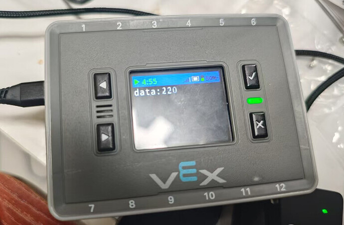

I successfully read some data, very simple, much simpler than I thought, even do not need to simulate a VEXIQ sensor, only need to directly read the IIC bus.
Use any controller as long as it can be used as an iic_slave.

you can use the vex::generic class and avoid the low level C calls if you want. For raw IO use.
