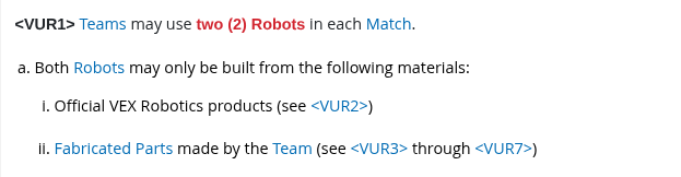

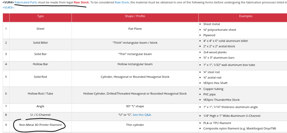

Well, according to the VEX AI subsection of the manual,
So, referencing the VEXU subsection of the manual:
for 3D printing, see VUR1a.i, VUR3a, and VUR4.9

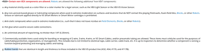

for rubber bands, the rules remain the same as in V5RC. See R20g
