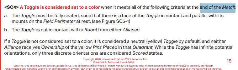

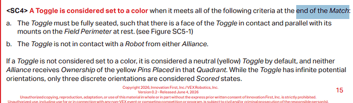

The game manual states that the Toggles are only scored at the end of the match. They don’t count for anything during or at the end of the Autonomous Period, for the end of the match is defined as 5 seconds after the Driver Control Period. You may flip the toggles during auton, but they won’t affect the score of the match until the end of driver.
So in short, no, flipping the toggles in autonomous does not affect the score of the Autonomous Period. I hope this helped!
