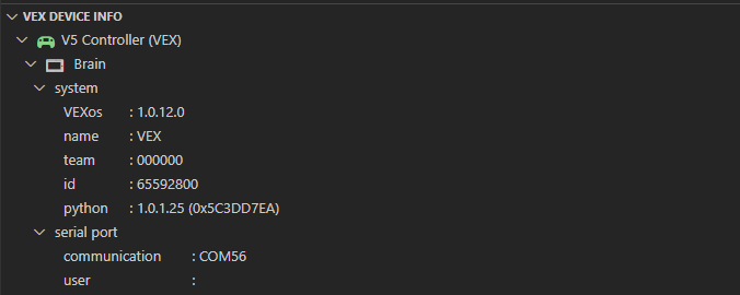

To update a brain through a controller you will need to:
  1. Connect Controller to Brain using smart Port Cable
  2. Connect V5 Controller to PC using microusb.
  3. Power on brain and controller.
  4. Open VSCode with VEX Extension Installed.
  5. Verify Controller is detected by either:
  6. Open VSCode command pallet by pressing:
    • Windows: CTRL + SHIFT + P
    • Mac: CMD + SHIFT + P
  7. Run the following command below:
  8. You should see the following modal appear:
  9. Press update button on modal to begin vexos update process through a controller. DO NOT UNPLUG during vexos update.
