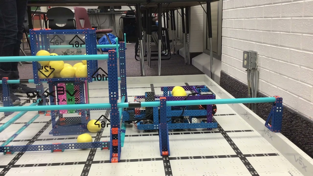

So on my bot, our main issue is the catapult. Although it works, it’s not nearly as accurate as we would like it to be. We also had to use four rubber bands, but I know @FRC973 only used two.
Here is a vid of what it is doing. ( this is what it does every time) Test 1 - YouTube
You see when the ball slightly goes back when the catapult is loading. It shouldn’t have that space to move. When the ball is in a different position, it can make it inconsistent. Try making the area where the ball stays smaller.

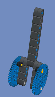

First, try doubling up the beams so there are two 1x beams where there was just one. Then use 0x3 (preferably brand new) pins instead of 2x1 pins because, at least in my experience, they are stronger. If you don’t have any new ones, steal some from the field (at the base of the plastic sheet in the orange pieces). Here’s a drawing of what I mean:
For me, just doing this worked fine, and it was fine being dry fired (although I still wouldn’t do it too much).

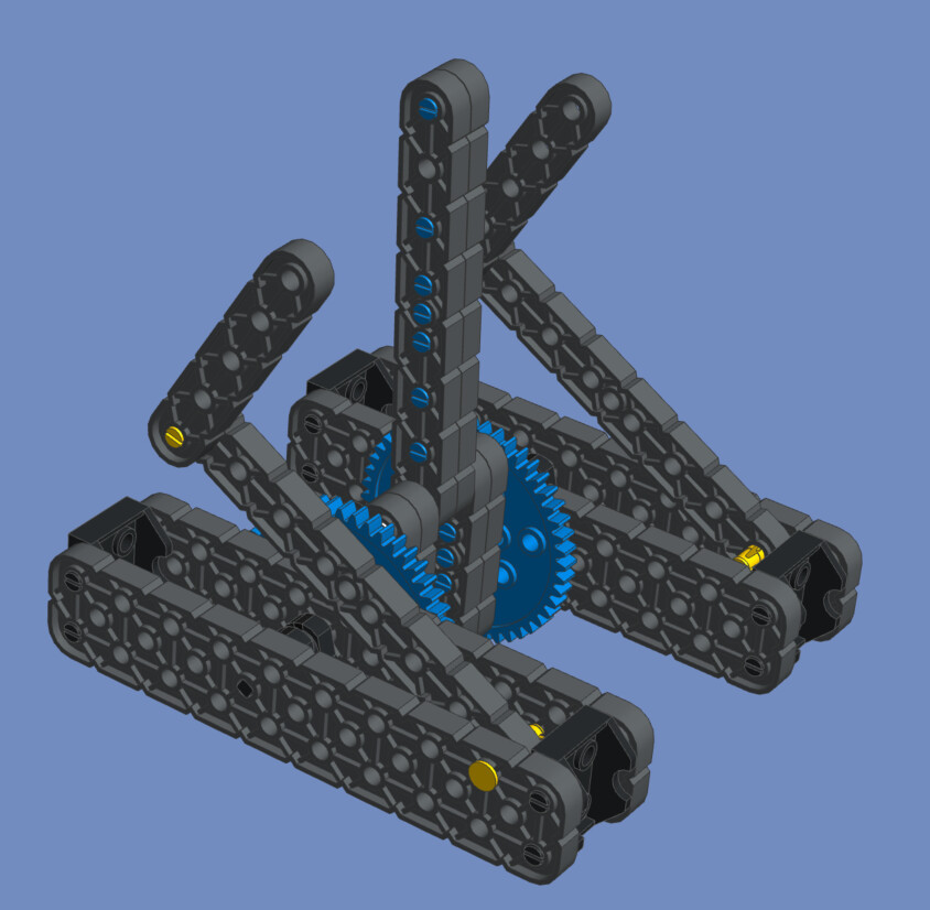

If that didn’t do it though, I would suggest putting the force on different pieces. You can do this by stopping the catapult with other, stronger, pieces just short of when it normally hits the top and the pieces breaks.
Something like this (sorry for the bad geometry, this was just a quick mock-up in CAD). The top holes of the two “arms” are supposed to be in the same hole as the top of the catapult beam, and they are supposed to reach their full extension just before the catapult one connected to the gears does:
Does that help?

Finally, here are the videos
Nice job on the improvements from last time. It looks like it has a lot of potential to get it in the goal.
It looks like you just need to make your shot more powerful. This can be done by adding another rubber band or two. It is important to keep in mind that you will need to adjust the rubber bands regularly, especially at first when the rubber bands are first stretching. After you break them in though, especially if you store the catapult up, you won’t have to tune them as much.
