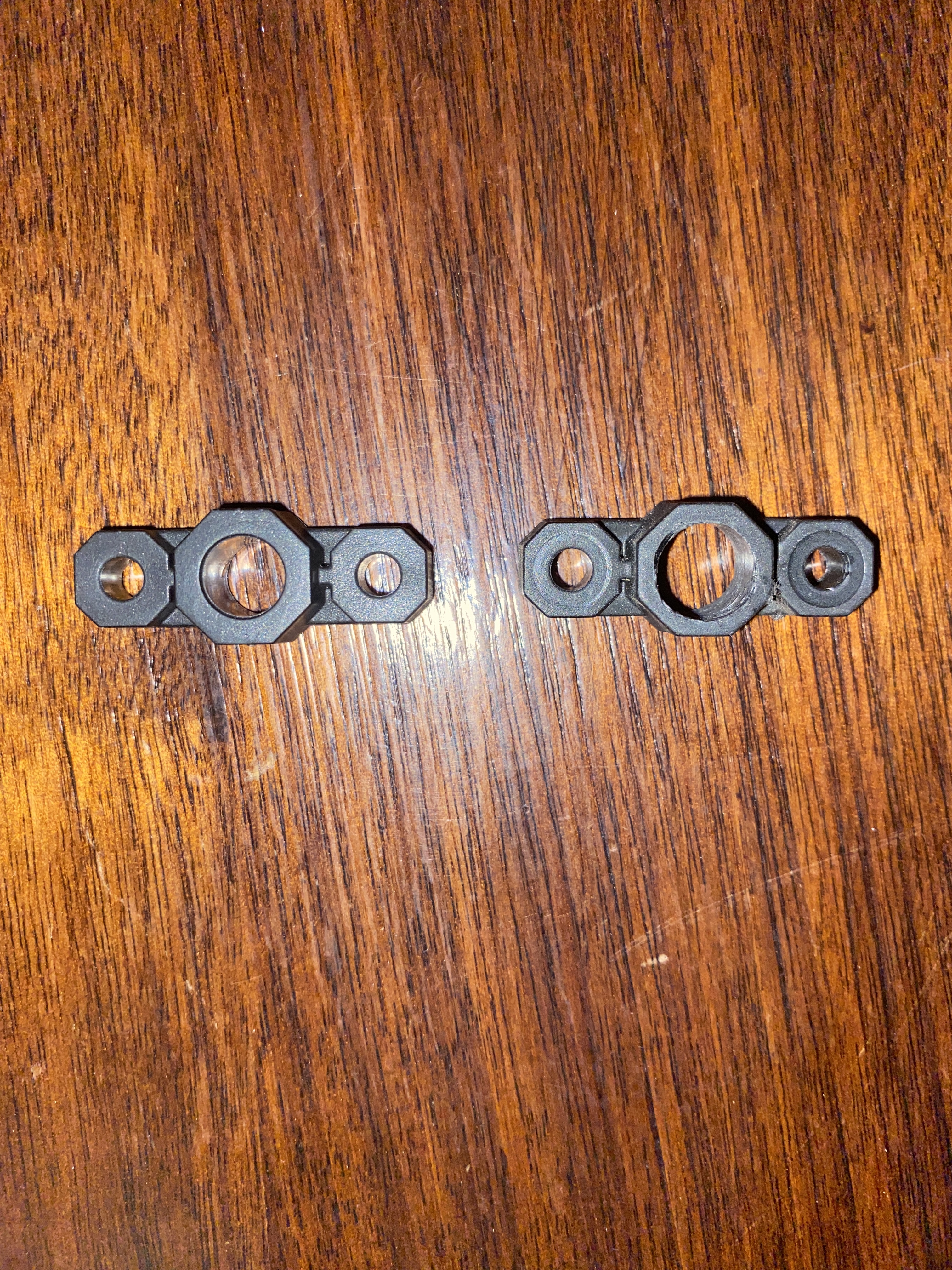

Thanks everyone for your help! I was in the process of trying to see if any parts were an issue, as per iseau’s soloution. Apparently the catapult had received so much use that the HS bearing flats had been chafed to the point where they weren’t even adding support.
Left: Normal Right:Bearings in question

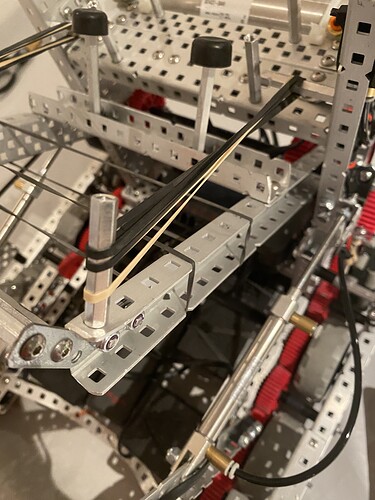

Hello @Jmh
I did not see a rachet in previous photos you sent. It could be the type of rachet. You might want to try using a sprocket, a standoff and a nylon spacer for a rachet if you aren’t using that already.
