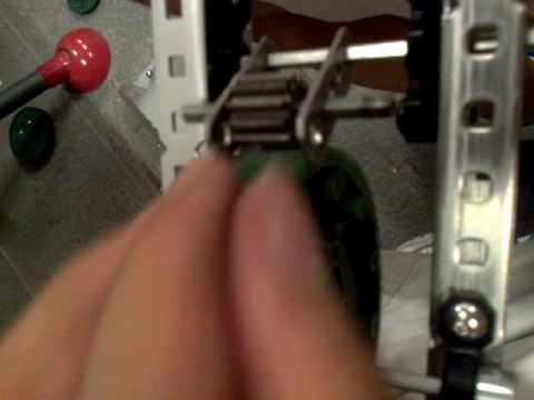

For the 84 tooth gear, did you try a 12 tooth gear as a pawl (12 tooth gear connected to drive shaft bar lock)?
You could also try making 4 pawls for each ratchet.
I’ve tried multiple pawls, doesn’t quite work well enough.
I have not yet tried to use a 12 tooth gear, thank you for the idea. Although I do have some worries about how easy it is to turn in the forwards direction. Could you elaborate on your idea?
I am also interested to see how to use a 12 tooth as a pawl.

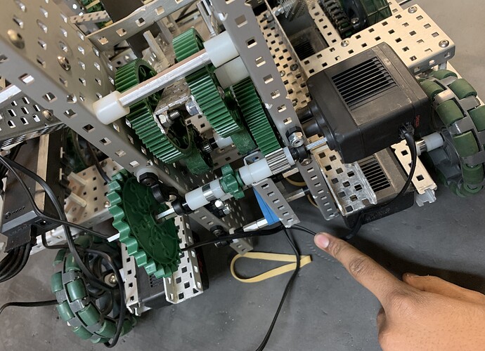

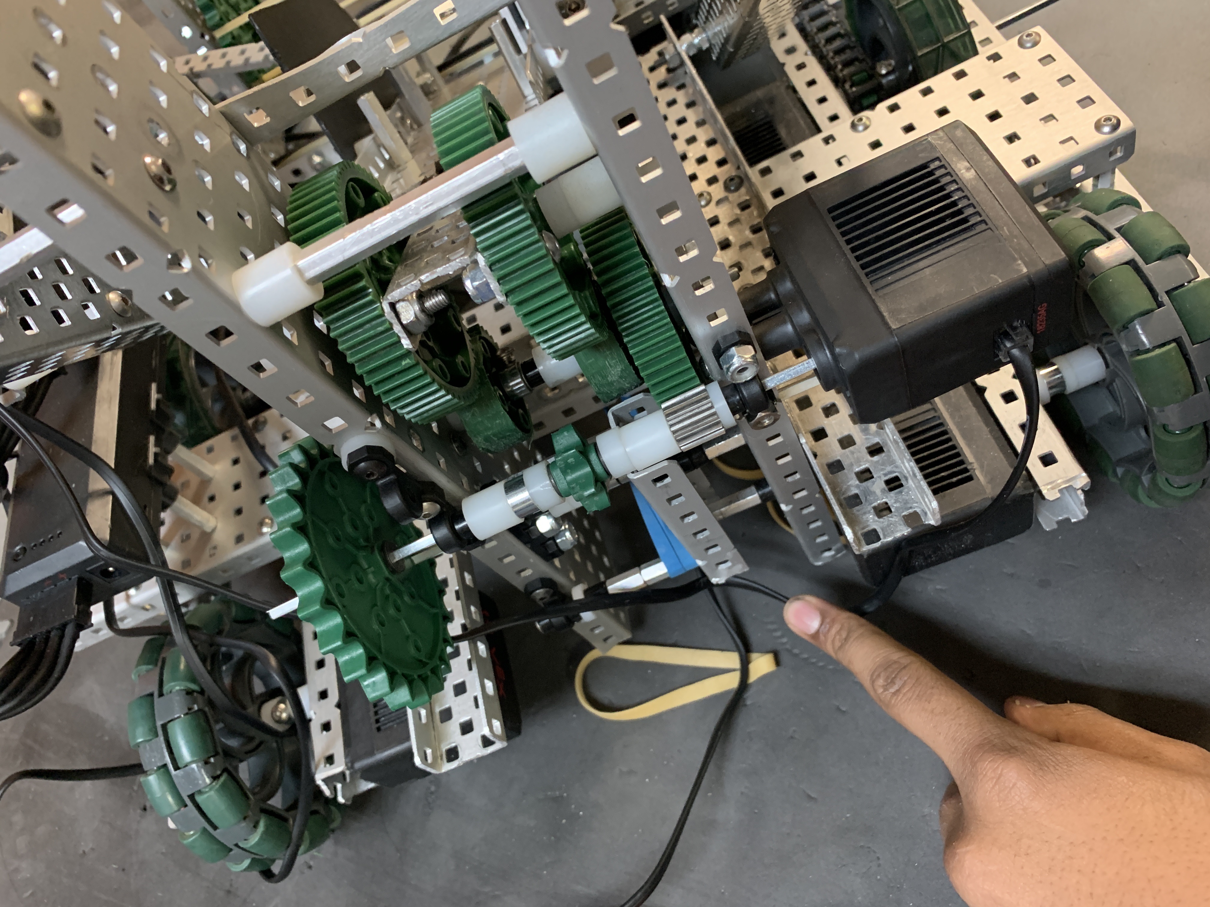

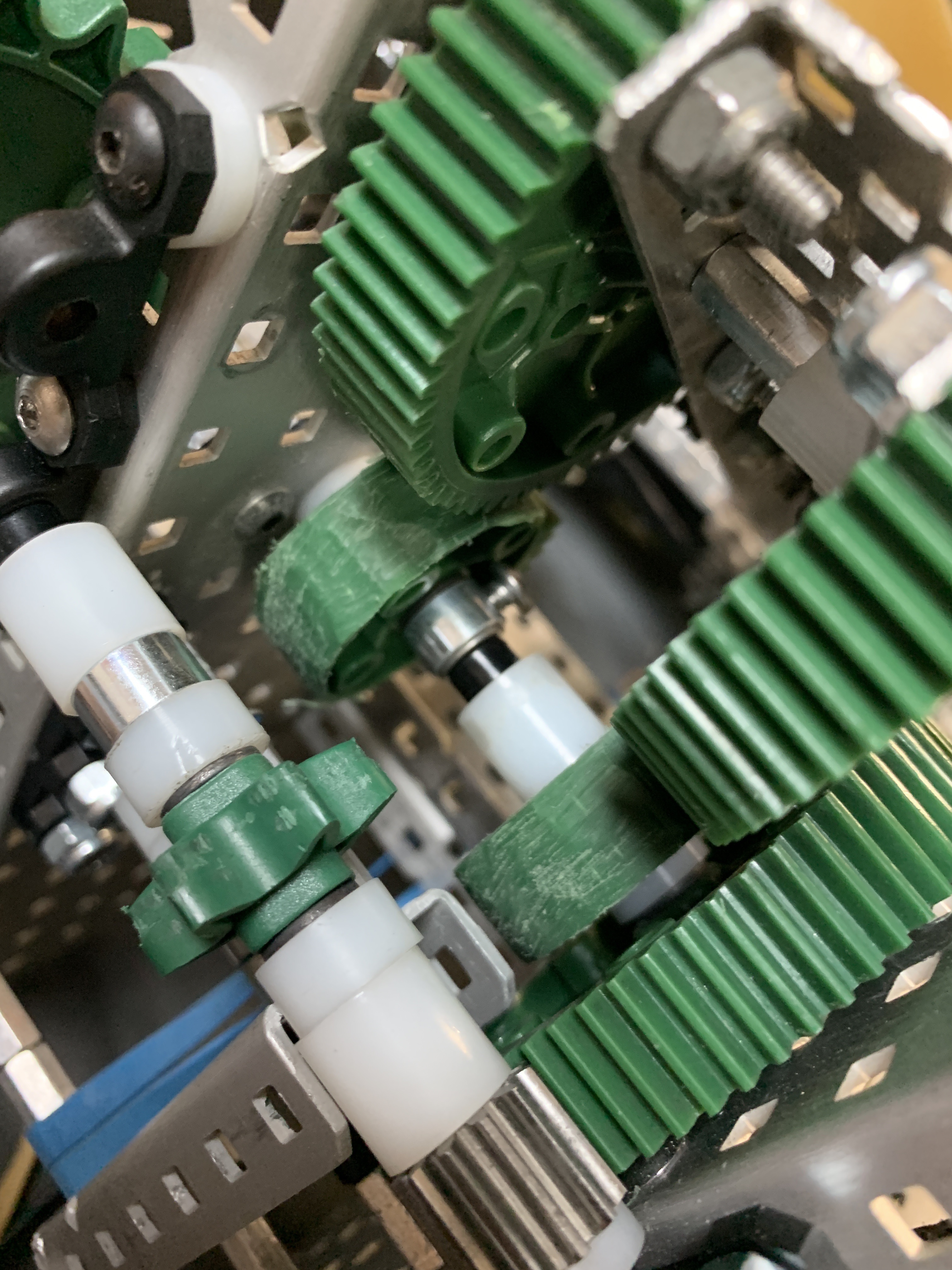

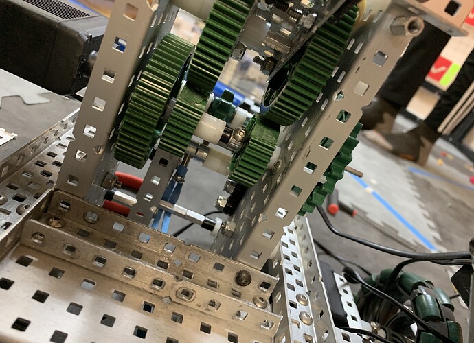

I am dealing with a very similar gear slipping problem for the vex turning point game. Every time I stop at the bottom to load a ball, the catapult simply slips back up. Did this 12 tooth pawl fix it?
you could use a gear ratio so that your ratchet spins faster then the catapult, this way you both get more precision, and the ratchet has much less strain on it. you can pm me if you want more info on how I did mine.
It’s not that that ratchet slips, but it’s the gears slipping. So like at the bottom, the ratchet stops the driven gear from moving, but the catapult simply slips back up.
there’s something wrong with either where you placed the ratchet or your build.
Well meshed gears should never slip past each other
A picture would make your problem much easier to diagnose
Here are some pictures of my ratcheting system and gear box:
