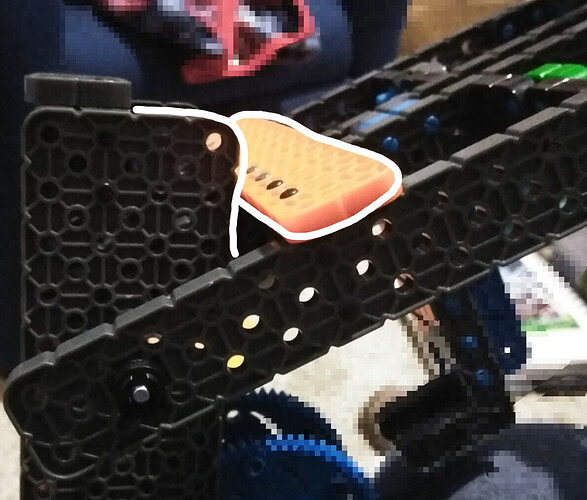

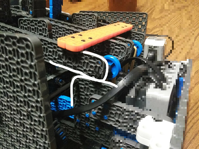

Back to “what is a hard stop”. It’s what your catapult hits after it shoots to a) make it always stop at the same angle b) put less sudden stress on your choo-choo, and c) make it stop less wigly. Here are some hard stops:
On my robot, the back end hits a plate:
On my test catapult, a beam runs across the catapult arm and hits the frame:
On this year’s Herobot, the arm of the catapult hits an axle above it:
Screenshot 2022-02-22 9.36.28 PM
Incidentally, all three of these catapults hit the frame of their robots in different ways. Nevertheless, the idea is the same: release the energy shock into the balls and the frame, not the choo-choo; have the catapult stop at the same place every time; stops both sides at the same place, so wigly arms don’t matter as much.

  • Adding a metal shaft hardstop like on the herobot
  • Sometimes forcing the balls too much into each other will cause them to “bounce” against each other and spread that way, so you might try removing the orange and black standoffs on the side.
  • Make sure that the balls load in the exact same position every time, and like was said above they don’t roll around in the little cups. Make sure there is one and only one position they will go in, and if they don’t go directly in that position, they will roll there.
Separately I noticed that the ball jumped over and got stuck on the edge in the video. You can fix this with little pieces on the side that don’t let that happen.
