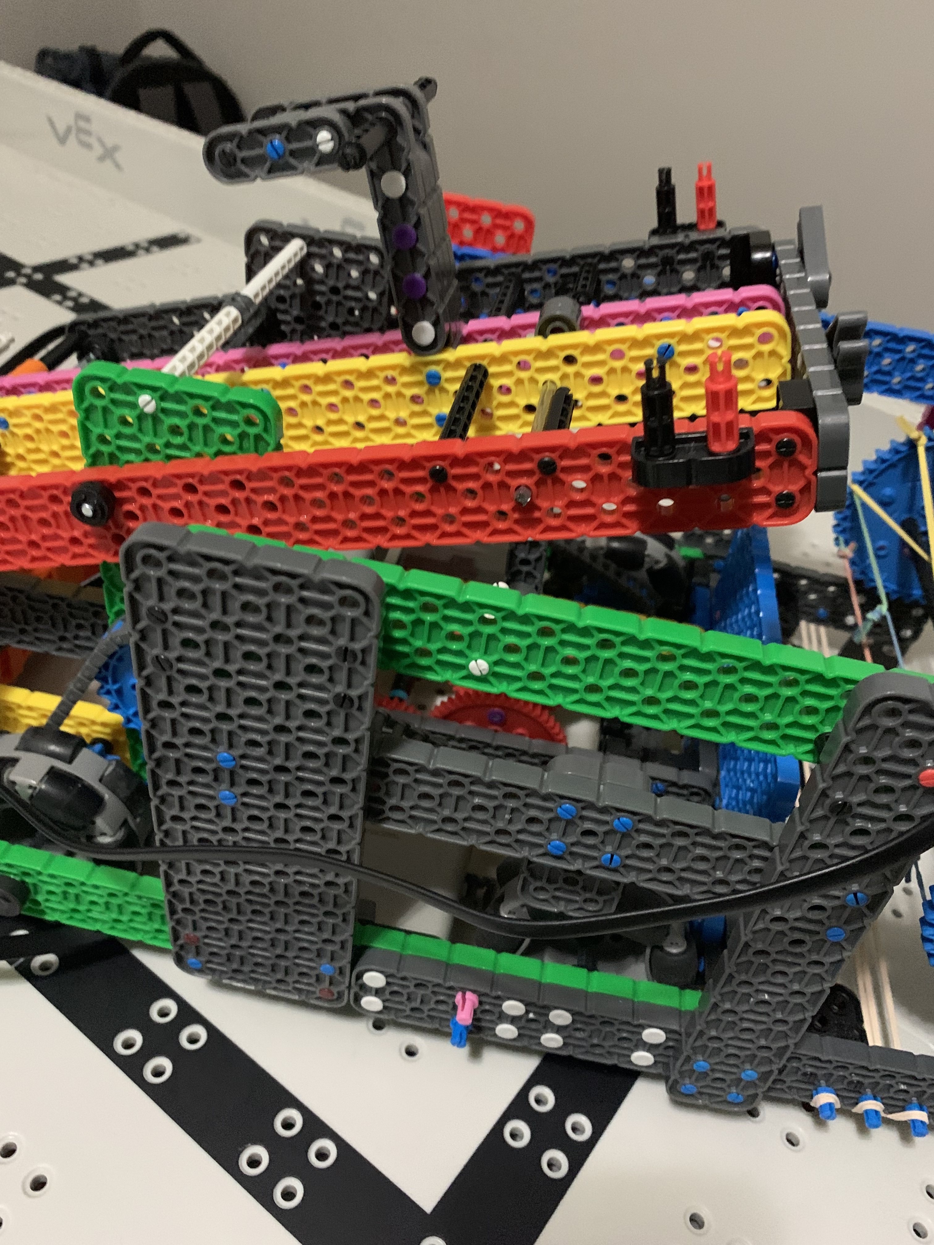

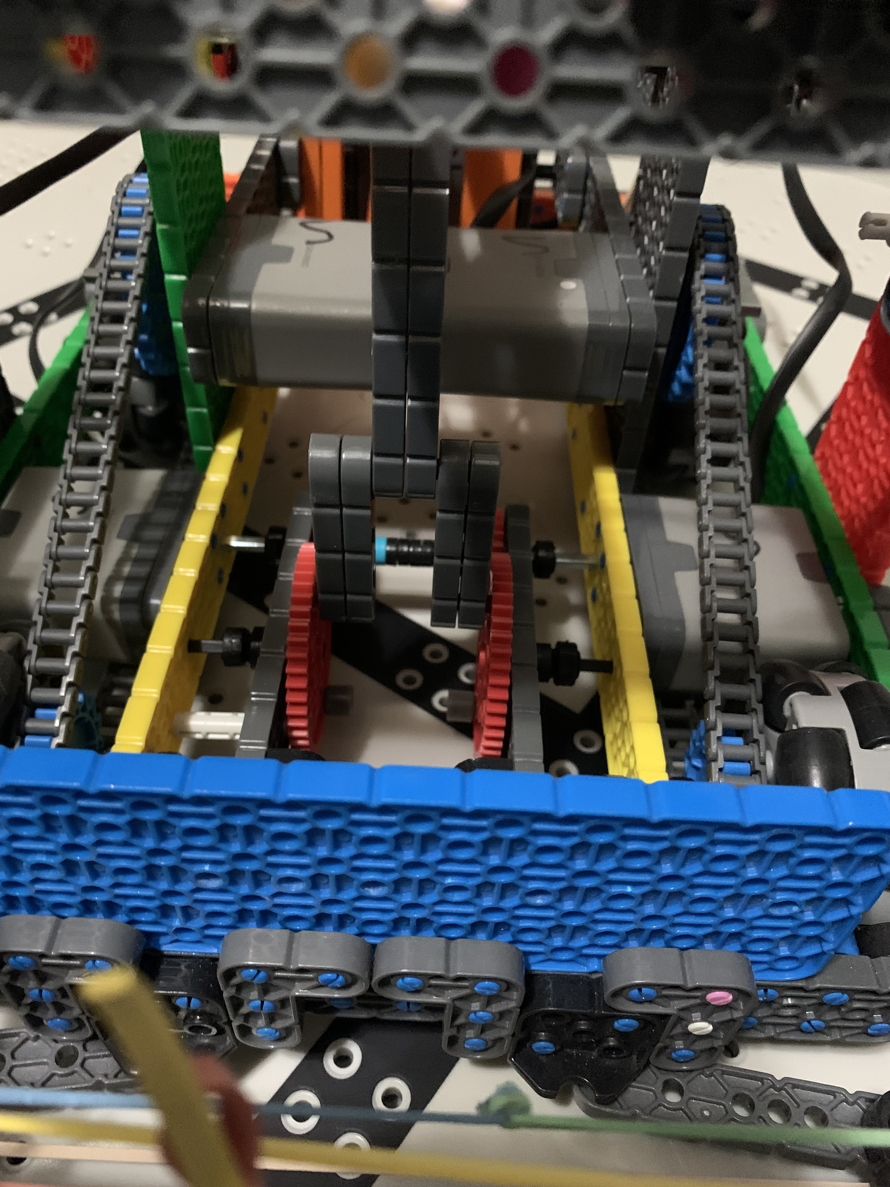

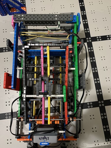

Sorry I can’t be more helpful, but
  1. Have you noticed that the ball closest to the camera always goes farther? Hmmm…
  2. Do you have a hard stop? (On both sides obviously.)
  3. Your balls don’t look very secure in their holes. Do they look to you like they’re kind of rolling around?

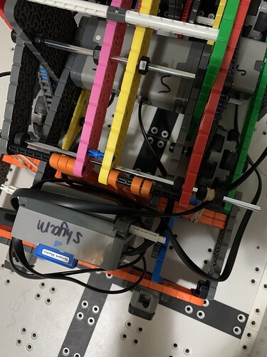

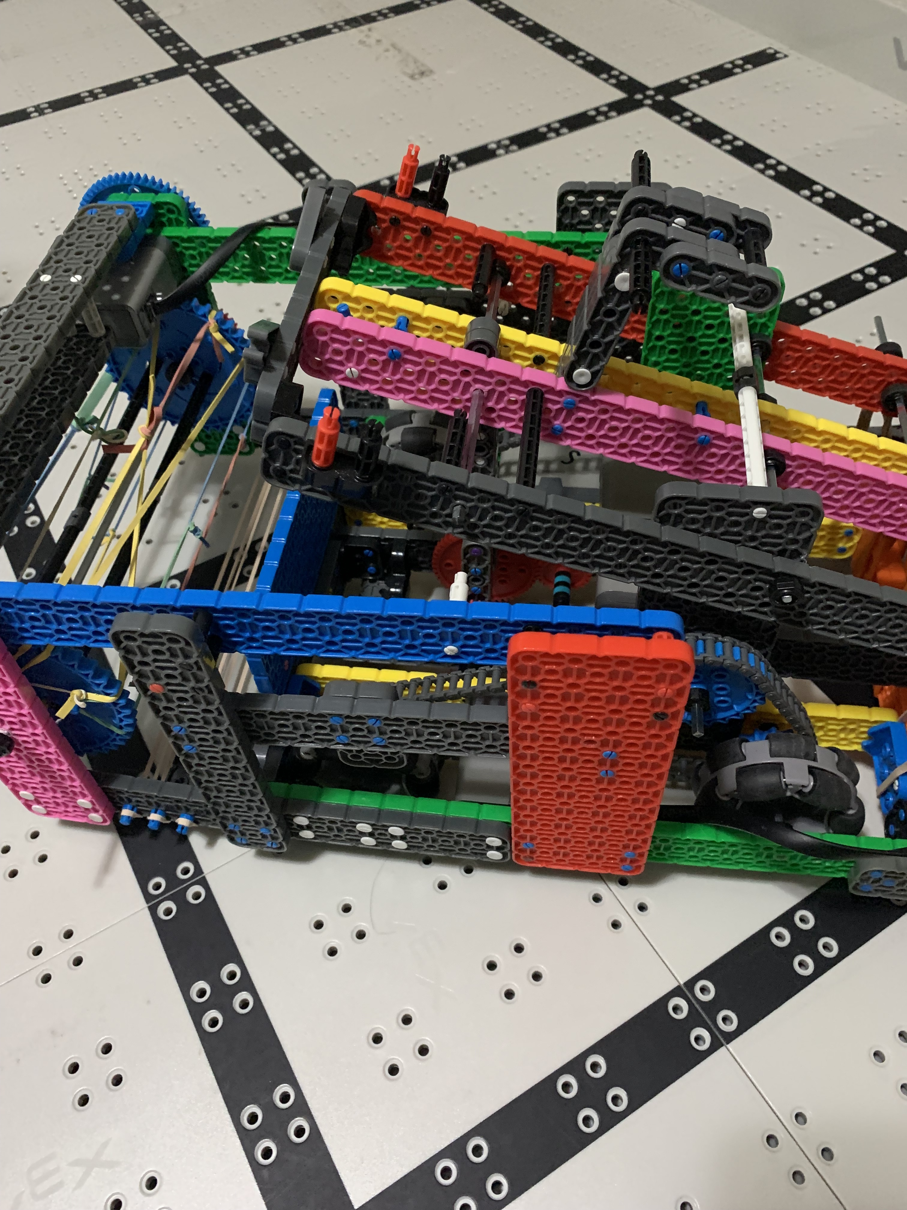

Here are some pictures I took:
