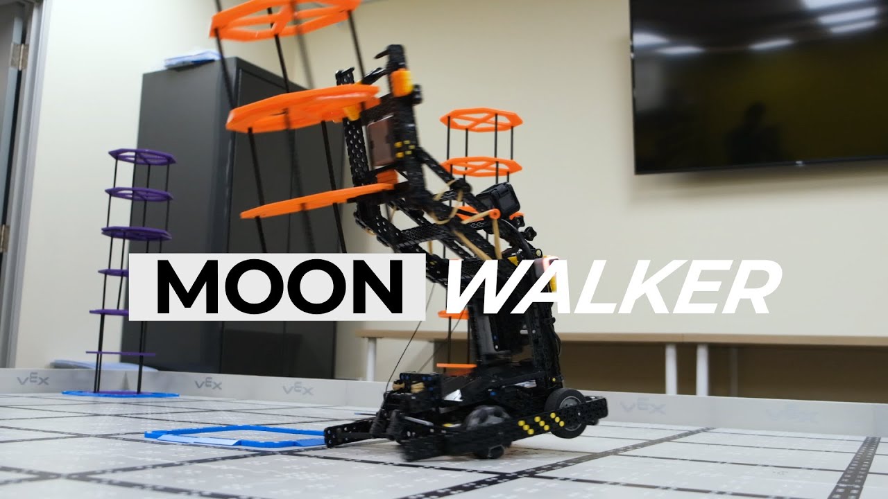

Caution Tape Robotics Presents: Moon Walker - 839A Reveal
Presenting the latest edition of our World Record Holding IQ Robot - Moon Walker.

Sweet bot. What’s the black string that lifts the lower claw? Are they rubber bands?
Its a special hexbug kit :wink:

I can’t be totally sure what rope piece it is, but if I had to guess it would be from the new Construction Zone kit. The colors certainly fit Caution Tape’s aesthetic.
I can’t tell if its two 228-2500-440 (36x pitch rope) or one looped 228-2500-448 (120x pitch rope).
I personally hope it’s one long 120x pitch rope snaked between the arm and the lower claw, that would be rad.
https://www.vexrobotics.com/406-7097.html
It is actually from a kit from a couple years ago if i recall, but I am guessing these parts are identical!
