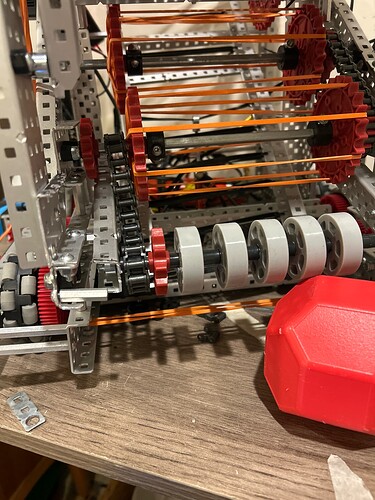

So our intake is working but one thing g. When we run it after a few seconds the sprocket falls off the teeth on the sprockets. Any solutions?

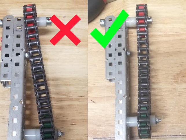

Chain needs to be run in straight lines. It cannot go diagonally. To fix your issue you are going to need to make those sprockets in line with each other.
Fix your chain alignment. I can’t actually see that the chain is connected to any sprockets either. Your current sprocket colors are red, and I know there are green ones too, but I can’t see the chain connected to either of those colors or even a steel colored sprocket. In any case, you have some iteration to do. Log the issue and the fix in your notebook.
I can’t tell from this angle, but additionally make sure to tension it correctly.
Thanks y’all. I just adjusted the intake to be tighter on the joint and the chain runs great. Thanks again!
