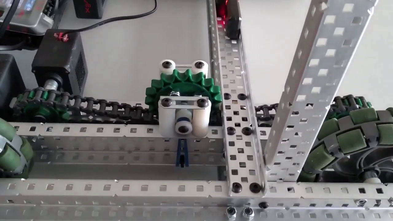

So I just came up with this idea of a chain tensioner that constantly applies some force to keep the chain tight and will adjust itself depending on the stresses on the chain. Upon further research I realized this has been done in the past, but has not been used popularly. Here is the concept I built.
What do you guys think, would this be better than a fixed tensioner, or is it too much work for what it is worth.
I like this idea, although it isn’t very space efficient. It could have neat implementations though.
I think that’s a pretty neat idea. It definitely has much less friction that the common method of tensioning chain by putting a standoff or something similar that rubs on the chain.
It’s definitely a good idea, and something that I can see a lot of teams using or wanting to use, but personally I just don’t see the benefit of using a chain tensioner like this - when we build our drives, we space out everything so that the tension is already good, and the stationary tensioners that we do use are sufficient to keep the chain where it needs to be - adding in more complex moving parts such as this could change the way that the drive would react under different loads - and then I’m asking the question - what is the benefit of this over a regular tensioner? Yes, we need tension to keep the chain taught, but we never needed the chain to be super taught - in fact, there needs to be some amount of slack in the chain for there to be as little friction as possible.
I just use spacers on a screw for tensioning and it works great.

Yes of course you still need to keep slack, especially when operating under higher loads to leave some room for (error)? and I have tried to keep that in mind for this.

If the chain is too tight on the sprockets it will create a ton of friction, but if it is too loose it creates unwanted problems. So people will use chain tensioners to tension the intentional slack on their chain just enough to not cause problems.

Each chain run will have an “optimal” tension, where it’s not too tight creating unwanted friction, and not too loose where it’s slipping, skipping, or coming off. Ideally, you would build with your two sprockets and the chain already at this tension. However, it’s often impractical to do so, so you introduce a chain tensioner to help bring the chain to that tension.
In other cases, you need the chain to have more contact with a sprocket than it might otherwise get, and that’s why you would also use a chain tensioner. Below is an extreme example:
I tried white nylon spacers to tension my intake. It actually added more friction than the loose(r) chain had alone. I don’t have any pics because this was a pretty cut and dry testing phase, but a tensioner isn’t always used.
I feel like I might build my own version of that adaptable tensioner at some point just for fun, and to add an extra design note when talking to other teams or judges. It’s cool, but, as others have said, probably not worth the extra design and building effort. (But it is cool!)
I would be surprised if a tensioner didn’t add friction; less contact will always be smoother than more. However, chain tensioners are nearly always necessary (exceptions may include things like intakes) in order to accurately link the motor to a mechanism with minimal slop, especially now that V5’s IMEs are so convenient.
That being said, a proper tensioner shouldn’t add much friction. Were your spacers screwed in tightly, or could they rotate? You usually want the spacers to be free-spinning in order to minimize friction. We generally do something like so:
in order to keep the screw tight while still allowing the spacer to spin freely.

Yes, I had the spacers freely rotating on the fixed screw, as pictured. The chain wasn’t too tight when the tensioner was added. It just wasn’t absolutely necessary, so I took it off. (My intake was essentially a really small flywheel. Hence why I wanted to see if adding a tensioner would help or hurt the speed. I can track down an old vid if anyone’s interested, but I have posted a link somewhere.)
