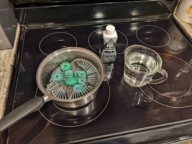

https://smile.amazon.com/Rit-DyeMore-Advanced-Polyester-Acrylic/dp/B00U2IXMIW/fosterworld
Very important, you 100% NEED the dye for synthetics (Rit DyeMore). Graphite is the name of the color. The normal fabric dye does not work.

How hot do you need to get it? Boiling? Just under boiling? Enough to cook a steak in water and it be edible?
My team was hoping to be able to get gears and chains dyed to these color:
image image
From what I have read, this wouldn’t be possible to do. How would you recommend getting the lightest blue and lightest orange possible for gears and chains?
Just under boiling.
You could try yellow dye for the orange, but blue is going to be very hard.
ok, so just enough to cook a steak to edible.
Edited: the original was to be a DM, I’m new to this software.
no. toss it with no seasoning straight into the almost boiling water. you can do that though

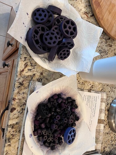

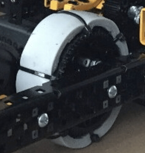

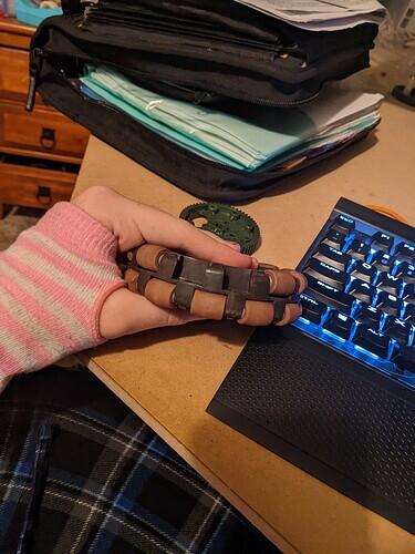

On a serious note, here is the experience I have had with dyeing parts.

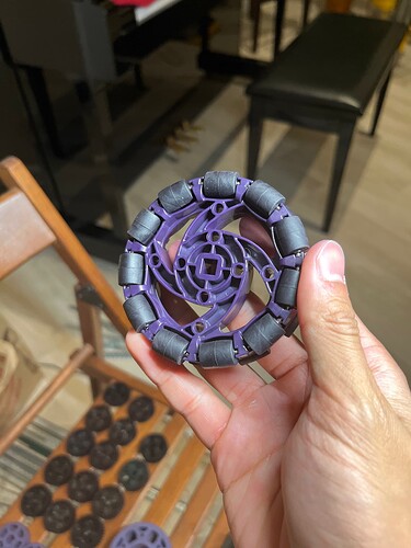

Green 3.25" omnis dye very well, and the dye has not rubbed out of the rollers after several hours of driving.
The dye of the OLD 4" omni wheel’s rollers rubs out very quickly.
For omni wheels, avoid going above 190 °F when boiling. This will warp the housing and make the drive unstable (2 omni wheels went to waste because of this).
30A flex wheels are dyeable, and there seems to be no noticeable change in texture. With constant use, some of the dye will wear off over time, but some of the original color will remain.

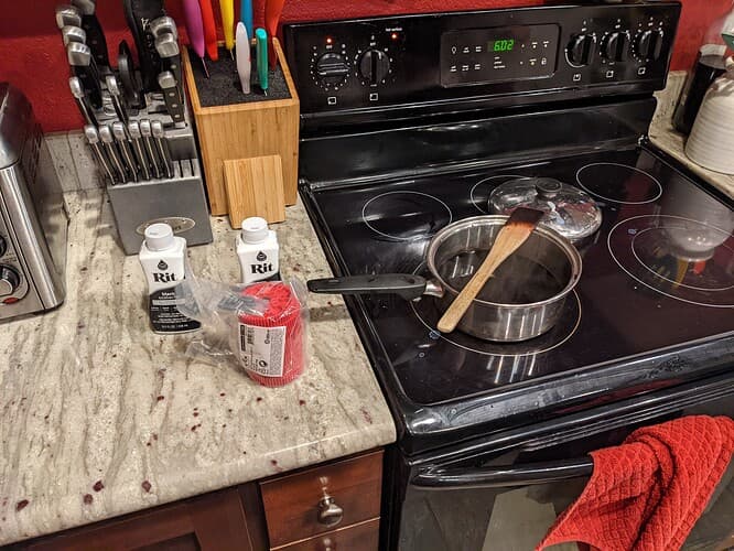

Be extremely careful when putting your parts in/taking them out. This flex wheel slipped from my tongs and splashed all over the kitchen. About 2 hours of scrubbing went in to clean the dye off of everything.
The HS V2 gears take a long time to dye, much longer than the original HS gears.
The dye is only on the surface of the plastic. Make sure you cut/sand the part first, then dye. Doing this the other way around will result in uneven coloring. However, if you like this look, then feel free to do it the other way.
The best advice I could give? Don’t crank up the temperature while waiting for the parts to dye. They take time, and cranking up the heat risks melting your expensive VEX parts.
One more thing: if you dye a disc, keep in mind the dye rubs off extremely easily. A quarter of our yellow discs have streaks of grey due to touching this single dyed disc.

Are the roller still dyed or did it wear off?
Still on. They look the same exact shade as when they were originally dyed.
