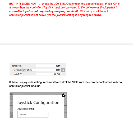

The current behavior of Robot Mesh Studio for VEX IQ is as you’ve discovered:
If the user’s program (Flowol, Blockly or Python) includes the Joystick Controller, then the program is compiled and downloaded in such a way that requires the controller to be connected (either tethered with the wire, or via the radio). If you start the program and the controller is not connected then VEXos waits for the controller before starting the user program.
If you’re writing a user program which doesn’t use the joystick controller (for example for a Programming Skills Match), then make sure not to configure the controller in the right-panel.
Thank you for your feedback here. We’ll look into ways of making it more obvious what’s going on.
I think we encountered the issue we did because when we did [detect sensors] the joystick was detected, if that makes sense, but we had no joystick dependency in our blockly code. We simply instructed the bot to drive forwards as a way of testing the chromebook / comms / brain setup. So we were confused when we could see the program compiling and downloading to the VEX and it just sitting there. It was by trial and error that i went thru the settingsn, moved joystick to none and it worked. Then we switched it back and it didnt work again. That was when we figured out the connection.
Something a little more obvious would help, but of course we are wise to it now and have documented it for our teams!
