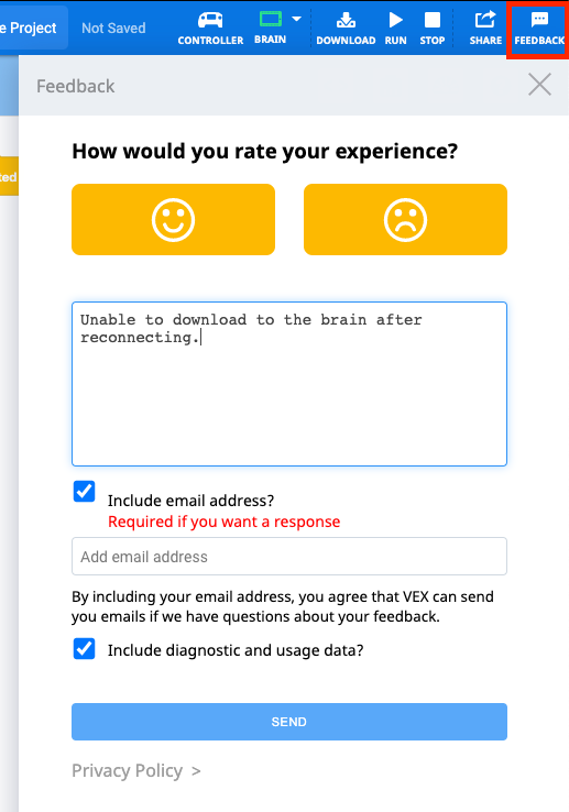

We have a few students who are having issues downloading their code to their robot’s brain. For some background, we have Lenovo Chromebook 500e gen2s and 3s, and V5. Students are using the Web Store version of the app. The web-based app doesn’t seem to be too reliable at the moment for us for this particular issue.
What happens is they have their robot plugged in and the download button within the app is there and clickable, and it works the first time. Then, they unplug the robot and do some testing, and when they plug the robot back in to edit their code, this time the download button isn’t there.
Just wondering if this is expected behavior or something that we can potentially fix.
We’ve found that (this is with the robot plugged in after the download button does not reappear, mind you) if the student saves their code, completely exits out of the app, relaunches and reopens their code, the download button is there, however, I don’t believe this is a reasonable solution if they’re making multiple edits to their code every few minutes as according to the teacher, this was not always the situation.
I’m willing to pin this on ChromeOS and being funky with USB connected devices, but I’d like to hear if anyone else is experiencing this as well. Our Chromebooks are running anywhere between v. 121 and the latest 123. Troubleshooting with the class yesterday found a couple running 122 having issues, and 123 not having issues at all, however I’m not fully convinced that a simple OS update will resolve this…
