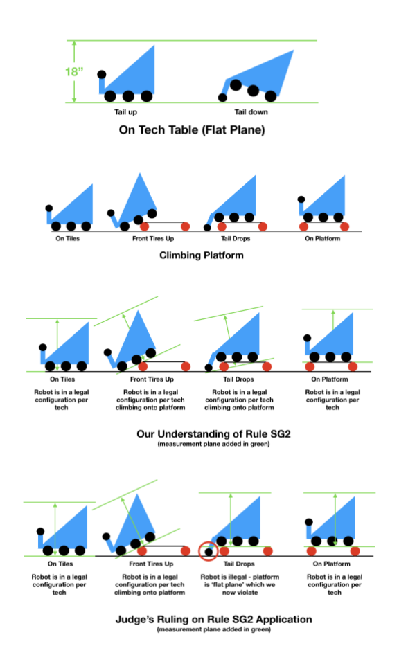

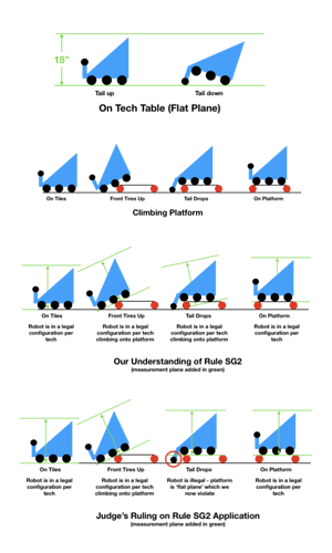

Robot is a 6 wheel design that has a ā€˜tail’ that is mounted to the back of the robot on a pivot. At the start of the match, the tail is in the up position tucked against the back of the robot to fit inside 18" cube. It is possible for the tail to rotate 180 degrees down which lifts the back wheels off the ground. However, no matter what angle the tail is at (between full up and full down), the height of the robot never exceeds 18ā€ as measured on a ā€˜flat plane’ per . Please refer to ā€˜On Tech Table (Flat Plane)’ image below.
The robot climbs the platform by driving up to it and the front two or four wheels climb up on their own. The tail is then dropped which pivots the robot onto the platform and the tail is then raised back up. Please refer to ā€˜Climbing Platform’ image below.
Text (excerpt) of
The 18ā€ height limit specified by refers to the Robot height when it is placed on a flat plane, such as a field tile or an inspection table. An 18ā€ tall robot which tips slightly while climbing a Platform would still be legal.
O​ur interpretation of the rule:
When the tail drops, the robot changes configurations from one legal position to another (remaining legal during the process). By the wording of the rule, in any stage of the process below, if the robot were removed from the situation and placed on a flat plane, it would be just as legal as it was on the Tech table at the beginning of the day. Please refer to ā€˜Out Understanding of Rule SG2’ image below.
Judges Ruling:
When the robot pivots forward onto the platform with the tail still down, it is now sitting on a ā€˜flat plane’. That plane is horizontal and so a measurement perpendicular to it in the vertical direction results in a height greater than 18ā€ and is therefore an illegal expansion outside the expansion zone. Please refer to ā€˜Judges Ruling on Rule SG2 Application’ image below.
Our Position:
The judges ruling was incorrect as it arbitrarily defined a flat plane for the purposes of height measurement on and in plane with the platform when our robot was not yet fully on the platform. The robot was still in a legal configuration and tilted as it continued to climb the platform.
  1. The rule is clear that the measurement is to be made as the robot sits on a flat plane. At the point where the robot tilts forward and the front tires land on the platform, the judge’s position is that we are now fully on the platform and therefore he defines a new temporary horizontal measurement plane on the platform to rule the robot illegal. If at that moment, we were to pick the robot up from the platform and set it on a floor tile in the exact same robot configuration, the robot would be legal.
  2. It is our clear position that at the moment the robot falls forward onto the front tires, the robot is in a legal configuration and is NOT yet fully on the platform, but is still tilted in the process of climbing the platform. While the robot ā€˜appears’ to be sitting level because this is how it often sits when on the floor tiles, it is no as it is in a different configuration. Therefore the robot expansion measurement should be considered in a tilted state where it is clearly legal.
  3. A robot that is in a configuration that is legal on the tech table cannot become illegal on the field because of its orientation.
We are asking for an official ruling on the legality of this design so that teams going forward to remaining state, regional, national or Worlds competitions have a clear understanding on how to apply the rule.

One, the only way to get an official ruling is to post this on the official Q&A as has been stated above. I also agree that your team is playing right at the boundary of the rule. For a brief instant, when the front wheels hit the platform and your tail is still down, I personally would say that it appears that you are exceeding the 18" expansion limit. At that instant, you have completed your tilt and therefore do not remain under the protection of the tilt exception to the expansion,. I realize that this seem a bit nit-picky, but it is the way I see it. And since this is the case, and you are using this to make the climb, the points that you gain could be match effecting. Therefore, you could be subject to DQ.
Cool design, I like how simple it is. But, sadly, like @lacsap, and @536Mentor I would have ruled against you. I would have considered the flat plane to be the platform and the robot and the lifting wheel would have put you over.
