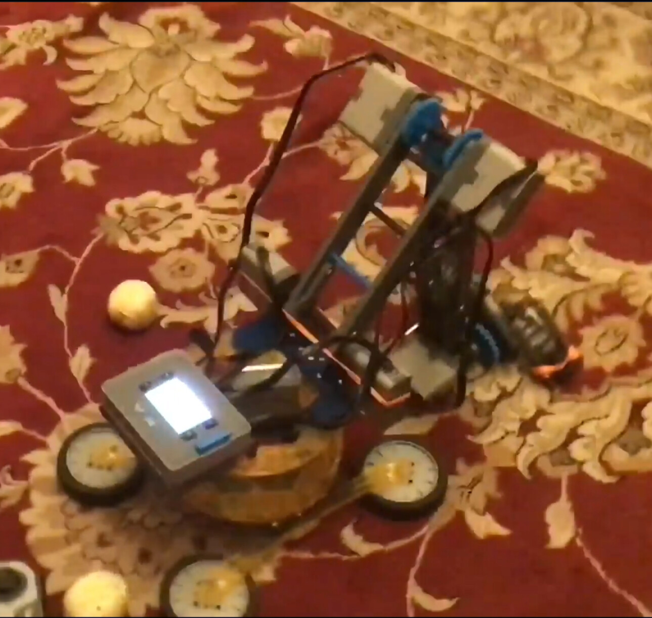

Perhaps a robotic arm is being thought of? I did make one a few years ago, so here is a picture (sorry about the quality):
Explanation:
  • Motor housed in the yellow base rotates an axle connected to the gripping surface (wheels on their side), rotating the whole top of the mechanism because the wheels resist rotation
  • Two motors (the ones with the rubber band around them) move part of the arm up and down (geared for torque), acting like a shoulder
  • Two more motors (the ones on the top-right) move another part of the arm up and down (geared for torque), acting like an elbow
  • The claw itself is attached loosely to the arm, allowing gravity to keep it pointed down, acting like a wrist
  • One last motor spins one side of the claw open/closed and the other side is attached with gears, in a way that it rotates in the opposite direction (the two sides of the claw act like fingers)
  • Rubber bands on the claw provide grip
