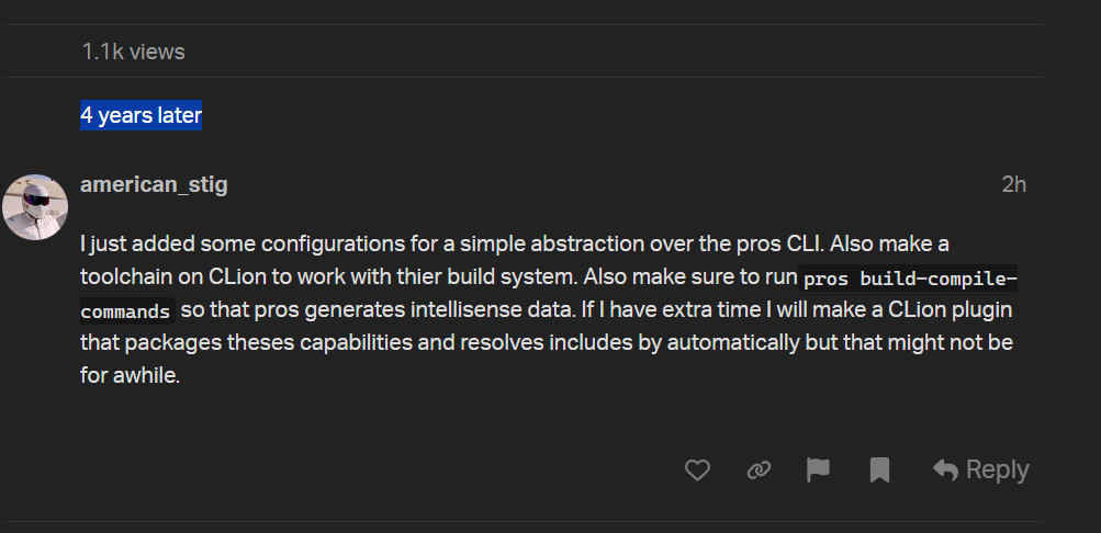

I just added some configurations for a simple abstraction over the pros CLI. Also make a toolchain on CLion to work with thier build system. Also make sure to runpros build-compile-commands so that pros generates intellisense data. If I have extra time I will make a CLion plugin that packages theses capabilities and resolves includes by automatically but that might not be for awhile.
