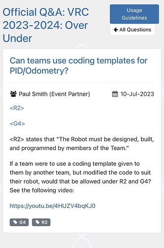

FYI, someone posted a Q&A regarding the legality of using coding templates such as the JAR template.
While this post’s purpose isn’t to argue whether they should have posted it or not, it will be interesting to see how the GDC answers it and how this impacts autonomous development for teams (both VRC & VEXU) this season.
The only thing is that I do not know how this will be enforced. While it is pretty easy to check the use of this template or okapi(i think) there are many templates on this forum and other places for chassis control, pid, odom etc. The only way that I can think of is havin a QnA with judges where they inspect your code and make you explain it? This would take a lot of time for the QnA itself as well as requiring judges who have experience in programming. Maybe this could only be enforced for excellence/design/think award candidates?
