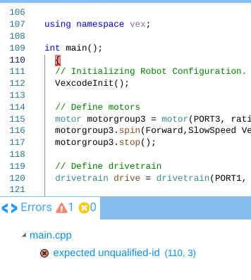

how would
I fix this issue
it says that there are 14 errors? what do I need to change them to or how do I need to fix it.

What can i do to fix things errors - #5 by cashtheflash62 You need to learn how to use semicolons.
Basically, you were telling the compiler that you were done with the main program with the semicolon, so it didn’t know what to do with a random bracket.
