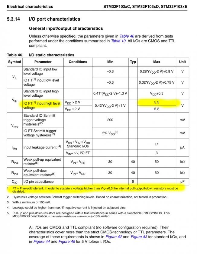

THE FOLLOWING SECTION WAS NOT ACTUALLY NECESSARY!
I mistakenly believed that the Cortex used 5v logic level and needed to be shifted to 3.3v, the Cortex does in fact use 3.3v logic level and does not need to be level shifted.
That being said, some Arduino’s DO use 5v logic level and therefore need to be shifted, so I’ve chosen to leave this section here.
