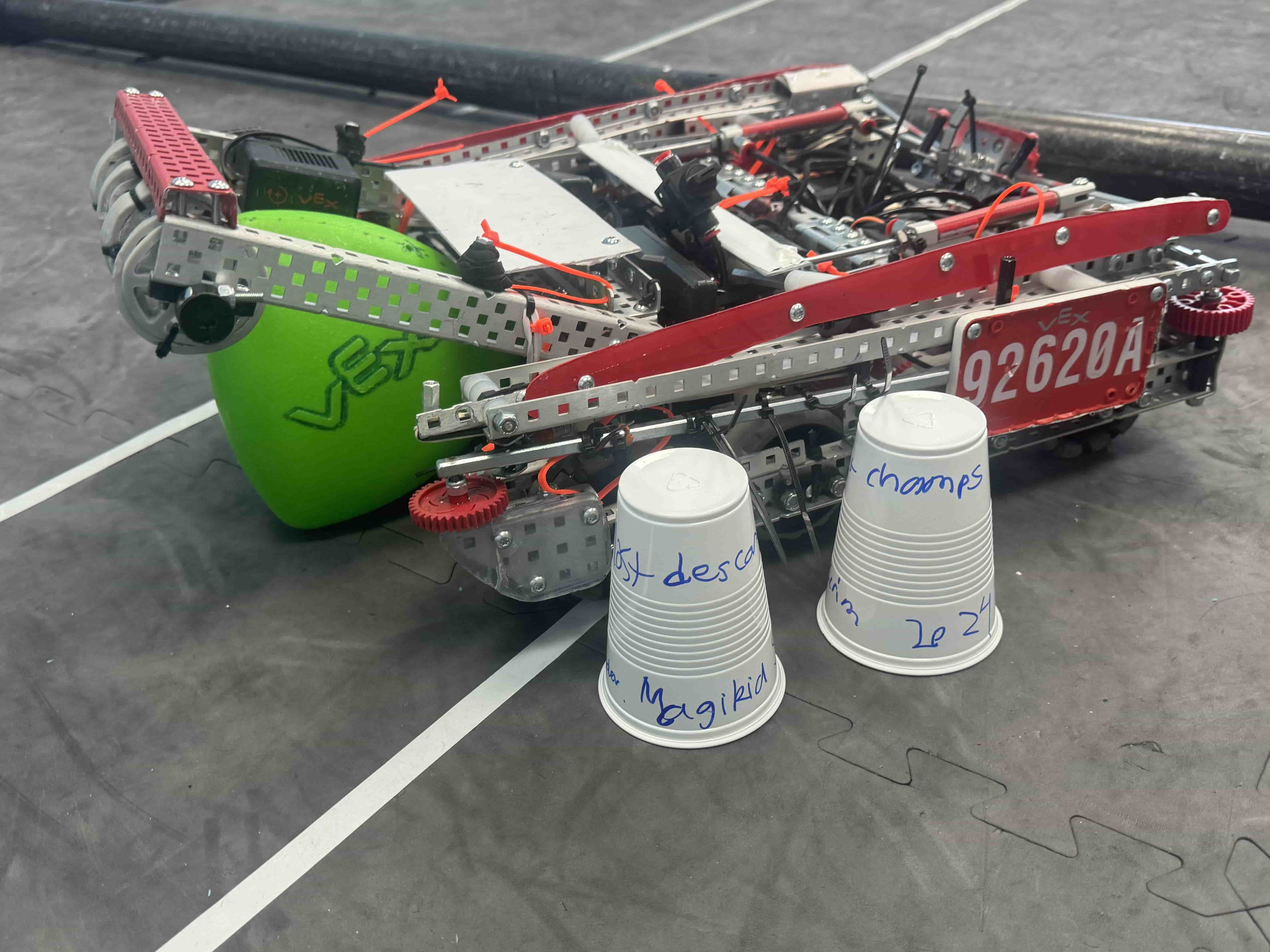

Sample Photos
In the above photo, our robot is on the left at F-Teir from last year, you can see the polycarb colored red for the hang arms, and the forward crossbrace for the intake also being red. We used white electrical tape to touch up the white.
In the above photo, you can see the intake crossbeam in much better detail. (Ignore the boxing on it, we had to flip it mid scrimmage because it was getting caught in the net while descoring, and we had no spacers.) That was simply a spray painted beam, nothing fancy. You can also see the trapdoor, which is a white spraypainted piece of polycarb, using the same process.

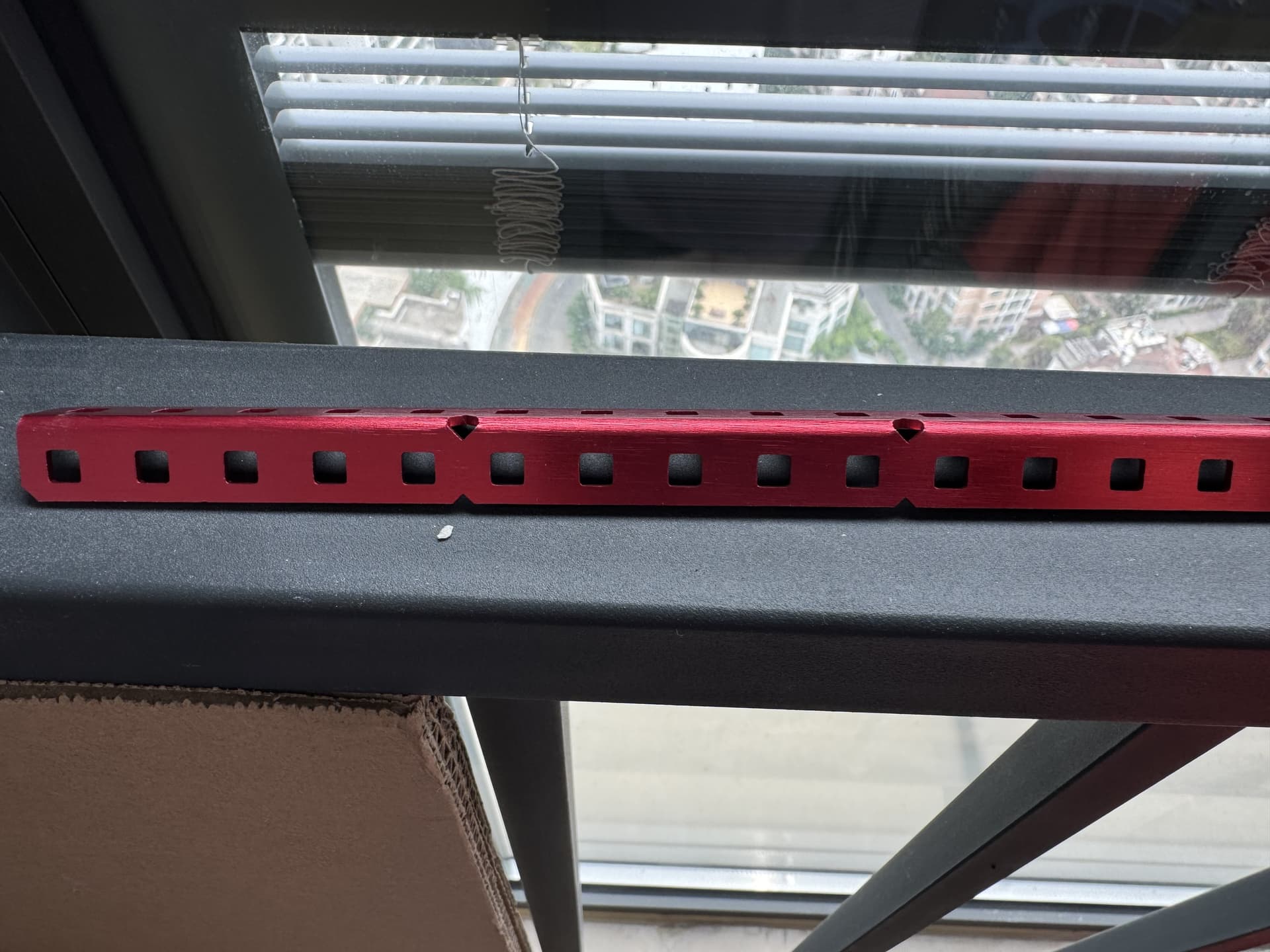

The above picture is what we are doing for Mall of America, which is red anodization. If you want anodized parts, its best to send them to a shop to do it. Its insaneley difficult to do yourself. However, the benefit is it simply makes the metal look like a a color, rather than be covered by one.
