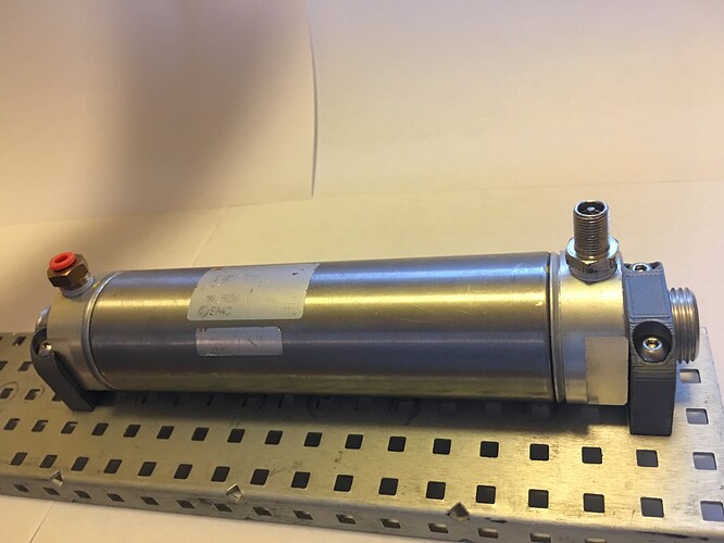

Reservoirs are quite interesting to connect to the robot. In VEXU, you can connect a reservoir with 3D printed parts:
If you are not in VEXU you can do something similar like cutting a hole in a 5-wide C-Channel to make a similar bracket. Another alternative is just zip-tying the reservoir onto your robot.
