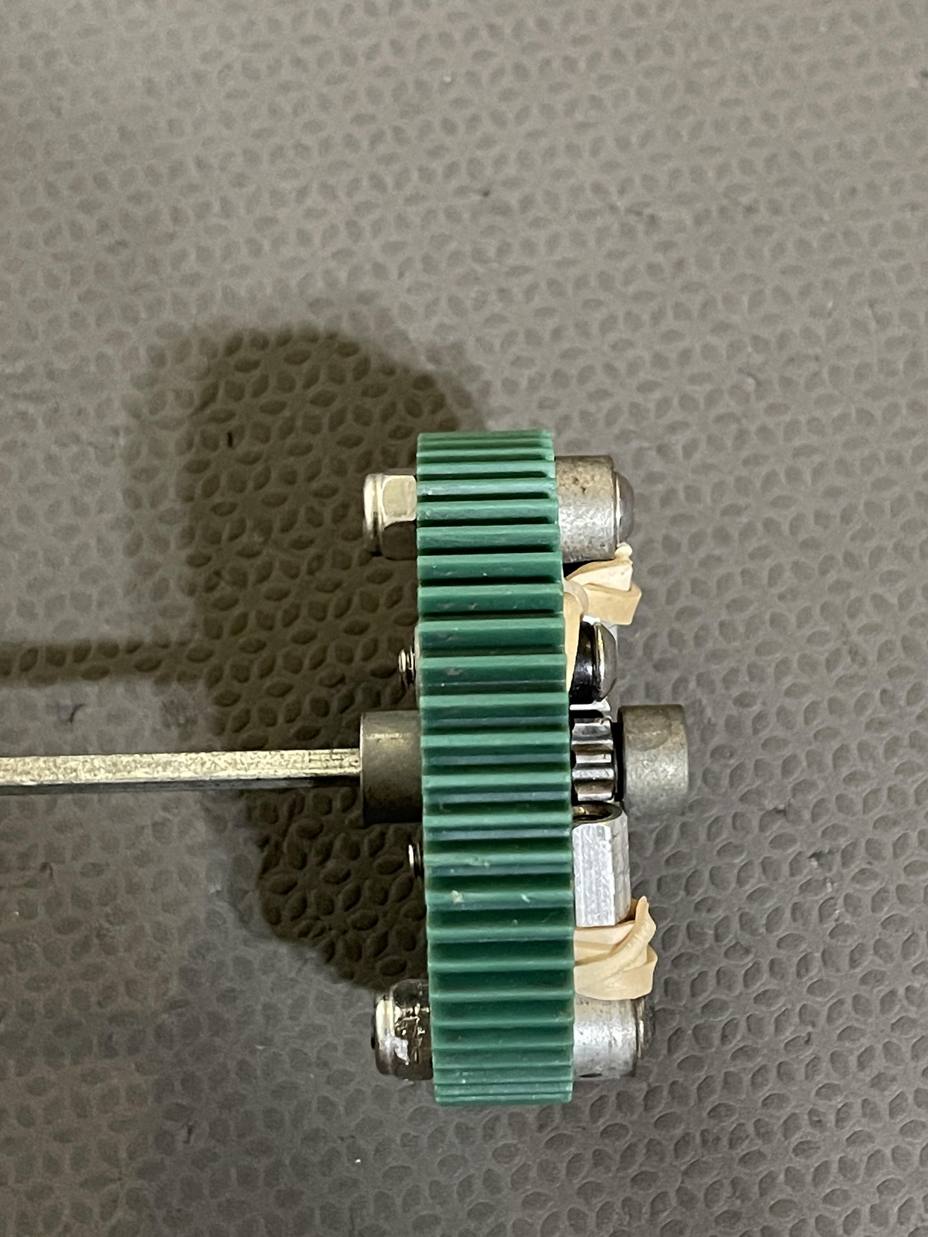

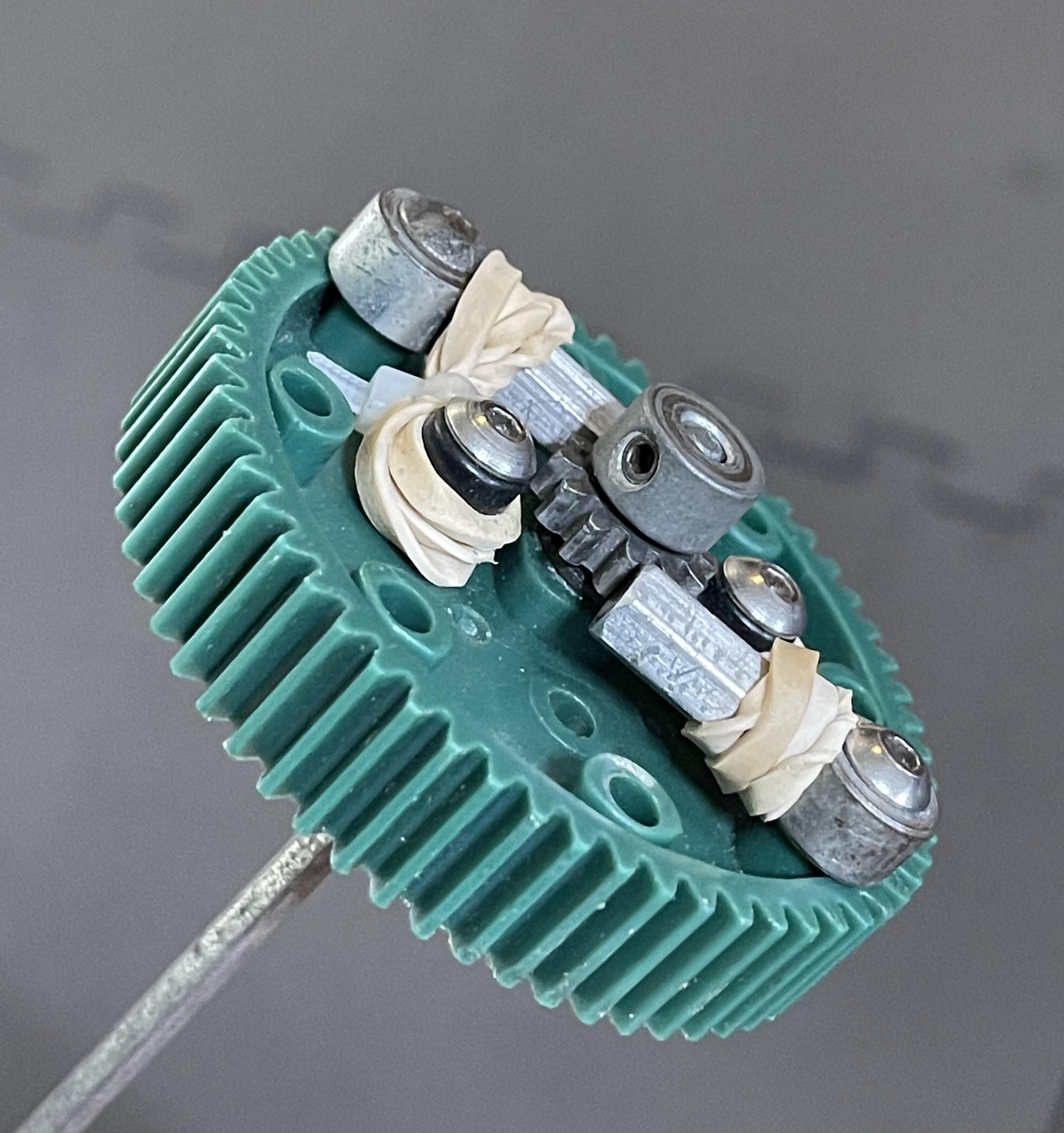

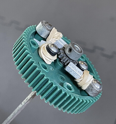

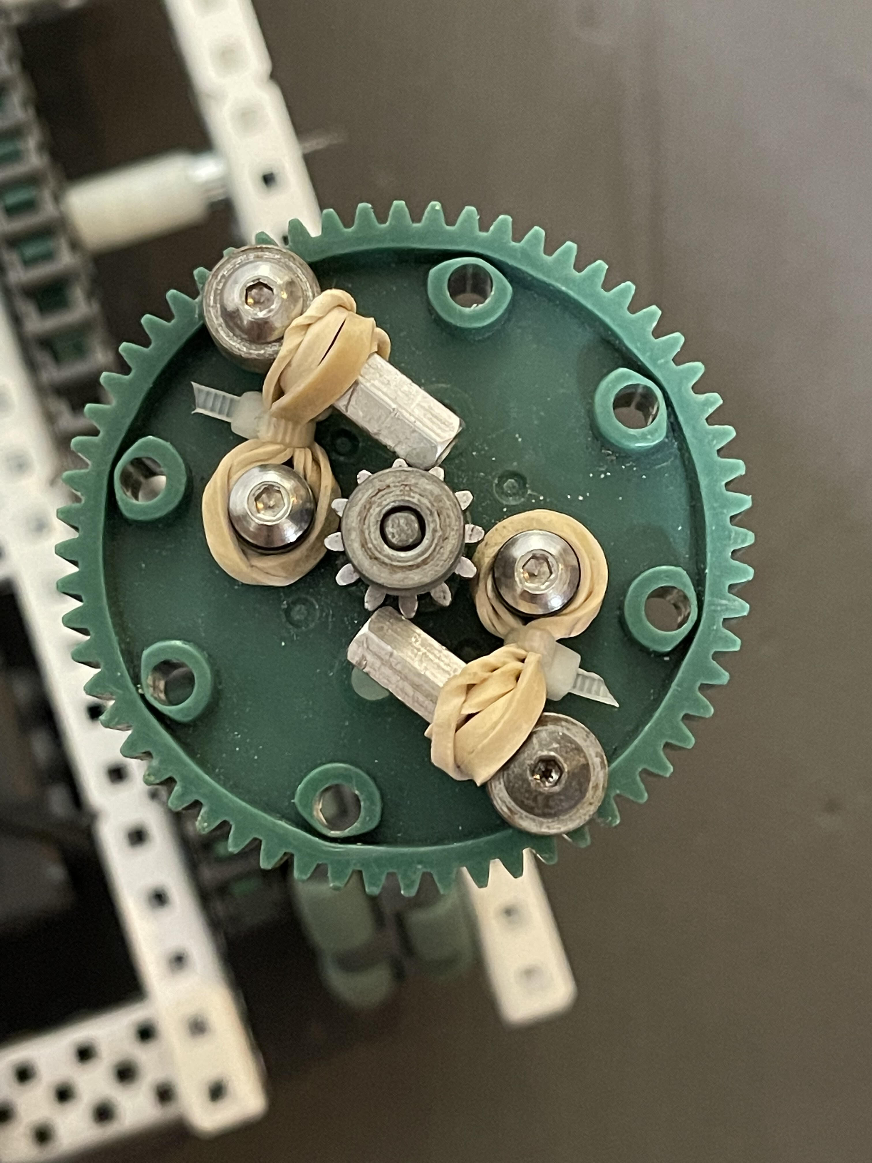

Here’s a few pictures of a compact ratchet gear our team used during Turning Point. The gear features a 60 tooth gear with a circular insert inside of it and a metal high-strength 12 tooth gear in the center that was cut thinner to make it more compact and last longer. There’s two ratchets on the gear because we used it on a flywheel, and having one ratchet caused shaking because of uneven weight distribution. However, if you’re not going to use it on a flywheel, it’s ok if you only use one ratchet.
