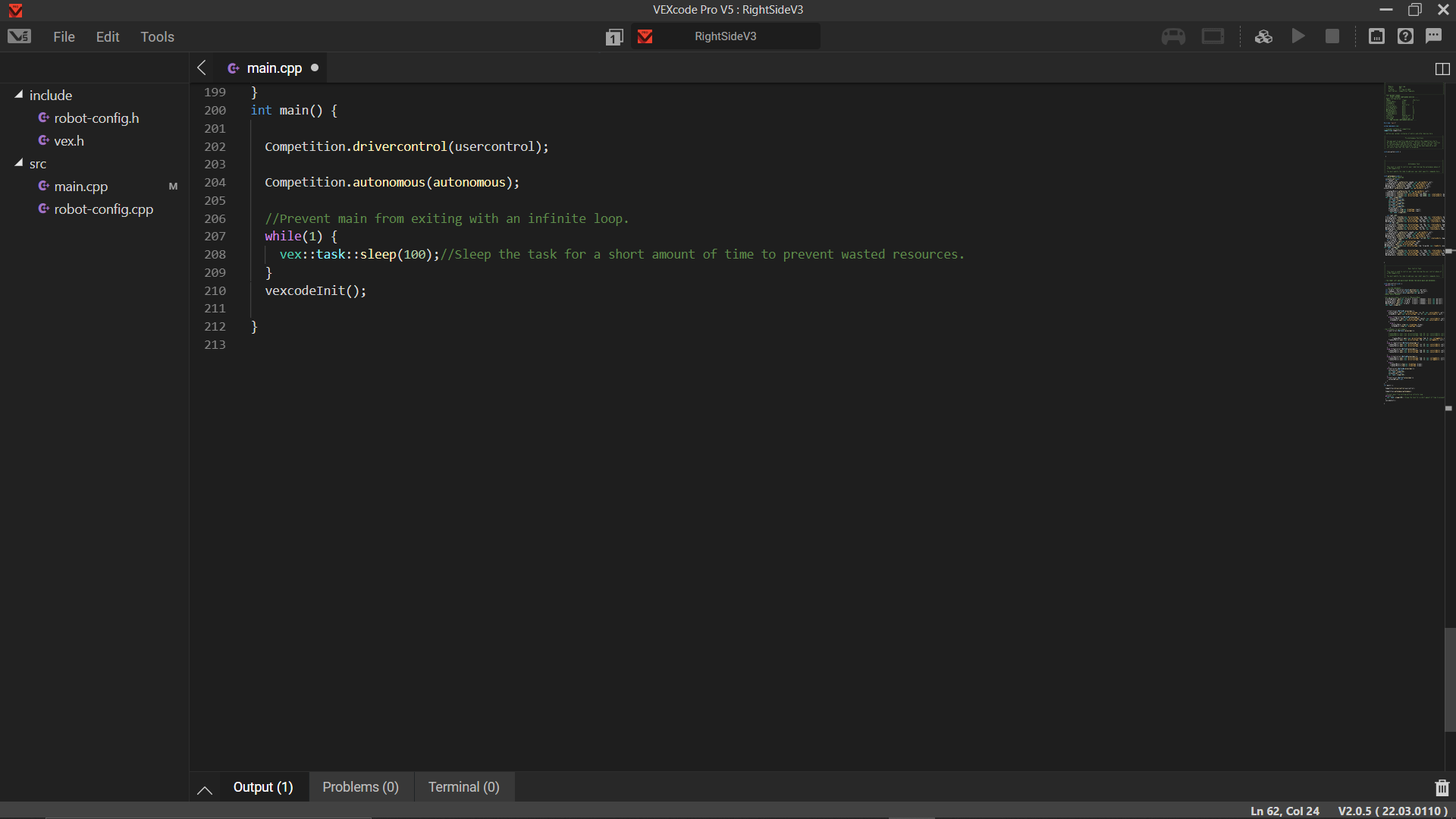

Hello,
my match autonomous is supposed to shoot two discs in to our low zone, then drive forward turn and spin the roller on the far (right) side. When making this I created a save as from our left side and just changed the autonomous so everything should have worked. It does not, it basically just drive straight over the autonomous line and loses us the auton. I have created a new template to try and make this work, I had a mentor look over the code and even tested it through our field and it worked fine. But, when we went to a competition, the robot headed straight for the other side of the field. Just thought I would ask your guy’s thoughts.
Thanks

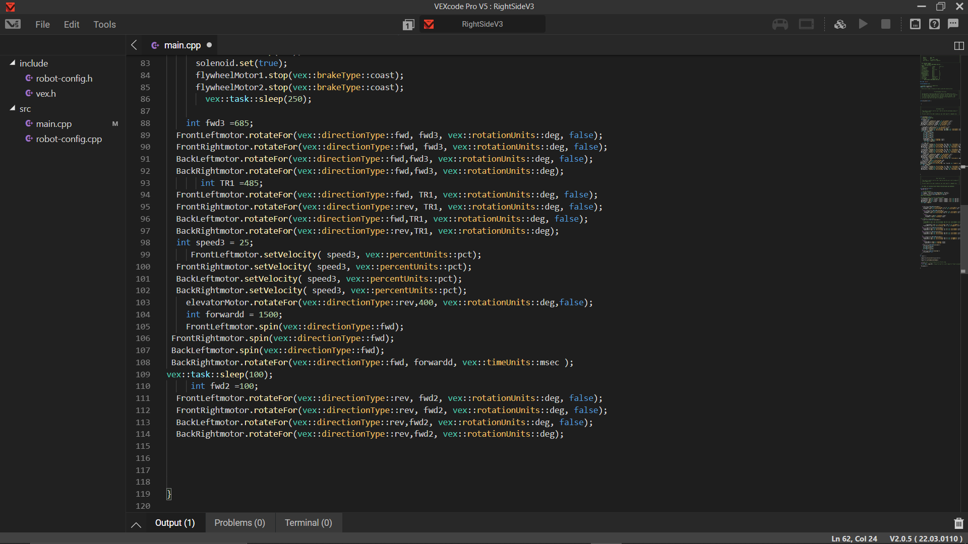

void autonomous(void) {
   //RIGHT ROLLER SHOOTING
  solenoid.set(true);
  int speed2 = 50;
     FrontLeftmotor.setVelocity( speed2, vex::percentUnits::pct);
  FrontRightmotor.setVelocity( speed2, vex::percentUnits::pct);
  BackLeftmotor.setVelocity( speed2, vex::percentUnits::pct);
  BackRightmotor.setVelocity( speed2, vex::percentUnits::pct);
elevatorMotor.setVelocity( speed2, vex::percentUnits::pct);
    flywheelMotor2.setVelocity( 40, vex::percentUnits::pct);
  flywheelMotor1.setVelocity(40, vex::percentUnits::pct);
  flywheelMotor1.rotateFor(vex::directionType::fwd,10000, vex::rotationUnits::deg, false);
  flywheelMotor2.rotateFor(vex::directionType::fwd,10000, vex::rotationUnits::deg,false);
  vex::task::sleep(3000);
       solenoid.set(false);
      vex::task::sleep(250);
      solenoid.set(true);
      vex::task::sleep(700);
      solenoid.set(true);
      flywheelMotor1.stop(vex::brakeType::coast);
      flywheelMotor2.stop(vex::brakeType::coast);
    int fwd3 =685;
  FrontLeftmotor.rotateFor(vex::directionType::fwd, fwd3, vex::rotationUnits::deg, false);
  FrontRightmotor.rotateFor(vex::directionType::fwd, fwd3, vex::rotationUnits::deg, false);
  BackLeftmotor.rotateFor(vex::directionType::fwd,fwd3, vex::rotationUnits::deg, false);
  BackRightmotor.rotateFor(vex::directionType::fwd,fwd3, vex::rotationUnits::deg);
       int TR1 =485;
  FrontLeftmotor.rotateFor(vex::directionType::fwd, TR1, vex::rotationUnits::deg, false);
  FrontRightmotor.rotateFor(vex::directionType::rev, TR1, vex::rotationUnits::deg, false);
  BackLeftmotor.rotateFor(vex::directionType::fwd,TR1, vex::rotationUnits::deg, false);
  BackRightmotor.rotateFor(vex::directionType::rev,TR1, vex::rotationUnits::deg);
  int speed3 = 25;
     FrontLeftmotor.setVelocity( speed3, vex::percentUnits::pct);
  FrontRightmotor.setVelocity( speed3, vex::percentUnits::pct);
  BackLeftmotor.setVelocity( speed3, vex::percentUnits::pct);
  BackRightmotor.setVelocity( speed3, vex::percentUnits::pct);
    elevatorMotor.rotateFor(vex::directionType::rev,400, vex::rotationUnits::deg,false);
    int forwardd = 1500;
    FrontLeftmotor.spin(vex::directionType::fwd);
 FrontRightmotor.spin(vex::directionType::fwd);
 BackLeftmotor.spin(vex::directionType::fwd);
 BackRightmotor.rotateFor(vex::directionType::fwd, forwardd, vex::timeUnits::msec );
vex::task::sleep(100);
     int fwd2 =100;
  FrontLeftmotor.rotateFor(vex::directionType::rev, fwd2, vex::rotationUnits::deg, false);
  FrontRightmotor.rotateFor(vex::directionType::rev, fwd2, vex::rotationUnits::deg, false);
  BackLeftmotor.rotateFor(vex::directionType::rev,fwd2, vex::rotationUnits::deg, false);
  BackRightmotor.rotateFor(vex::directionType::rev,fwd2, vex::rotationUnits::deg);

Not directly related to your issue but it seems like it would simplify your code and benefit you if you learned how to use functions, such as for your drive so you don’t have to keep repeating the same code.
