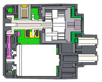

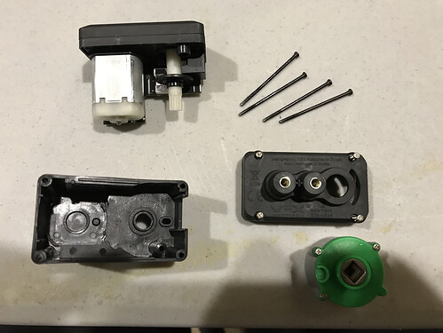

The motor inside of the case has an aluminum shell that retains the inner magnets and coils. The plastic outer casing is responsible for retaining the motor controller and gearbox cartridges –– it wouldn’t really make practical sense to make that outer entire casing out of metal. But yeah, you’re right that the v5 motor system doesn’t have the best thermal properties.
Motor Deconstruction
The vents virtually double (more or less) the surface area, allowing more thermal energy to be retained and dissipated by the motor before overheating issues occur. In other words, if the “vents” weren’t there, the motor would overheat a lot more quickly.
yup i’ve taken the motors a part a few times too, while it’s true the aluminum shell is in a good place (after all, it’s the motor you want to dissipate the heat from), it would be even better if there wasn’t an entire box of plastic surrounding it lol

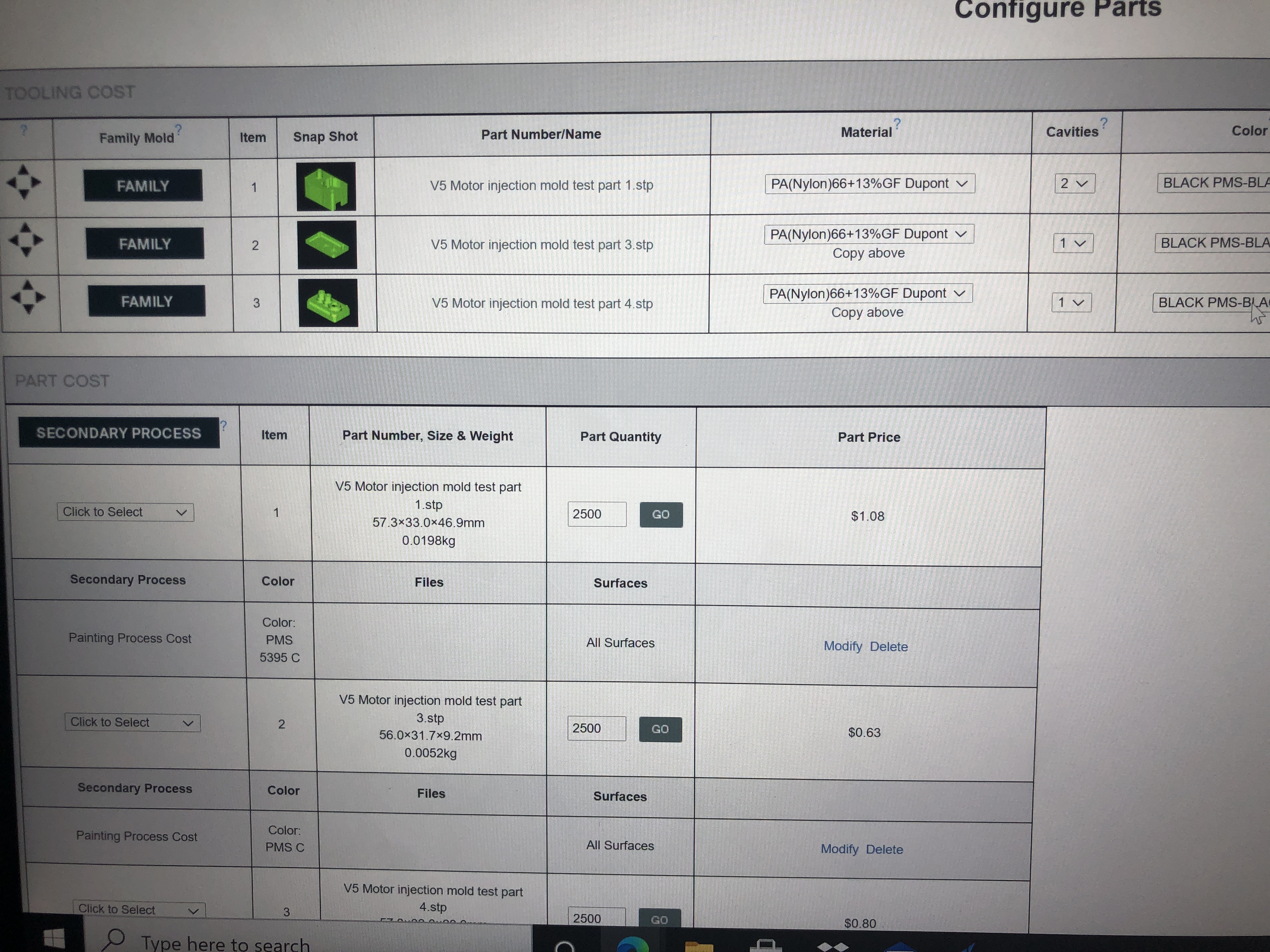

you made some good points, but i disagree on this one. most real world motors i’ve seen have metal casings, and the ones that dont almost always have fans or some other form of cooling to compensate for that higher heat retention. plastic “vents” that aren’t even open dont count. v5 motors are $40, depending on how the cases are manufactured (im assuming injection molding), i dont think it should be out of the question for them to provide us a case that doesn’t poor burn the motor alive (they do use some sensors to keep temps low, but that’s at a cost in output power)

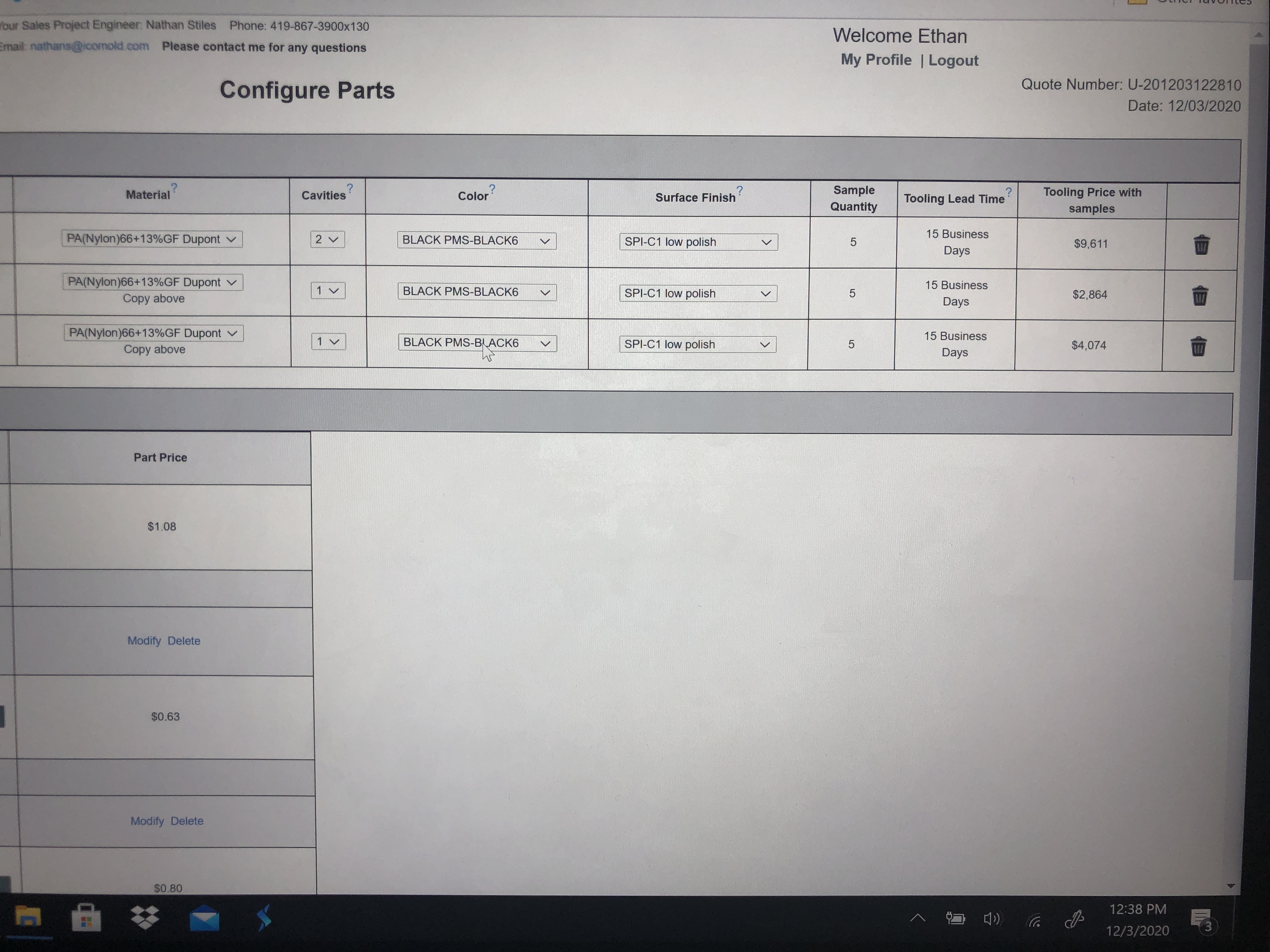

i’ve tried using some online calculators for injection molding and used the cad files vex provided, and with a part quantity of just 2500 for each of the 3 main components (there is a fourth piece but the cad file wouldn’t upload to the calculator. gonna take a wild guess and assume it’s a similar cost per part as the others), the costs per part were estimated as follows:
(also note that cost per part decreases significantly as number of parts goes up. 2500 parts was a pretty low end estimate)
while the casing probably isn’t that exact type of plastic, it’s likely still in that same ballpark of being a couple dollars for the whole case. lets be a little generous and say $6 for the 4 main injection molded components of the case itself and the black paint job and light polish. i just dont see why they cant spend a couple more dollars per part to get us a material that doesn’t cook the motor like an oven, or maybe a small fan, or even some real vents would be nice
Probably because there are other factors that you aren’t aware of. Remember, the casing doesn’t just house the motor, but also the gear cartridges, and the motor controller. Increased weight and possibly volume can increase shipping costs, and the v5 motor is already costly for most teams (also plastic already works pretty well). The question we should be trying to answer is –– is a metal motor casing actually a worthwhile investment? I don’t see any solid evidence to suggest otherwise (as in quantitatively, how much better is metal than plastic in this case). The temperatures the motors are reaching really aren’t that high in relation to how well the plastic can hold up.

By chance could you explain like what part is swapped out of the motor. I would like to in the future do this but don’t know what parts I would swap
basically you remove everything except for the mounting part of the motor.
leave off the screws that you would take out when accessing gear cartridges, and hold the motor together with really tight zipties.
but you need to make sure the zipties really are on super tight, otherwise the components of the motor could misalign which causes friction and could damage your motor.
