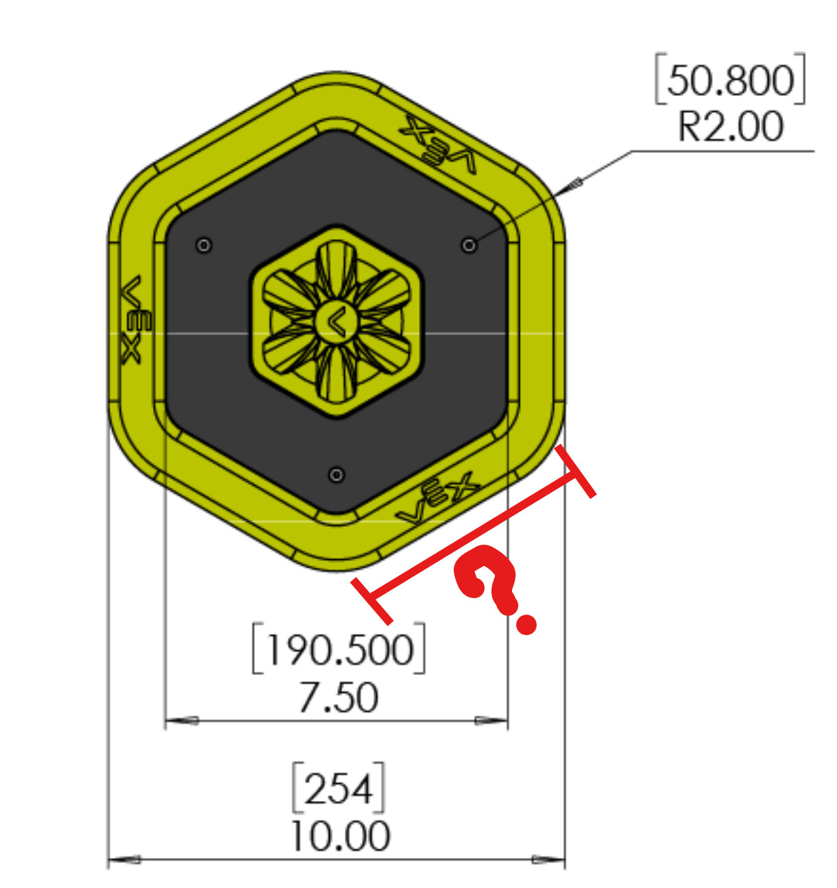

On the VEX High Stakes Game Manual, it lists most of the dimensions for the Mobile Goals, but it doesn’t give the side lengths of the Mobile Goal. Does anyone know the dimensions?

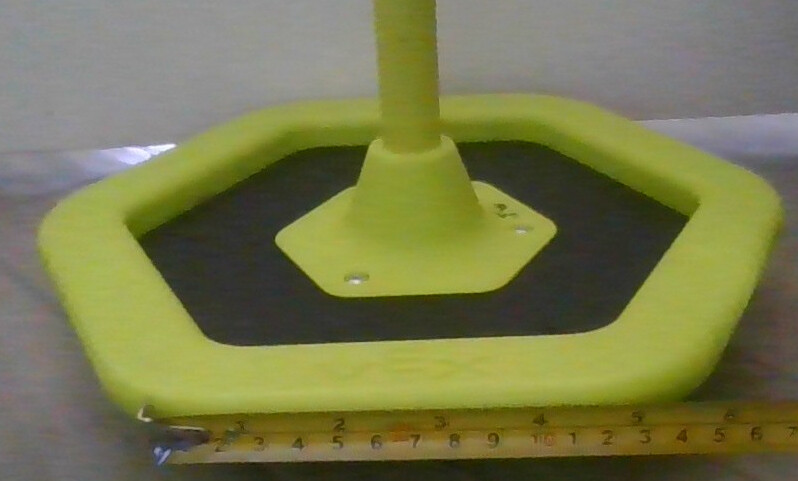

I don’t know if this will be useful to you, but I measured the goal side roughly with a measuring tape. It’s about 5 to 5 1/2 inches, or about 127 to 139.7 millimeters.
The dimensions of the side are exactly 10/sqrt(3) = 5.77350269 inches. Please note that this is from corner to corner of the goal, so Katbot’s estimate may be more accurate if you only want to not include the half of the curved edge which is included in this calculation. Remember, in the VEX V5 official mogo dimensions, it says that the width of the whole goal itself is 10 which is the side opposite to 60 degree angle. Note that the goal side is opposite to the 30 degree angle. Hope this helps!
