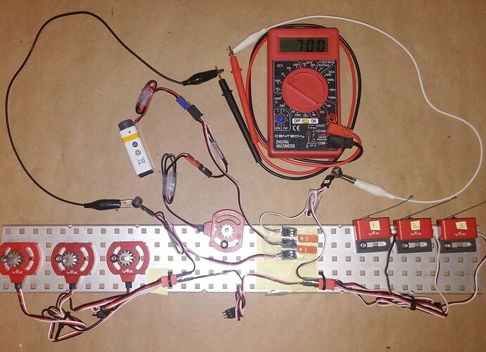

It is possible to have similar solution with only VRC legal parts. Attached is a picture of the circuit that allows to use a single analog port for reading the state of multiple limit switches. In addition to switches, you will need 4 Y-cables, 2 orange jumpers, and 4 potentiometers. If you want to add three more switches on the same port you will need 3 more Y cables and 3 more potentiometers.
The top Y-cable (that is connected to 9V battery) would be normally plugged into the Cortex or a legacy port on V5 brain. It splits into connection to a master (top) potentiometer and to the orange jumpers that connect black wire to the ground rail (Y-cable on the left) and white data wire to the output rail (Y-cable on the right). I made those rails by gently clamping metal pins of the Y-cables between metal washer and nylock thus electrically connecting all six female ports on both ends of those Y-cables. There are plastic washers under screw heads to take the bulk of the compression force and protect the pins.
Then each limit switch is connected in series with one of the potentiometers (through the bottom Y that serves as the three F-F jumper wires) and then all of those pairs are connected in parallel between ground (black) and output (white) rails.
First, I tuned top master potentiometer to provide 7v output out of 9v supply voltage, when no switches are active. Then I tuned pots on the left such that output is 5v when first switch is pressed, 4v when the second, and 3v when the third. Here is the full table:
Pressed   |   Output
none            7v
1               5v
2               4v
3               3v
1,2             3.3v
1,3             2.57v
2,3             2.28v
1,2,3           2.02v
You can see that values are getting closer when multiple switches are active, but even if you connect six of them and properly tune potentiometers there should be enough resolution in the 12-bit ADC to reliably read any combination of switches.

Here is a diagram of the contraption shown in OP for connecting three buttons / switches to a single port :
Another useful scenario would be to piggy back one or two switches to the analog sensor already connected to one of the 3-wire ports:
In this scenario you could tweak potentiometers to get two non-overlapping ranges for the analog sensor measurement: one for button being on and one for off. For example, if full analog port resolution is 12-bit with values from 0 to 4095 then you could get something like 300-1600 when button is pressed and 2600-3700 when it is not.
I used screw method to tie Y-cable wires into the common rails because it is easier to visualize how they all would be electrically connected. It is true that you could damage the pins if not careful. Lucky to us there is a much simpler method that needs no screws and is guaranteed to pass the inspection:
Notice how Y-cable connectors are plugged back into themselves shifted by one position. Wires of each color align with wires of the adjacent color therefore electrically connecting all of them together.
