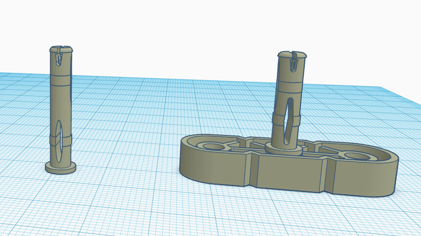

Hi, my friend and I created these 2 tinkercad designs to 3D print for our classroom and want to get some feedback. On the left is a x4 capped connector made one unit longer than the usual x3 capped connector pin. On the right is a x3 capped connector pin in the center of a 1x3 beam, this is so you can add connector pins on either side of the beam for extra support.
Just remember that robot rule <R6> part h does not allow 3D printed parts to be used in competition.
I don’t think I understand the connector in the middle of the 1x3 beam, is it a 1x3 connector? If so that could be interesting.
On the other hand that capped 4 pin (0x4) could be a bear to get apart. I could see a builder sticking the cap deep inside and needing to rip layers off to get it out.
Still think my yet to be made connection is the standoff extension with a 2x pin instead of the current 1x pin.
Nice CAD work, keep it up!
