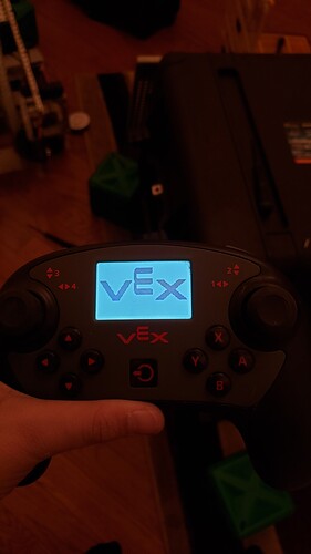

Hello all. I tried to turn on my controller screen, and it froze here. Does anyone have ideas to what’s going on? I have left it a few hours and nada. Thanks!
Could need a force reset. Unscrew the back and pop the battery out maybe? Caution: actions suggested above might lead to shock, causing bodily harm and/or death
stick one of your shoelace aglets into the hole in the back, it resets it.
terrible idea, it has a reset button in the back. don’t go tinkering around inside your controller please.
there is a small hole on the back of the controller, just hold the button inside of it down until the controller shuts off
I did have a danger warning and a question mark
Welp, I guess I learned a new slang word.
Yea, grab a screwdriver or something narrow enough to stick inside of the reset port (It looks very much like a place a screw would go, but it isn’t and it contains a rubber button) and press the little button. If pressing the button doesn’t work you probably may need to wait until the controller dies after some time and recharge the controller. If nothing works then contact [email protected] about seeing if you can get a replacement.

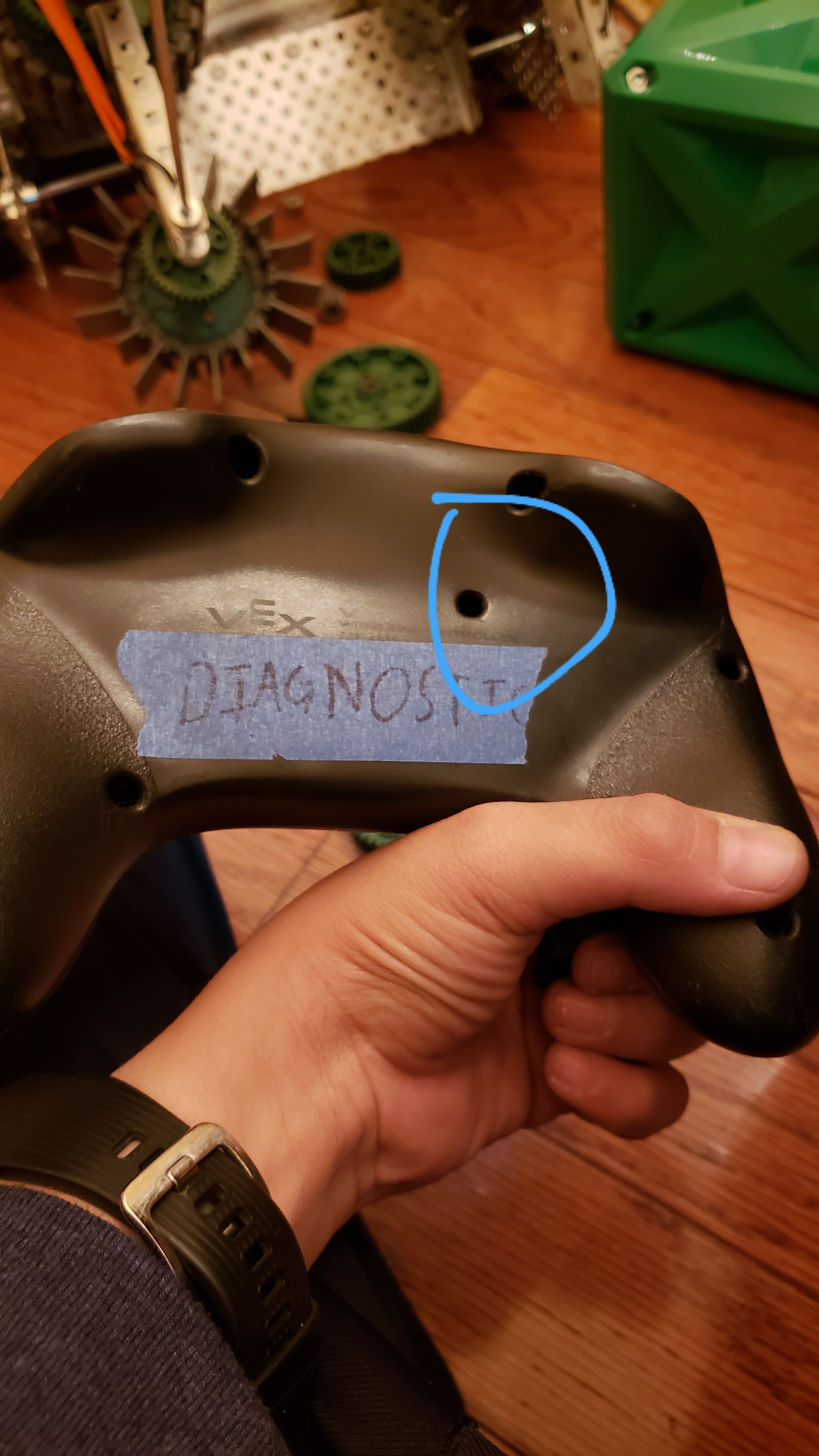

This one?
That is the reset port, so yes that is correct. Stick a screwdriver or something narroe through that to completely restart the controller.
