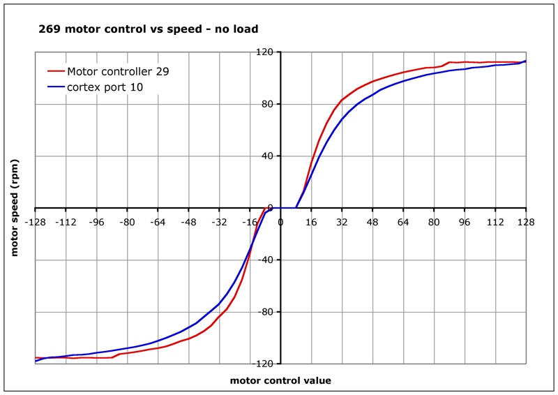

I realized that I did not actually post a graph of the difference between unloaded motor speed for a cortex 2 wire port vs a servo port, so here it is, same motor tested on port 9 using a MC29 and then port 10.
