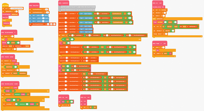

Could you do Odometry in Vexcode V5 Blocks
Just an thought, Can you make do Odometry code in vex code V5 Blocks. I know it’s possible in Vexcode V5 Pro. But could you do make an Odometry Code in Vexcode V5 Blocks? How would that be possible?

Actually, it is possible to track your robot’s motion via odometry and program it in blocks. But block’s built-in refresh rate makes it not optimal for use with motion planning algorithms.

I replicated this code and it does not work. It displays a message saying “error generating code” :frowning:

Correct me if I am wrong, but isn’t all of the stuff on the left useless? I never saw factorials in the rest of the code.
No, it’s only the blocks code generator that adds the additional wait, it’s to stop issues caused by loops that have no wait (or any other API calls) at all. When using C++ you have to deal with that on your own, python is a whole other story.
I think the OP was using some more complicated math (Taylor Series) for trig functions (I’m not sure if they knew there were trig functions in blocks yet).
