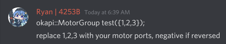

I need help making a motor group in pros. I also don’t understand if I can or cannot make a Drivetrain in my program
OkapiLib A PROS library for programming VEX robots
https://okapilib.github.io/OkapiLib/md_docs_tutorials_index.html

What @Ryan_4253B said is correct for motor group but if you’re doing auton drivetrain you probably need a chassis
https://okapilib.github.io/OkapiLib/md_docs_tutorials_walkthrough_chassisControllerBuilder.html
