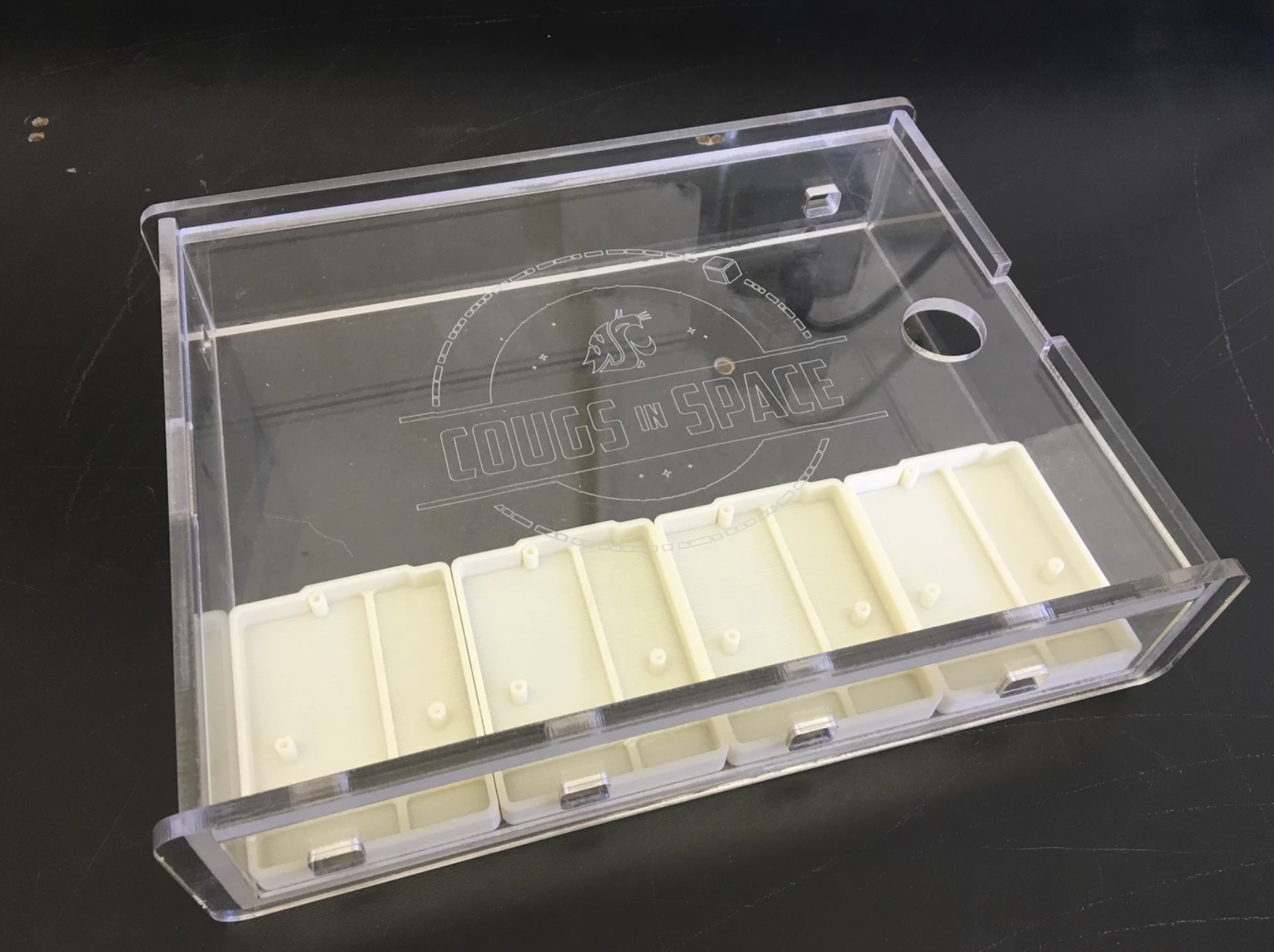

- I created custom made portable testing containers from acrylic using a laser cutter for the computing systems team to test and troubleshoot electrical components that would eventually go inside the CubeSat. I designed the containers to have locking lids using only the acrylic panels and it worked great.

Electrical Component Testing Container with snap-lid (empty)
