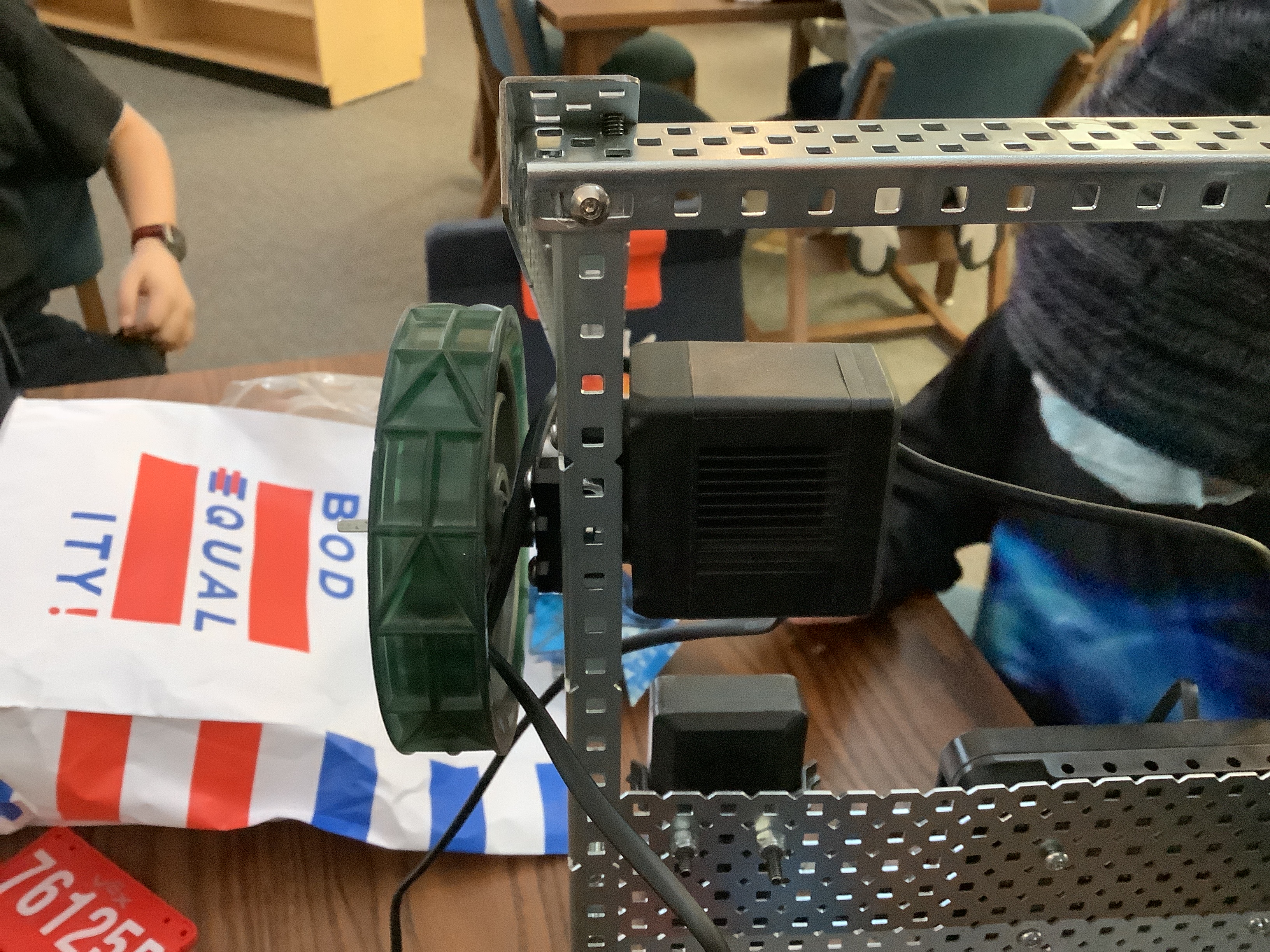

cantilevered screws
motors not aligned
posted on cursed images lol
In addition to post above
wires not managed
wires caught in wheel
cantilevered wheels
use of the steel rail
use of flat sheets as support beams
1 battery clip
no radio
not square
motors not plugged in
motors not plugged into closest port/or adjacent ports.
unplugging battery cable from brain blocked by battery
axles too long
plates not attached on both sides
screws too long
  1. One motor is on backwards
  2. Plates
  3. Wheels only supported on one side

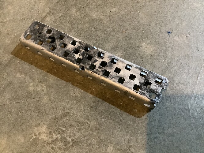

Part that I found in a bin.
Yes, that is grease. No, I don’t know how it got there.

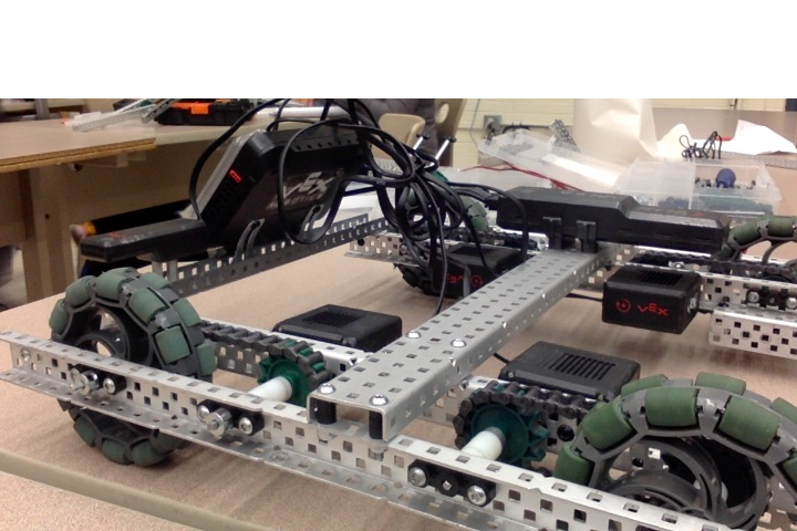

lads… the gusset brain.
Not a bad solution on two fronts - brain is not being used directly as a bumper, and gusset being weaker metal structure will absorb energy from impact which in past caused white screen of death.
Not sure why chain is being used in this case to drive wheels… but could be a case of future planning for rear mechanism when brain moved from current placement.
there are worse things in life,
if you want the advantage of that but without the cursedness plop a brain on schock absorbers
