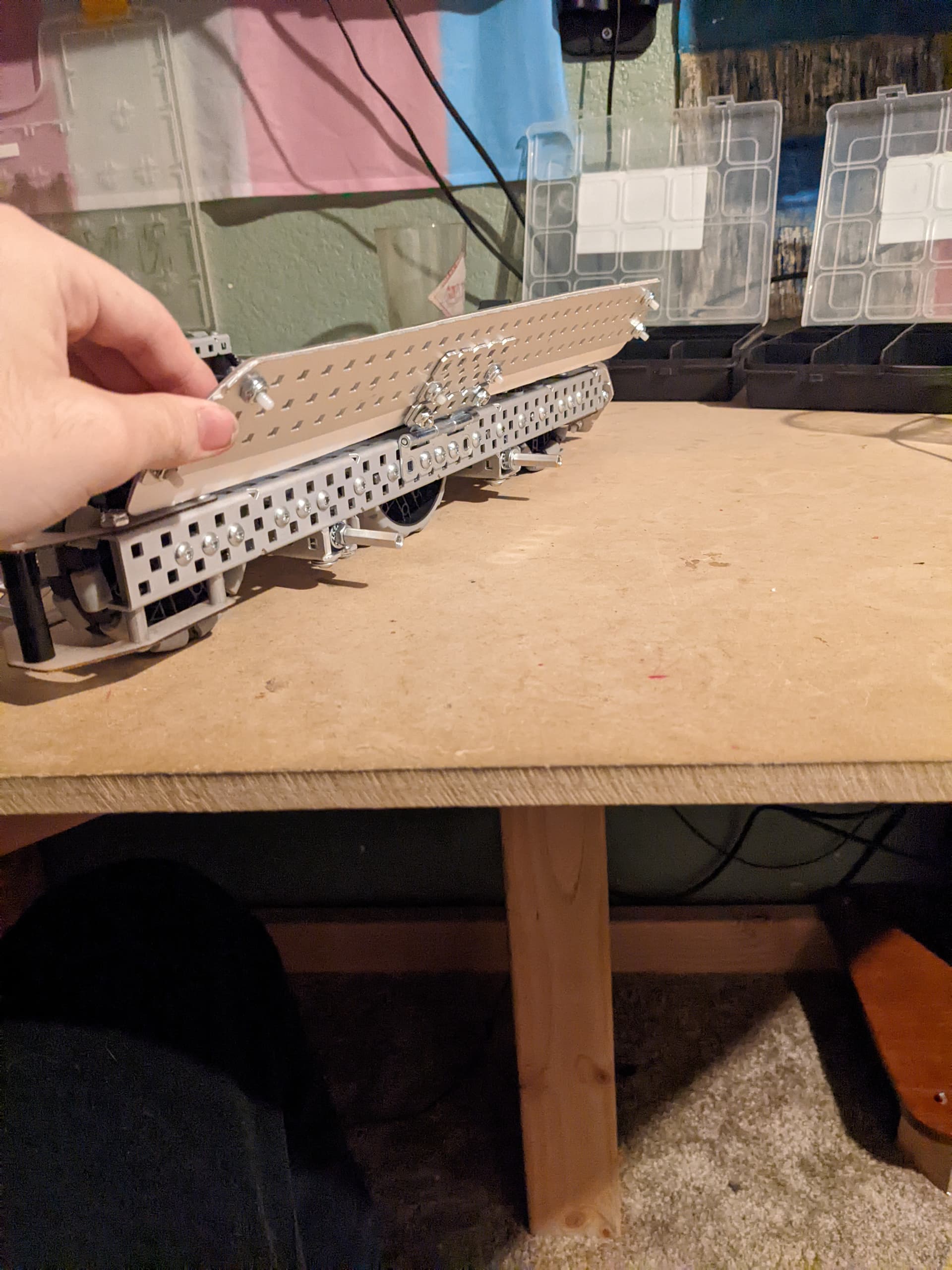

what are you gonna dq me for? having goofy aah skirts?
If the “goofy aah skirts” are non-functional decorations then mounting them using nylon screws may be allowed, but as an inspector I’d want to see a ruling on it. If the skirts are functional, even though they are very pretty and and add an awesome ascetic to the robot, the nylon screws are a no go. I’d ask that you either replace the screws or remove then completely.
But you keep tilting at that wind mill Don!
One could easily assume the screws have function, as they are being used to secure plastic pieces to VEX metal (thereby circumventing the “non-shattering plastic” rules by making the pieces a “non-functional” decoration). As inspector I’d not pass your team by virtue of < R26>, < R3>, < R11> and < R12>.
This is b/c the screws are not back by any legal material that provide same function. Simply put the nylon screws are used to hold 2 pieces together, and the legal nylocks are there to tighten them in place. Also if you remove screws the functionality of robot would change.
There are metal plates mounted with steel screws that act functionally as the skirt. There is then a layer of posterboard and a layer of plastic over the metal, attached to the metal with nylon screws. This is the very definition of “backed by a legal material”
What about the screws? They serve function, are not backed by a legal material with the same function, and if removed would “impact the performance of the robot”. Sure the entire “skirts” are non-functional, but surely this does not protect individual parts from being under scrutiny of < R12>, right?
How? The nice looking skirts will fall off, but those didn’t do anything anyways, as they were non-functional decor.
you can’t argue that part of non functional decoration is “functional” in that it keeps itself from falling apart. by that logic the adhesive on a sticker would be “functional” because without it the sticker would fall off.
Maybe, maybe not
You could just use steel screws and nylon nuts. Those are still legal, and you’d probably save the same amount of weight.
Of course, I don’t think that this is really about saving weight anymore.

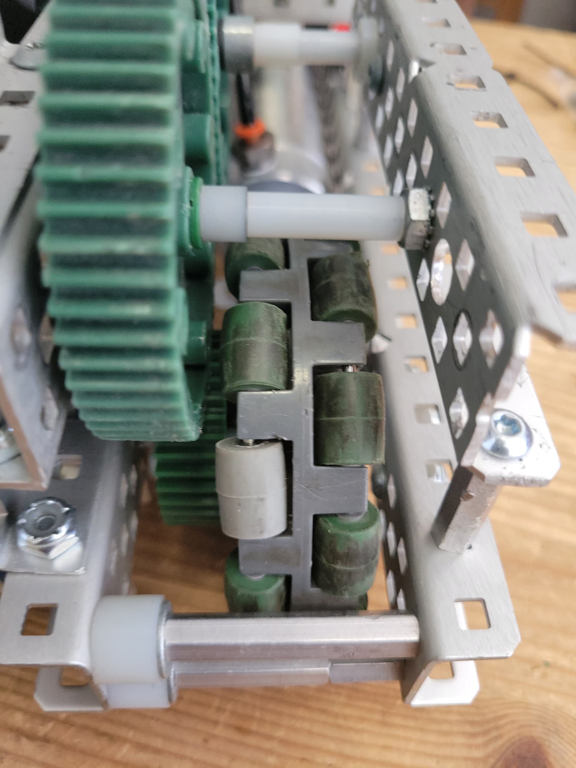

Ouch, bad building, I see

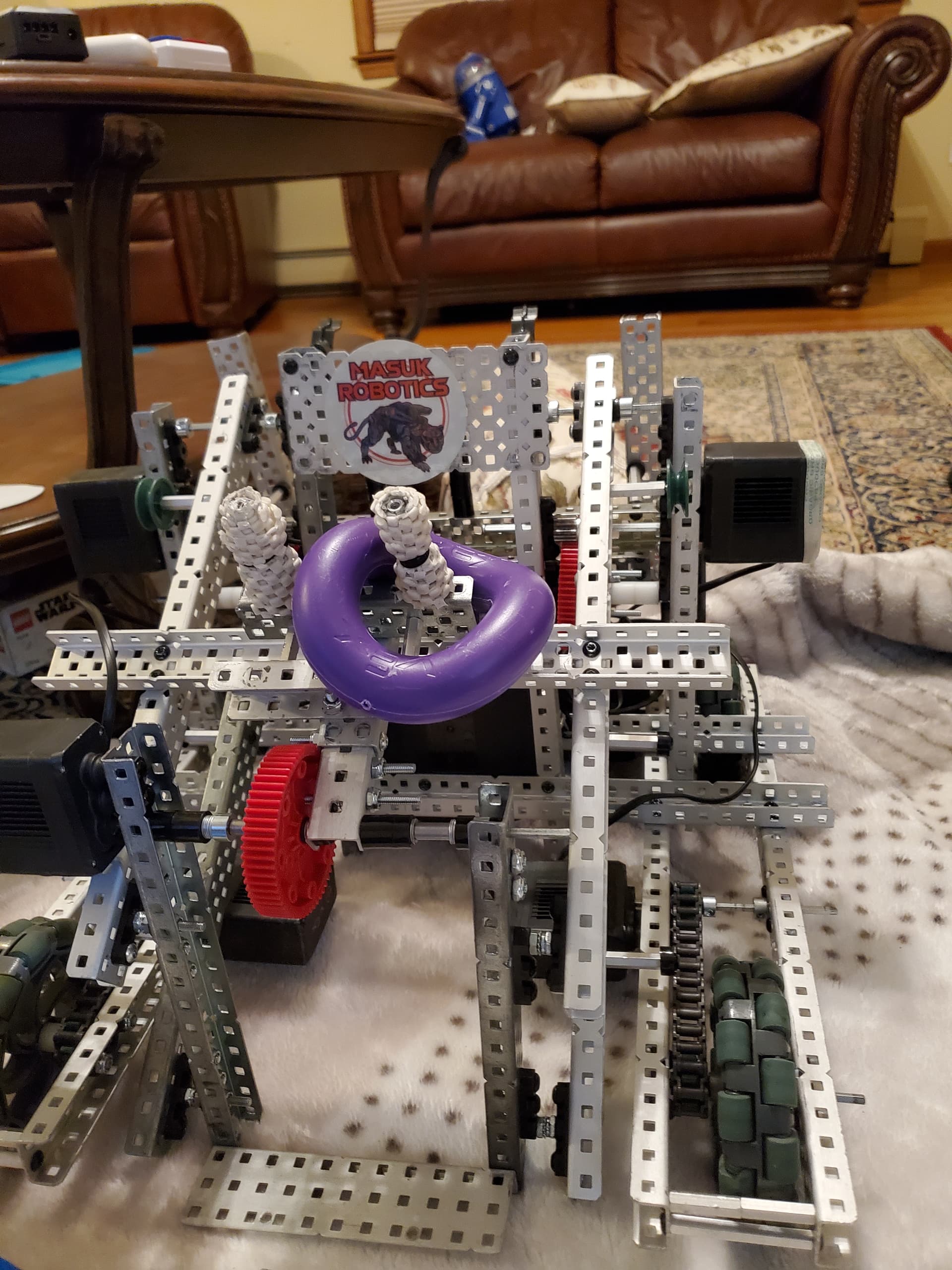

Do you care to showcase your own, better construction?
I know its old but its all I have
And this is better building how?

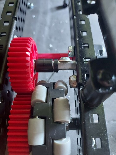

Its better than using a screw as a drive shaft.
A screw joint? They tend to be more stable than an axle, it’s a perfectly vaild build strategy.
Its not even put in the right place though
