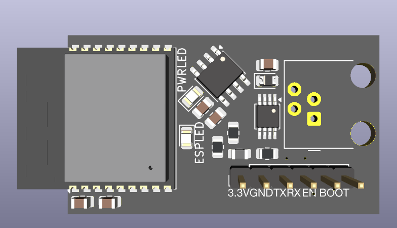

When i get to my computer i can send more information but my plan wouldn’t be using the usb connector. I designed a custom pcb that connects to the standard RJ9 and uses the Max3485 chip to connect the esp32 c3 wroom allowing communication between the brain and wifi. Allows me to run a wifi server and bluetooth connection

As a mild tip, maybe try the thvd1450 over the max3485. It’s a much more static resistant chip that Vex has upgraded to using in their newer revision on the brain. I’d also suggest looking into TVS diodes if you haven’t, as they can also prevent static issues, which are prevalent with vex robots.
This is the pcb I designed with the MAX3485 chip (45 degree angle next to esp) and a 3.3V regulator chip (TPS62160DGK), the esp is an esp32 c3 wroom. There is a 6 pin connector for a usb programming board to attach and program the board before being put into its case. The final size of the module is the same dimensions as a standard v5 radio but if you chop off the extra antenna long bit. It’ll have the standard 2 8-32 threaded inserts and a plastic nub to align to vex holes. Since I’m going to 3d print the case with standard Ender 3 pros (upgraded) the leds won’t be visible and are there for testing purposes. One LED is on the output of the 3.3V regulator (PWRLED) and the ESPLED is connected to a GPIO so I can set it in the program. Planning on just using it to show when it’s connected to wifi.

This is my first ever PCB design and I may have made mistakes or it might not be the most optimized thing in the world. I guess we will see if it works when it gets to my house.
