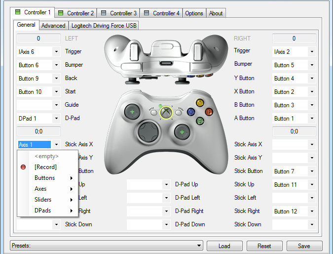

The first problem is something solveable, all PROS would need is a proper HAL (hardware abstraction layer), what this would do is make the dependency on the VEX SDK layer optional. You could have an alternative dummy motor functions that just mimic the pros api but do nothing/return 0 as is reasonable. The dummy implementations of VEX functionality could even call any generic usb controller or emulate it as necessary if people wished.
With this modification(to PROS) you would be able to take any PROS program and compile it and run on your computer with 0 modifications.
