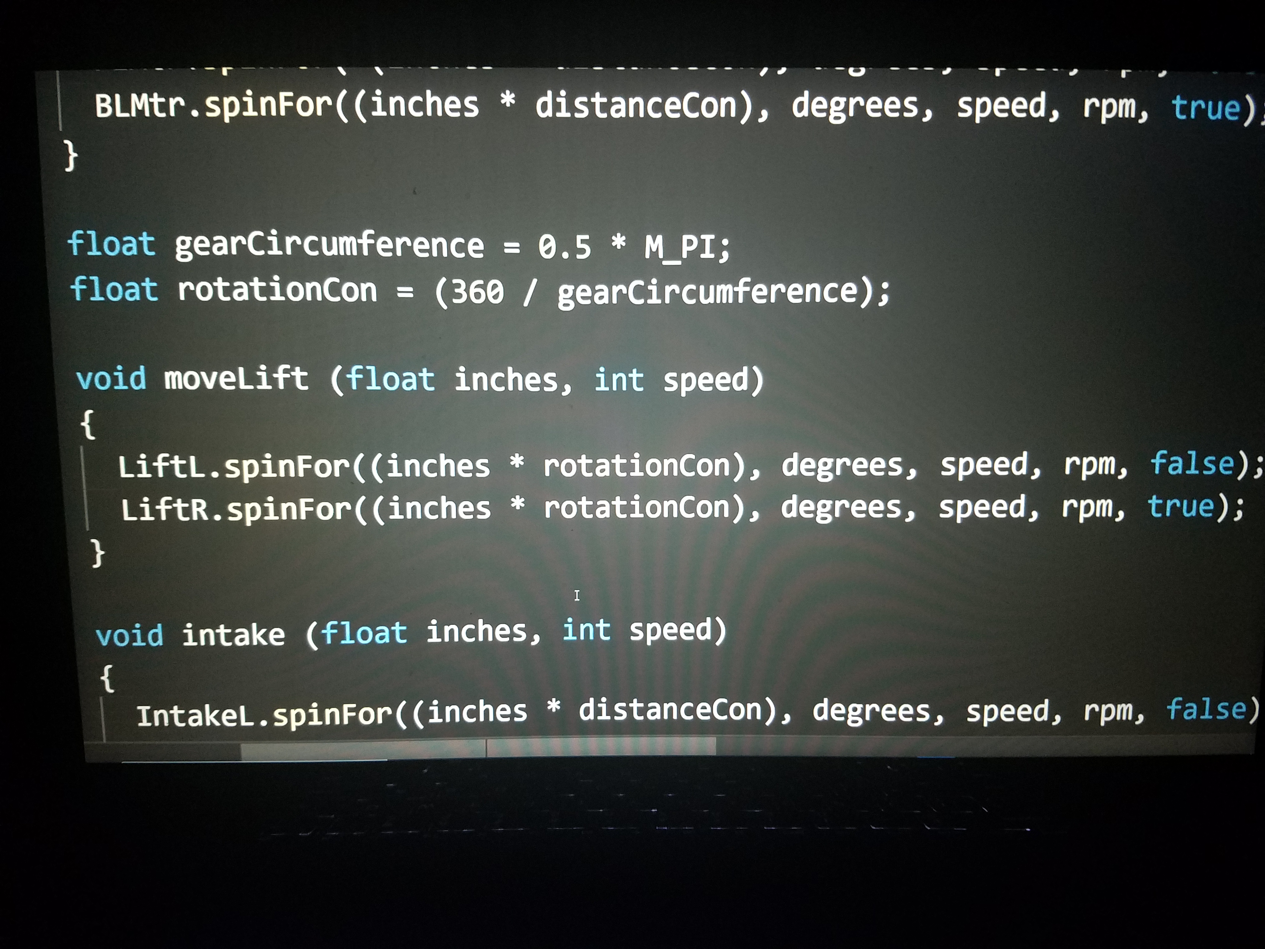

I want to convert the degrees that the motor reads into degrees in terms of arm movement
If that’s the case, what @Aditya_Narayanan said still applies. But you’d simply use the gear reduction to calculate the angular displacement (disregard the translational calculation that deals with arc length).
So, essentially, say the motor returns a value of 360 degrees, and you have a 1:7 reduction. You’d simply multiply the motor output by the reduction: 360 * (1/7). Calculating the reduction is simply a matter of finding the input gear and dividing it by the output gear. Compound reductions are a bit more complicated, but the same concept applies. You’d just multiply a chain of ratios to get the end reduction.

So since I have a motor on a 12 tooth gear, and there is an 84 tooth gear next to it, does that make the gear ratio 1:7 or 7:1?
7:1 –– 84:12 reduces to 7:1. It is output gear/input gear. Sorry, I made a mistake in the previous statement, this is what I meant to say. So for every 7 rotations of the driven gear (connected to the motor), the output gear will turn 1 time.

Would my code be like that or what do I need to change
For the moveLift and what is above it
Two things, post your code in text format on the forum next time so I can point out specific things. When doing so, press on the “pre-formatted text” icon above the text bar.
.spinFor(double rotation, rotationUnits units, double velocity, velocityUnits units_v, bool waitForCompletion=true) These are the parameters for the function you are using. Specifically, the first paramter is what I think you’re confusing. Why do you want to measure the arc length the arm travels? You’d have to factor in the length of the arm as well because that is technically the radius. Rather, you should be trying to calculate the angular displacement of the arm.
You’d do that by setting the first parameter in .spinFor to inches*gearReduction. Before you do that, you instantiate a new variable,gearReduction and initialize it to = 1/7.
Now your code should look a little something like:
void moveLift(float degrees, int speed){
      .spinFor(degrees*gearReduction, ...)
If you were wanting to use the moveLift function to command your lift based on the vertical distance it travels (ex. from a height of 0 inches to 10 inches), this method is going to give you some error. This is because the vertical change in height is not the same as the length of the arc traced out by the arm. Furthermore, if you were wanting to use this function in an autonomous routine, the fact that there is going to be this error is going to make things hard to write out, as the error is not directly proportional to the vertical distance (you can’t correct for it by multiplying by a constant).
