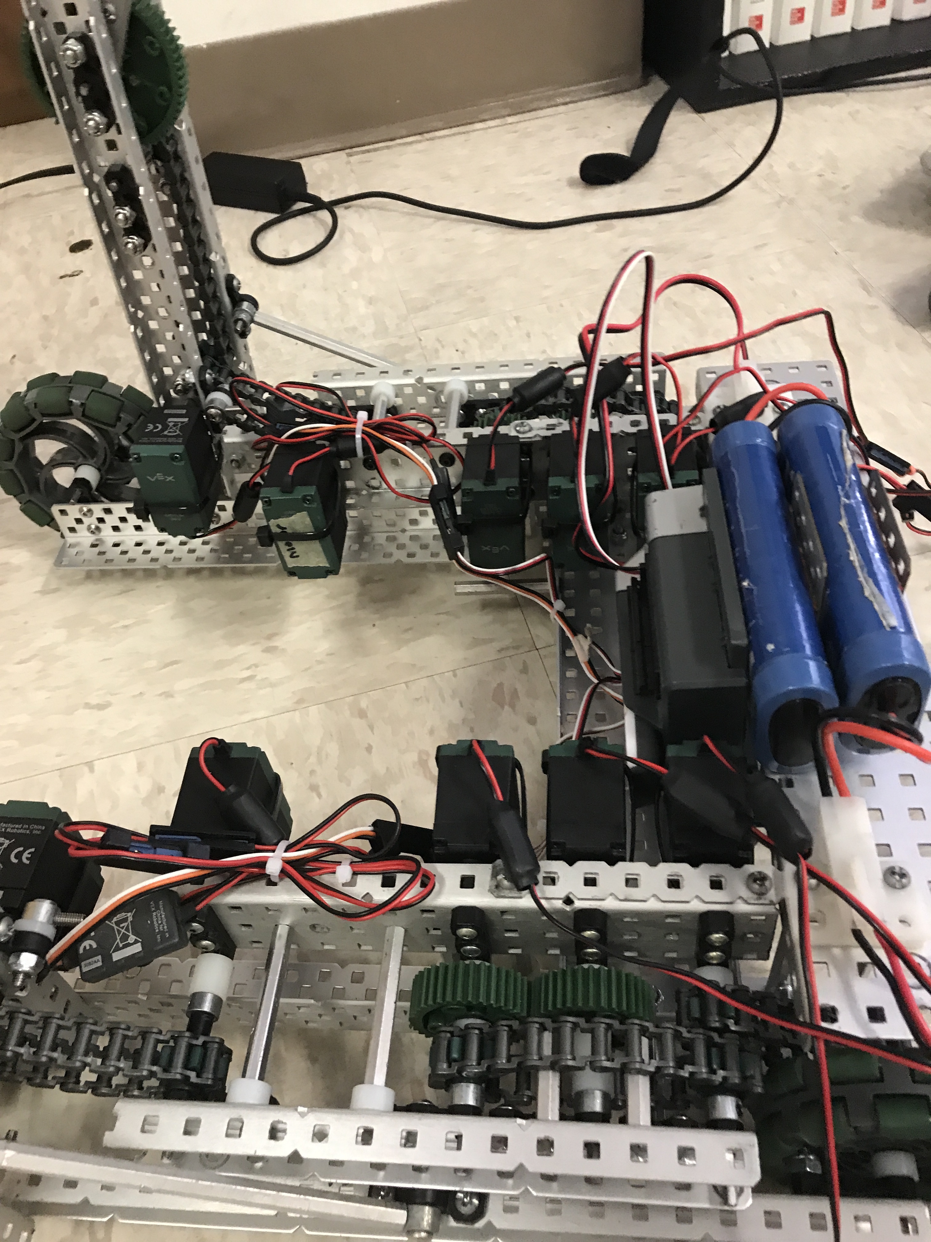

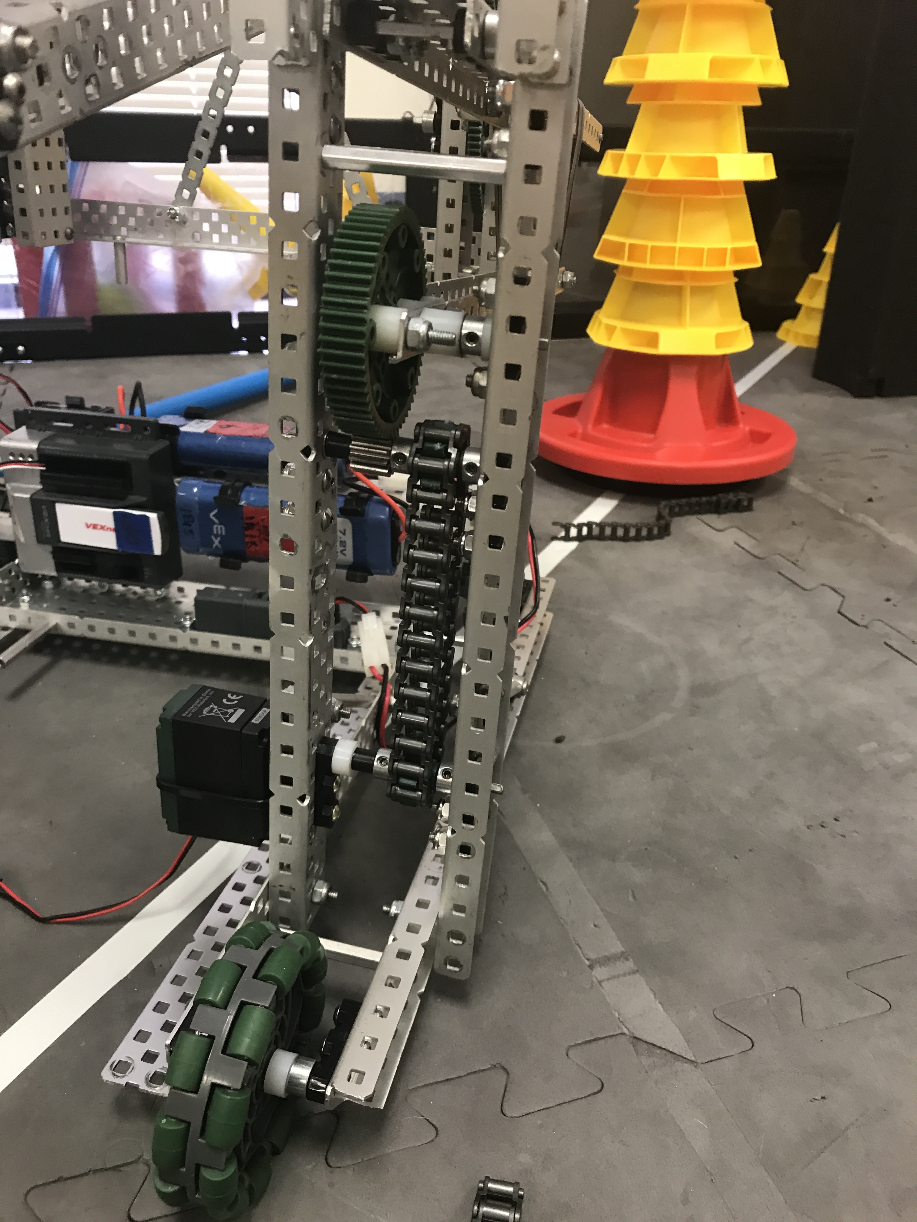

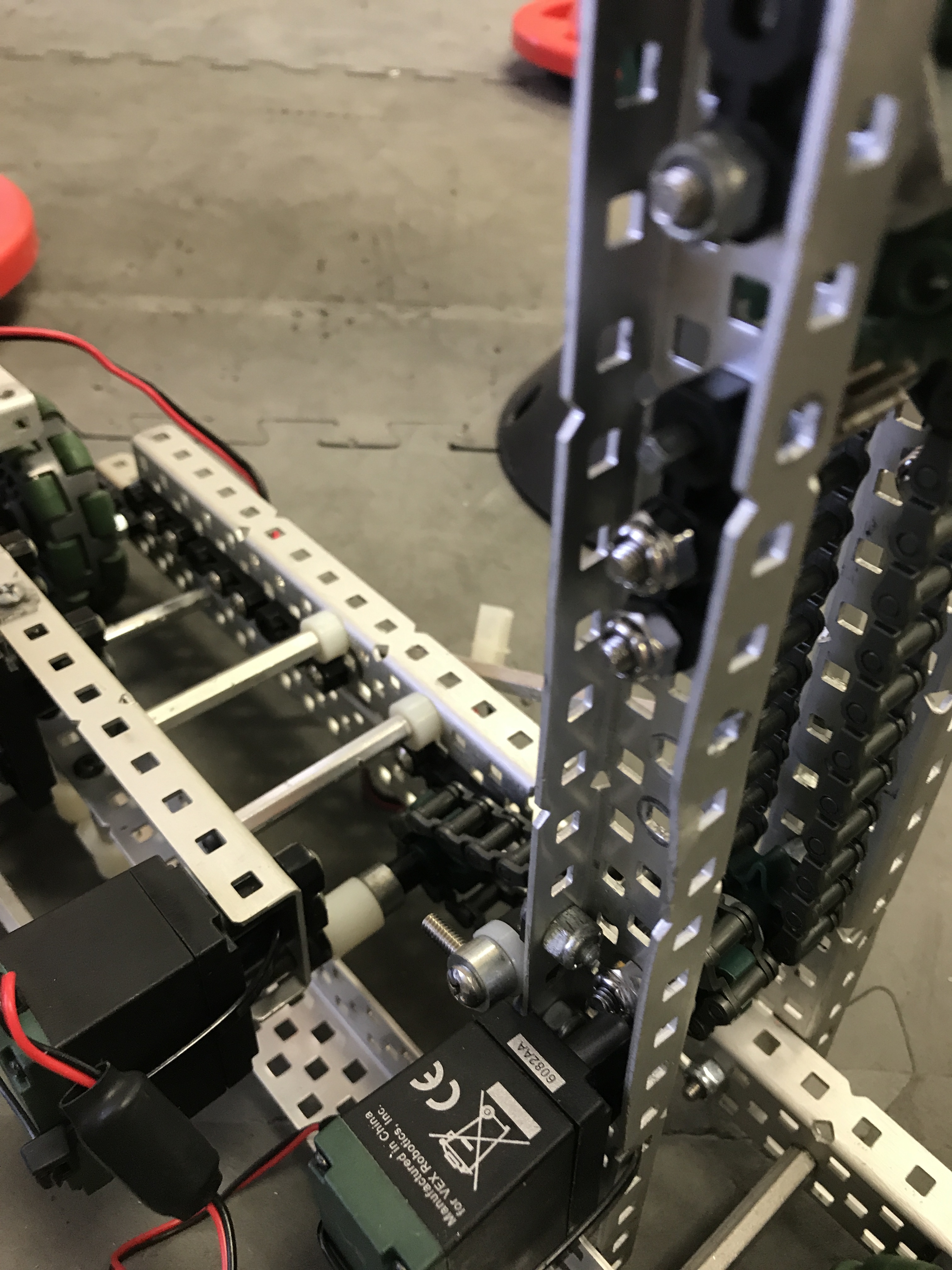

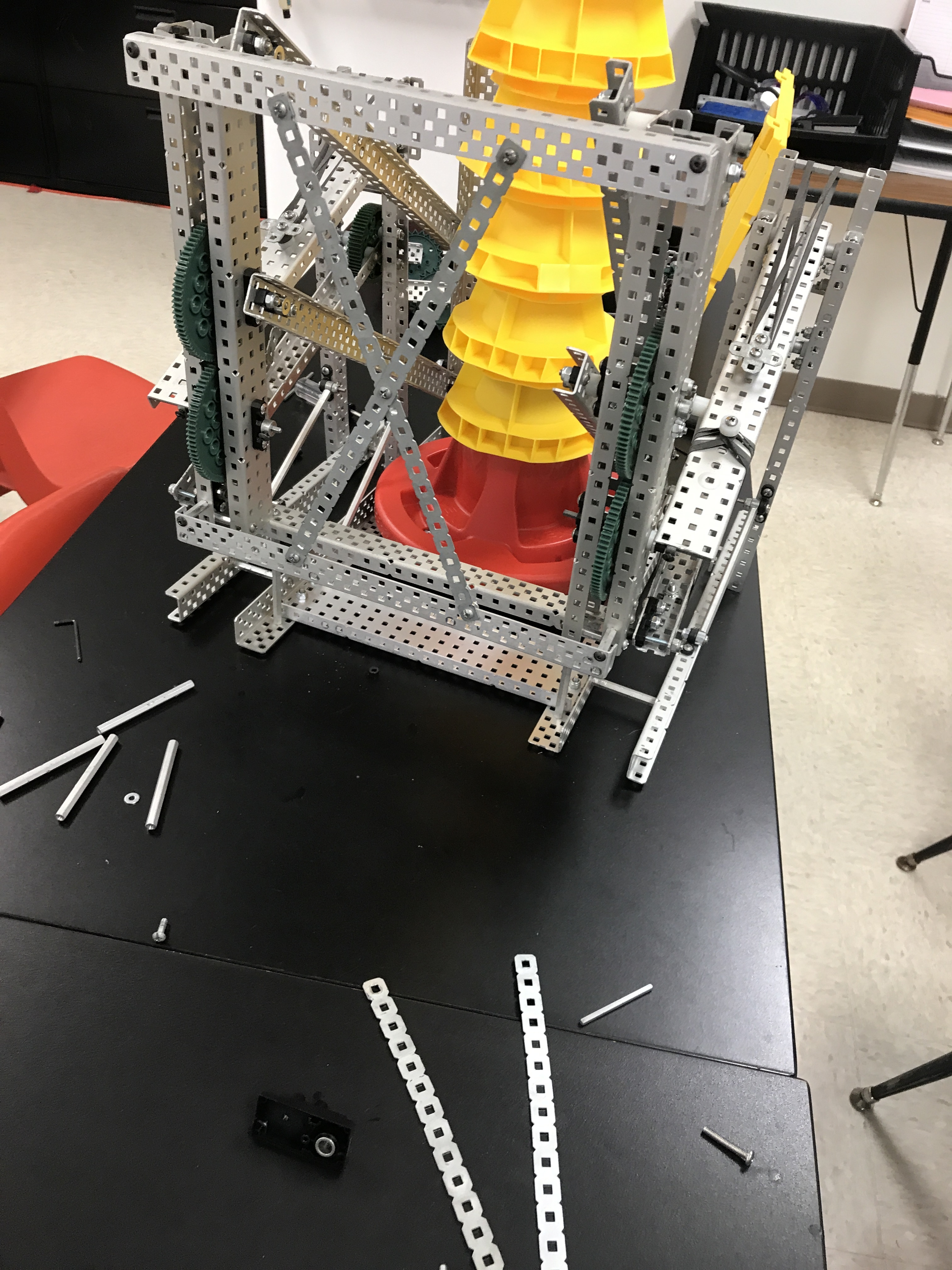

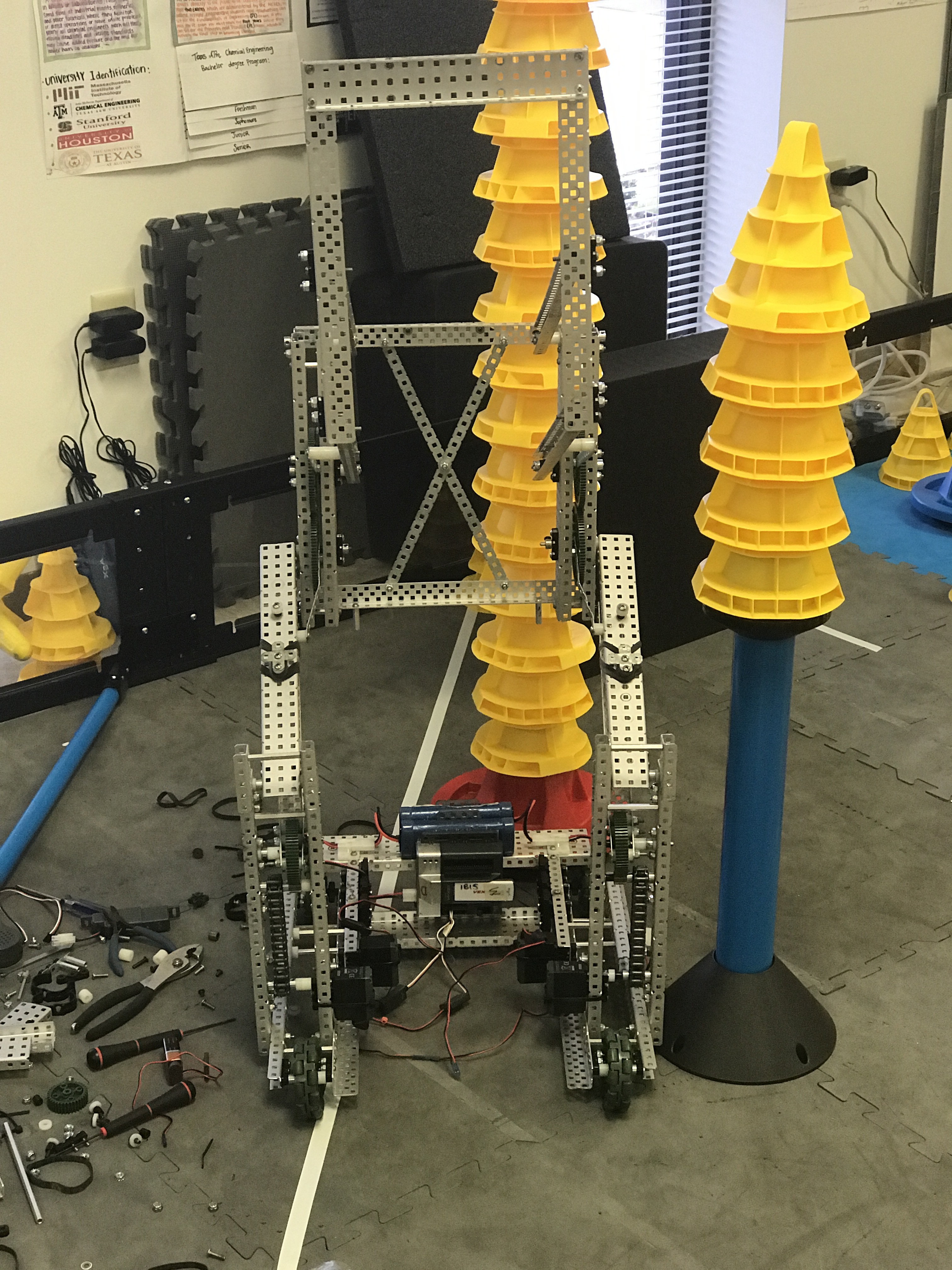

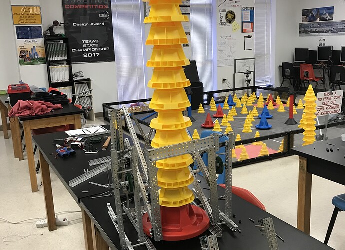

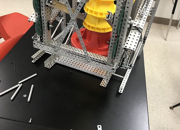

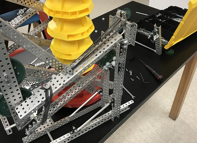

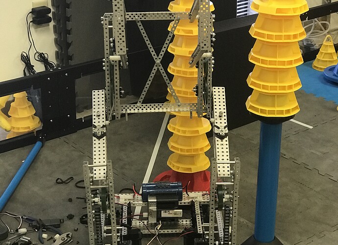

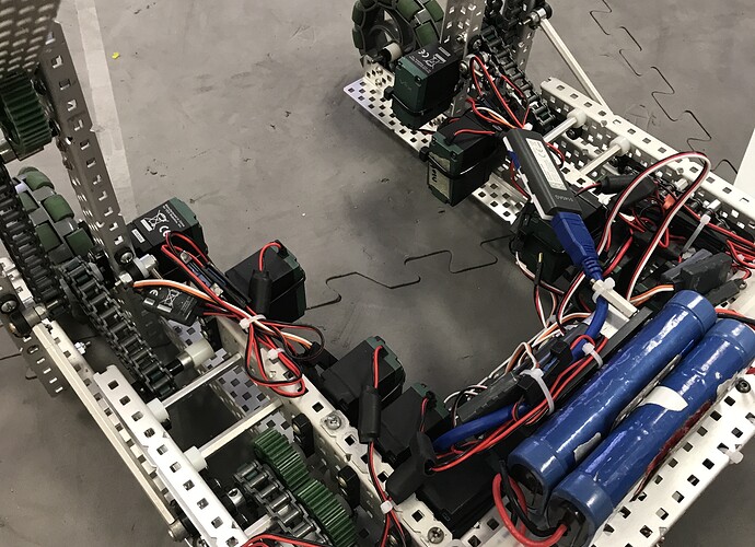

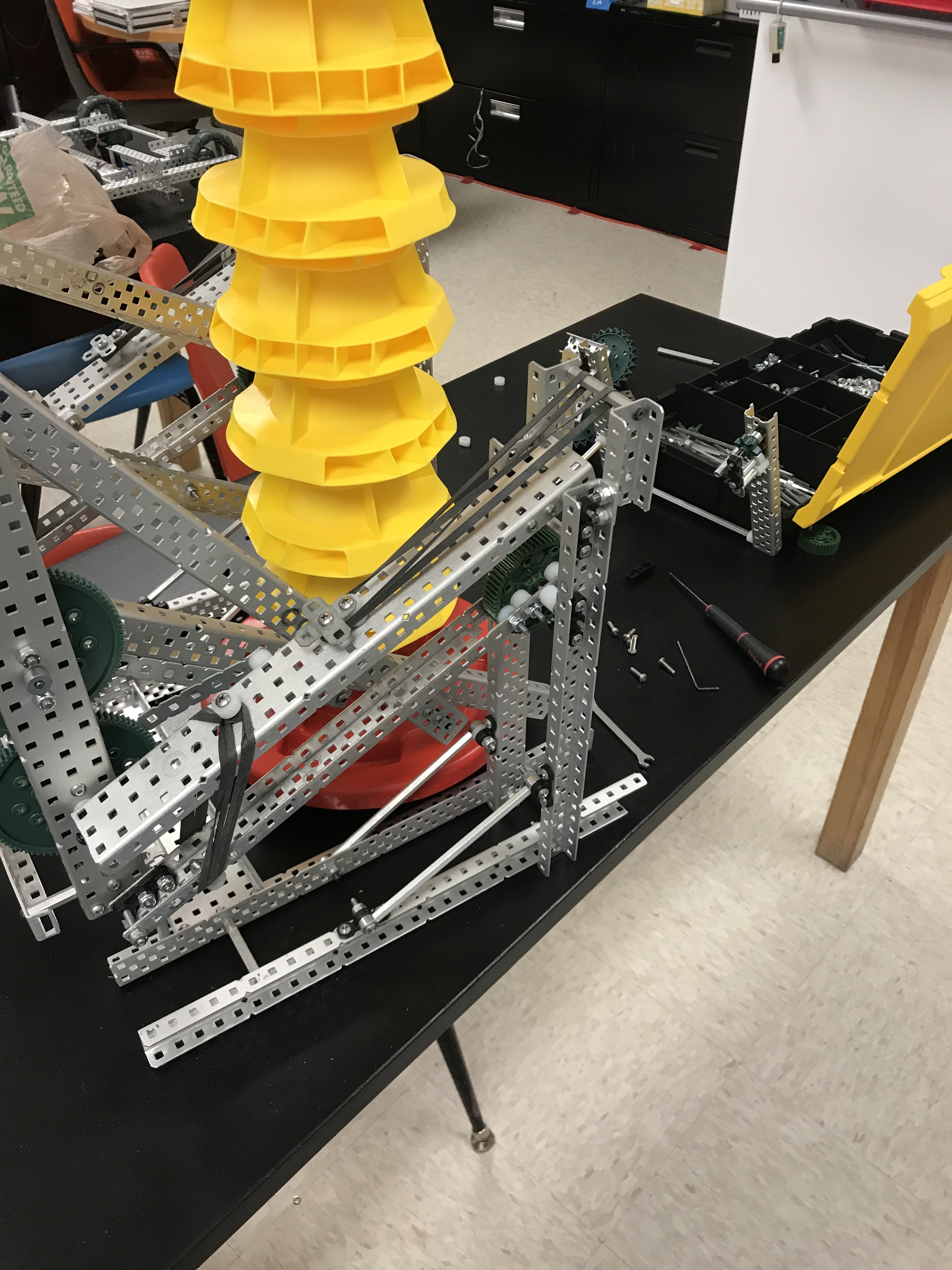

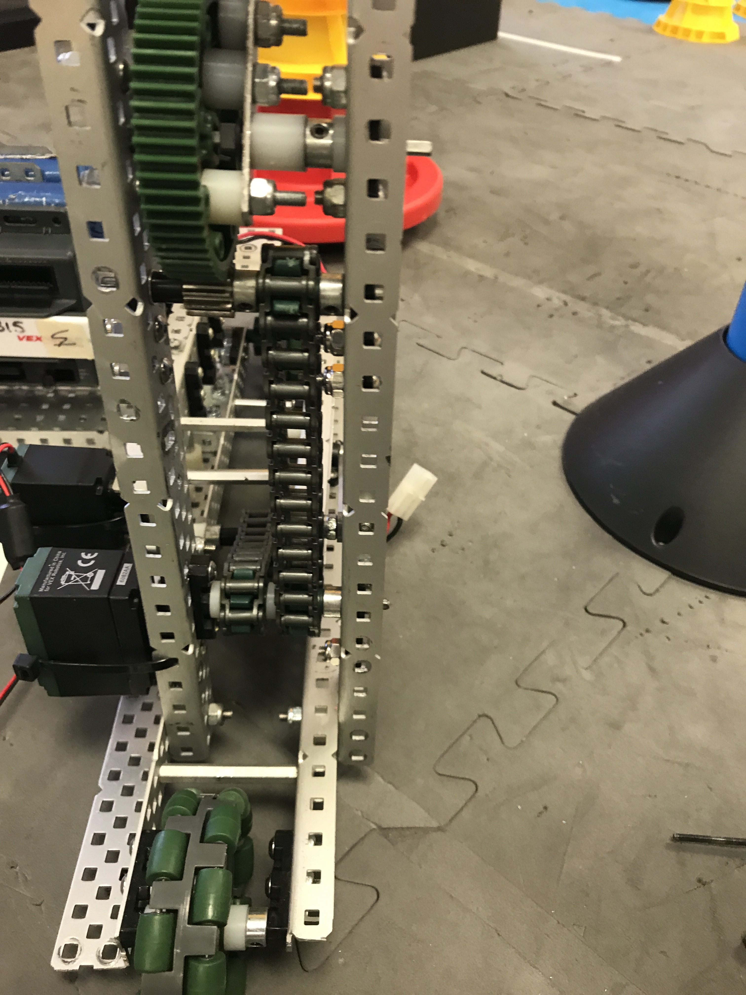

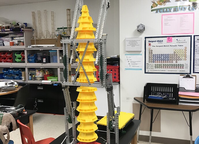

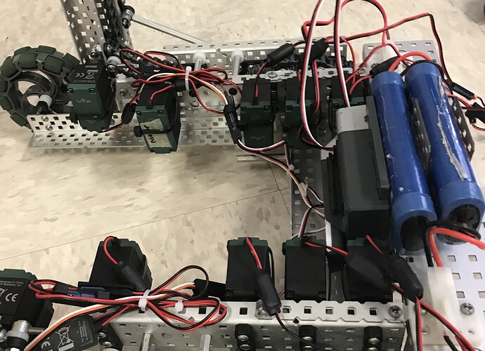

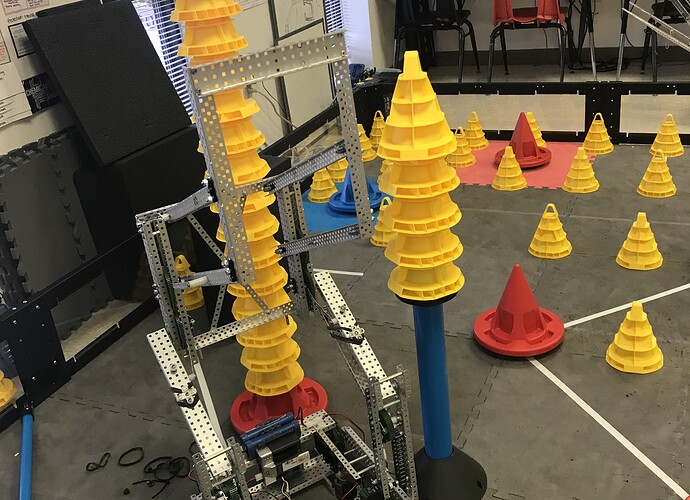

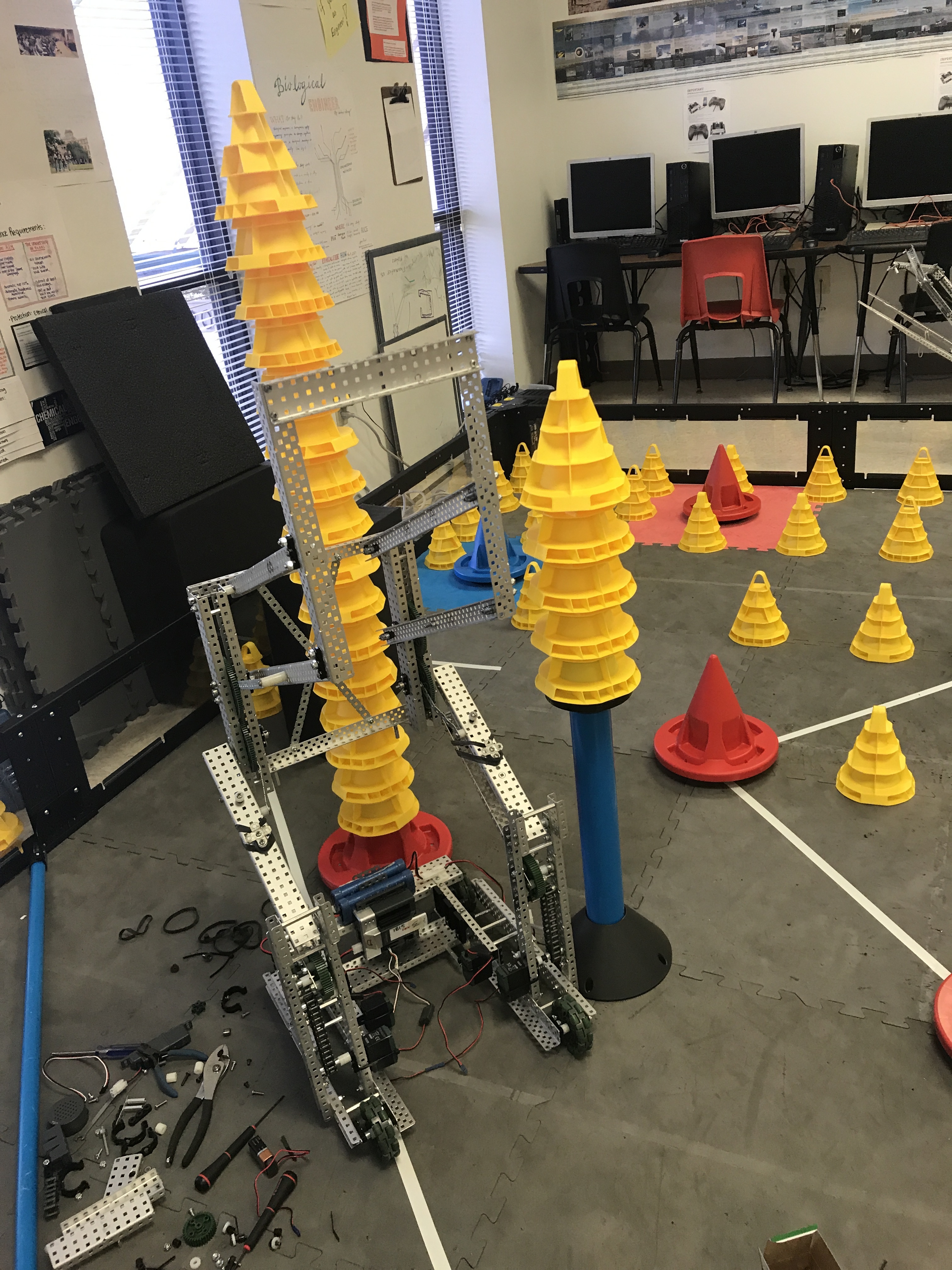

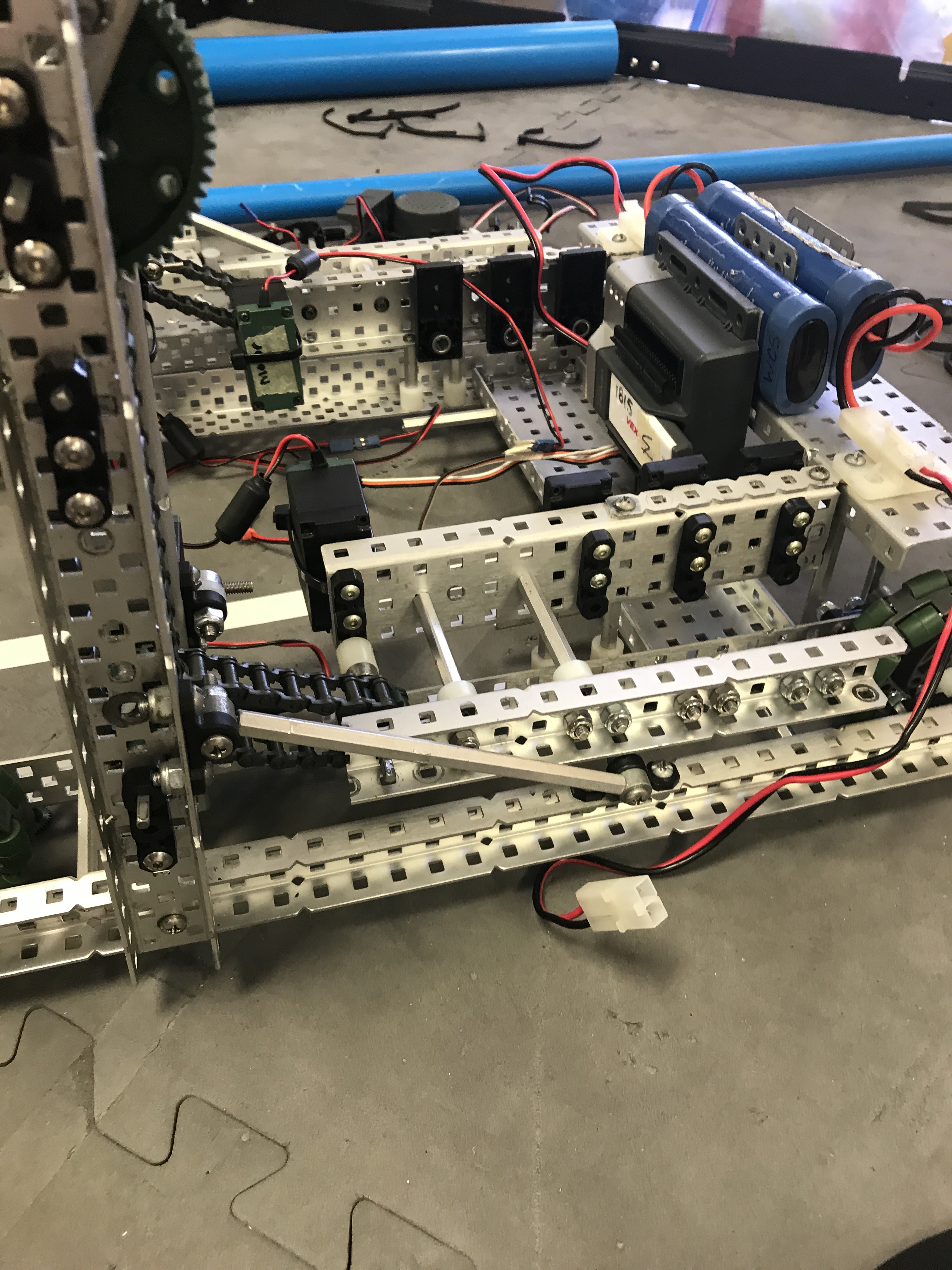

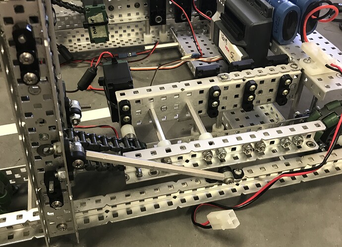

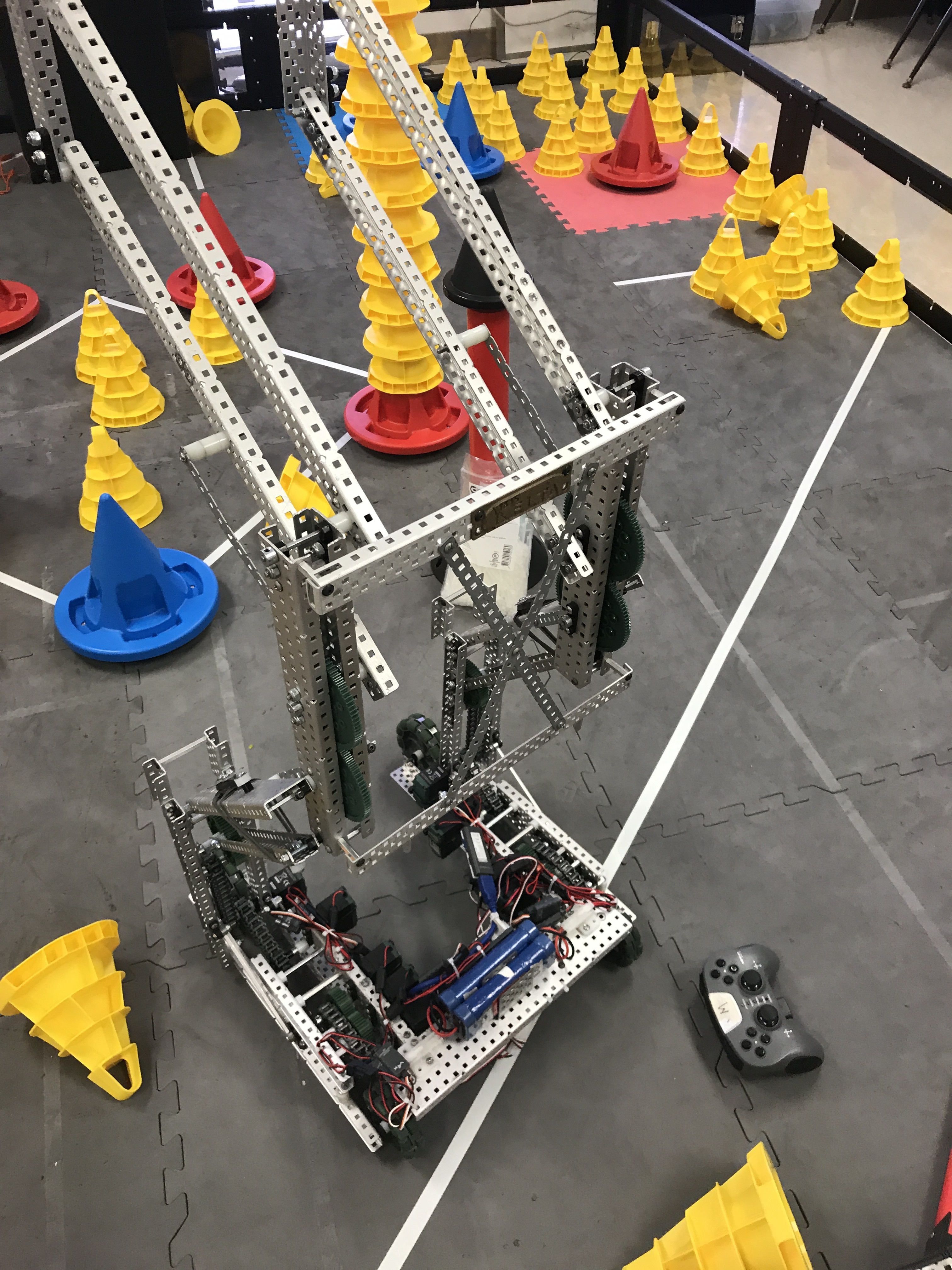

Okay, okay… this isn’t exactly a reveal. But this is a design tested that which failed to our standards. No, the intake won’t be shown, and this is my first time creating a dr4b. I’ve been having one of the worst two days of my life, but I hope you enjoy the concept… (NOTE: When I have time I’ll upload videos to YouTube of the concept. The pictures aren’t in order probably so sorry bout that)
EDIT: Wow, also sorry if the images are stretched.
What was it about this concept that did not meet your standards?

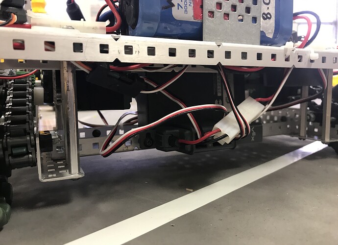

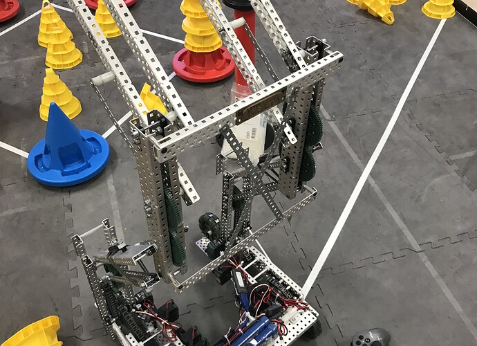

Hmm, nice work. The chassis seems a bit low profile to get over the bump though.

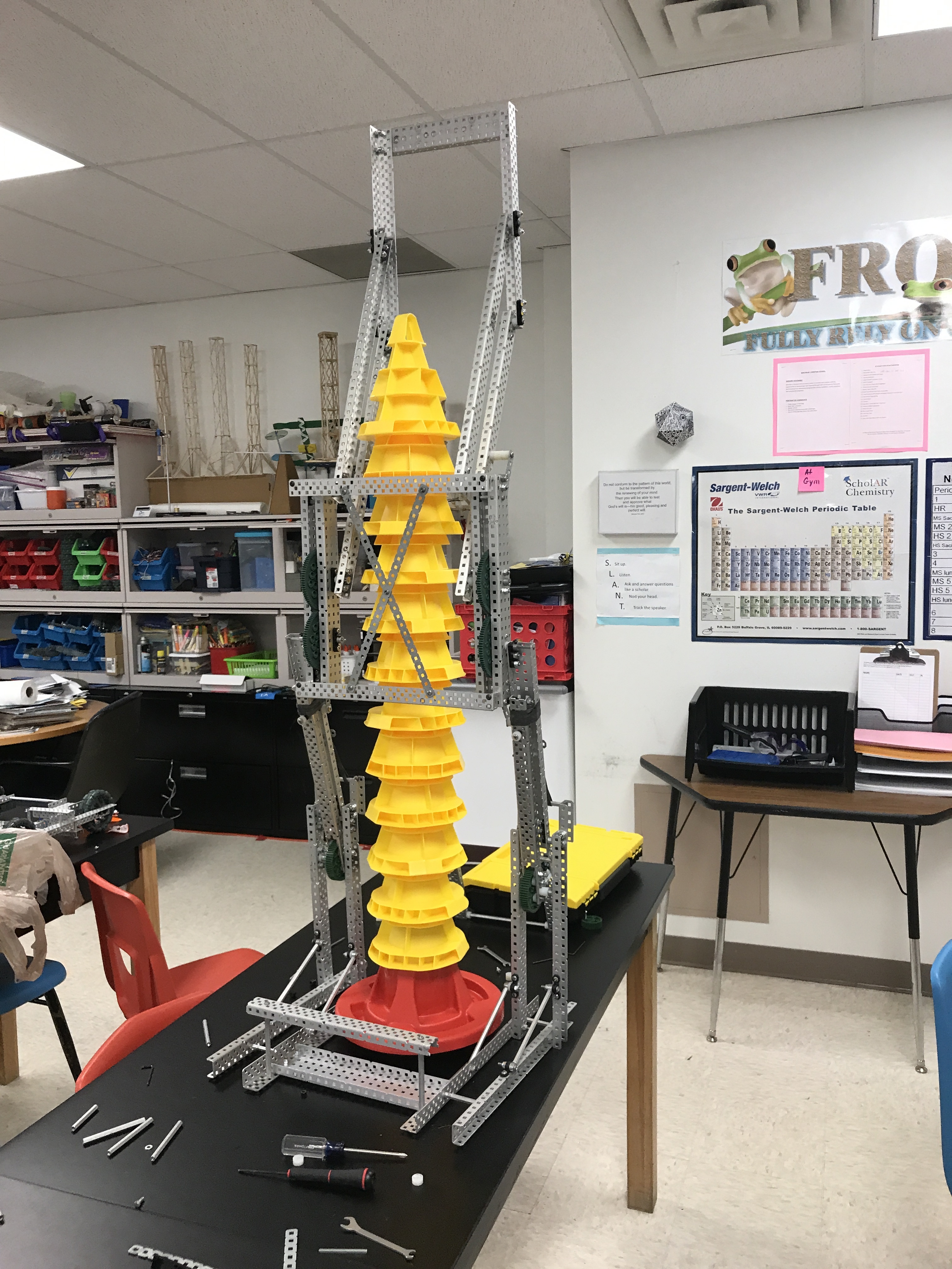

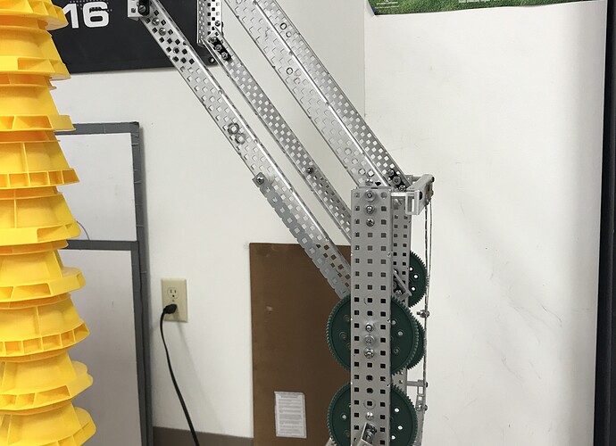

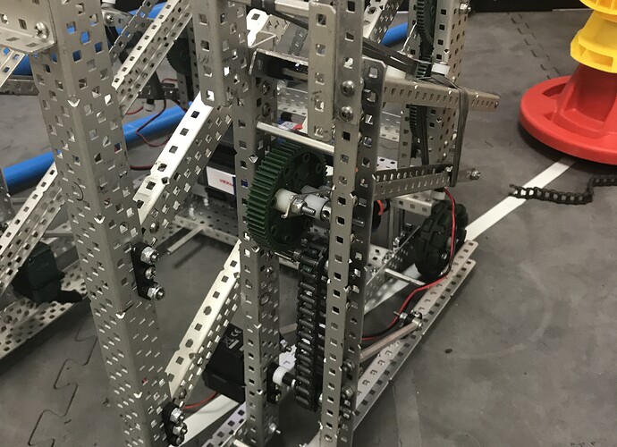

Can’t even push the mobile goal, drive is incredibly unreliable (One side trips way too easy), as well as the lift is unstable. Due to those reasons, I am forced to rebuild with another strategy in-mind.

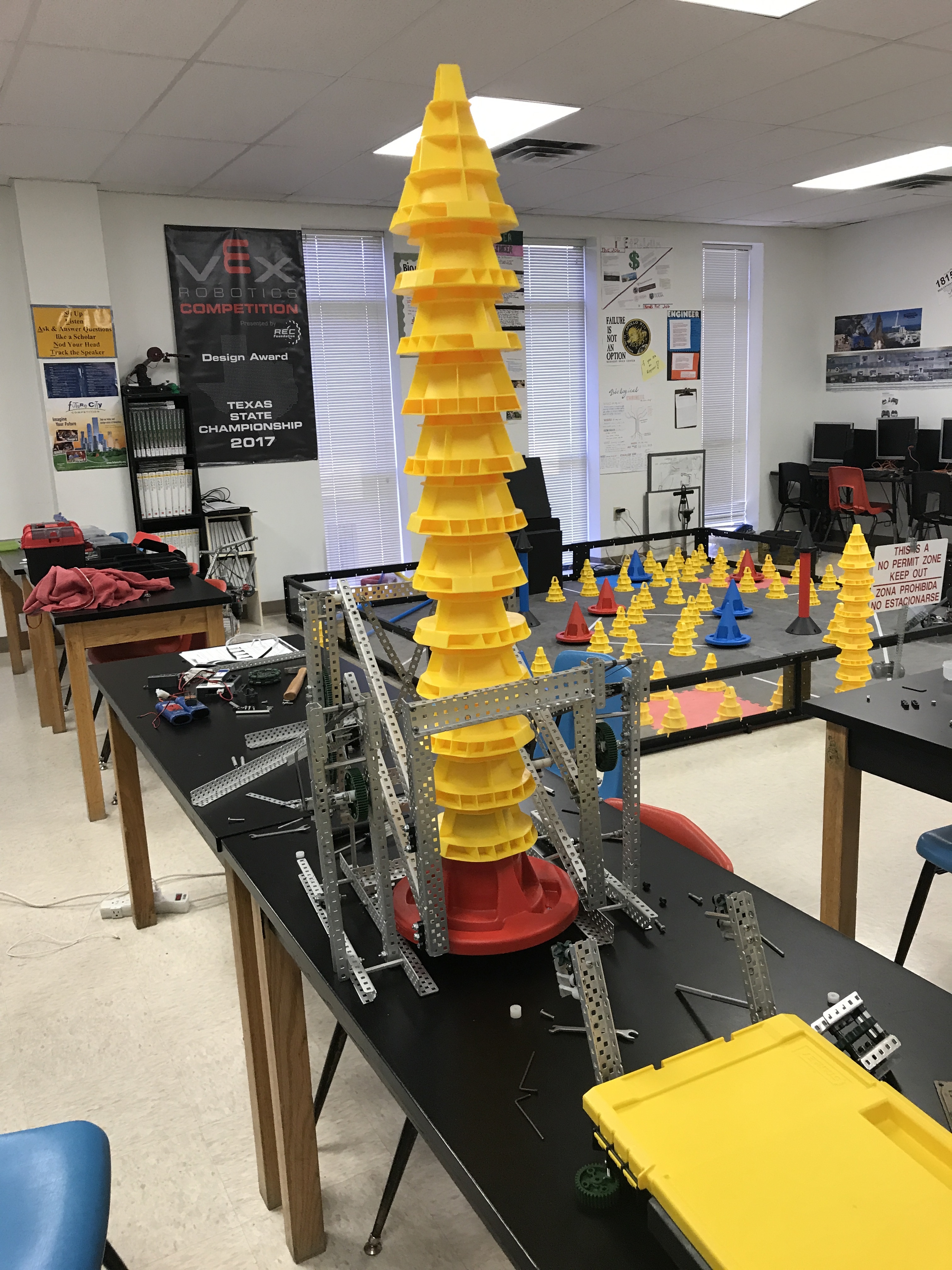

Just for a note: We have already found out an intake that can pick up cones from any orientation.

Yup! It’s low profile to create a lip to hold the mobile goal into itself nice and snug! I tested the robot, it was able to easily go into the 10 point zone… Buuuut you’re right, so the robot wasn’t able to get out.

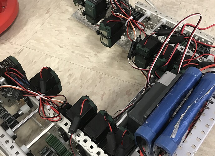

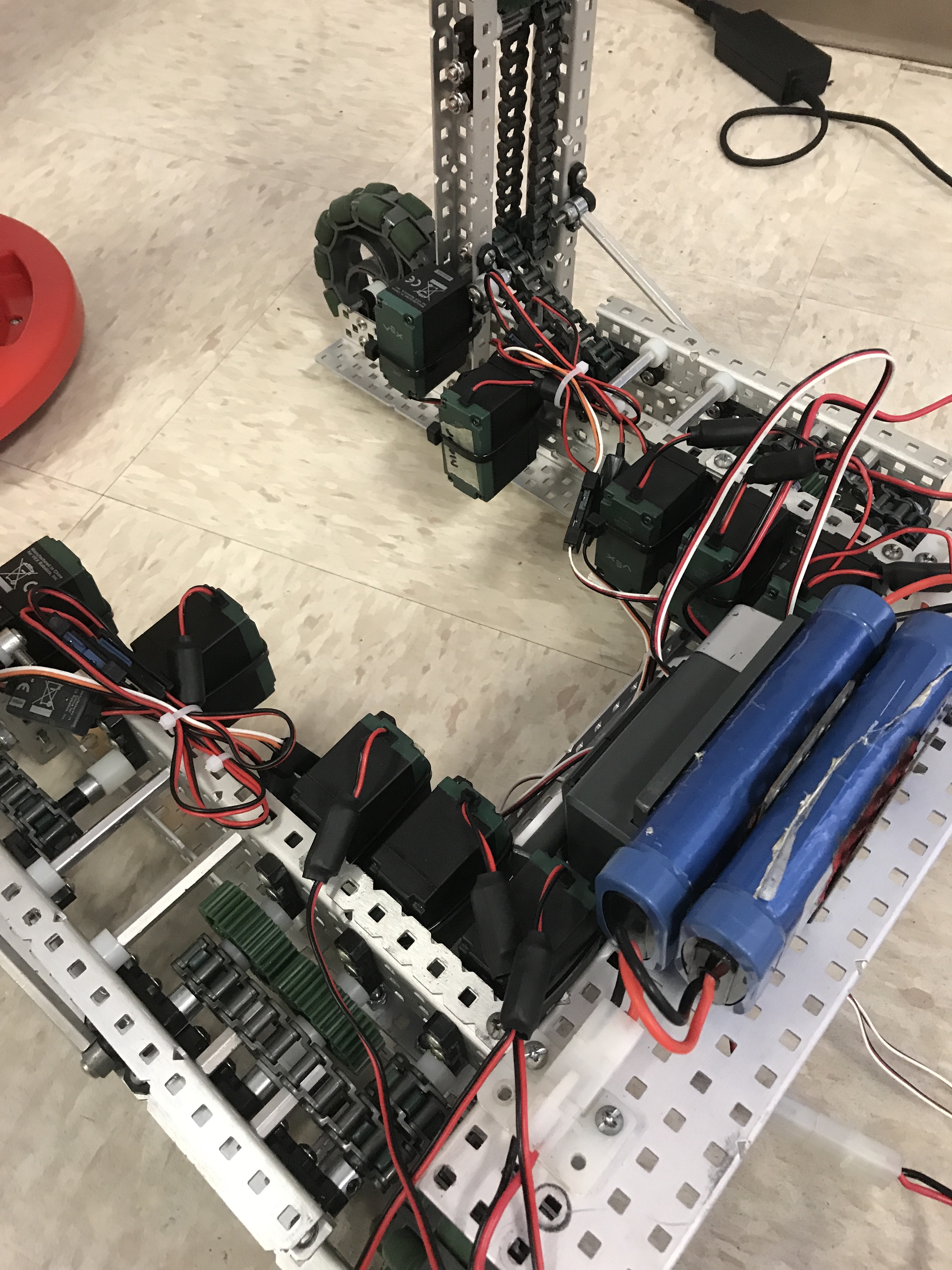

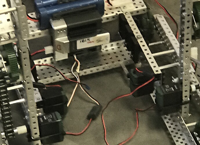

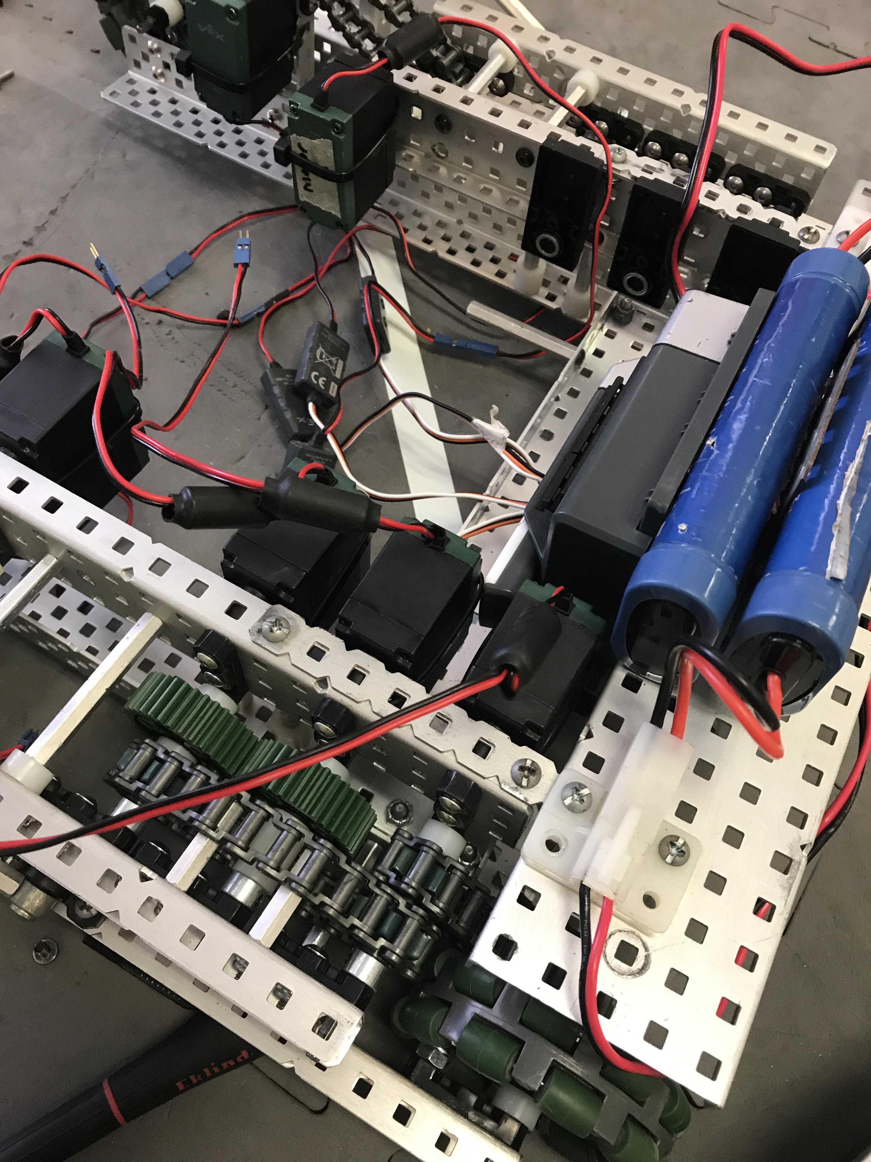

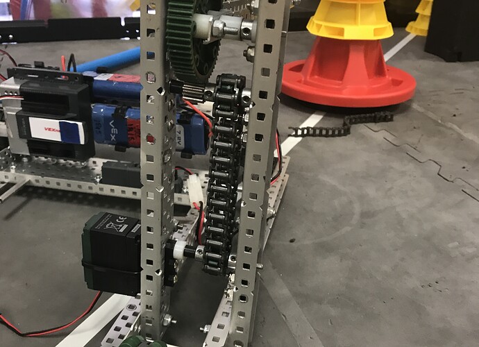

What was the ratio on your drive, and what wheel size? It’s hard to tell if those are 4in omni’s or the 3.25in. Do you feel that the omni’s are going to be a viable option as a drive wheel considering that they are known for having less traction. Also in the final video that you posted your DR4B only seemed slightly unstable while coming down, so I’m wondering if you felt that the mechanism’s unstable nature came from the weight of your team’s intake or because of how you guys built the mechanism.

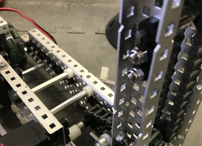

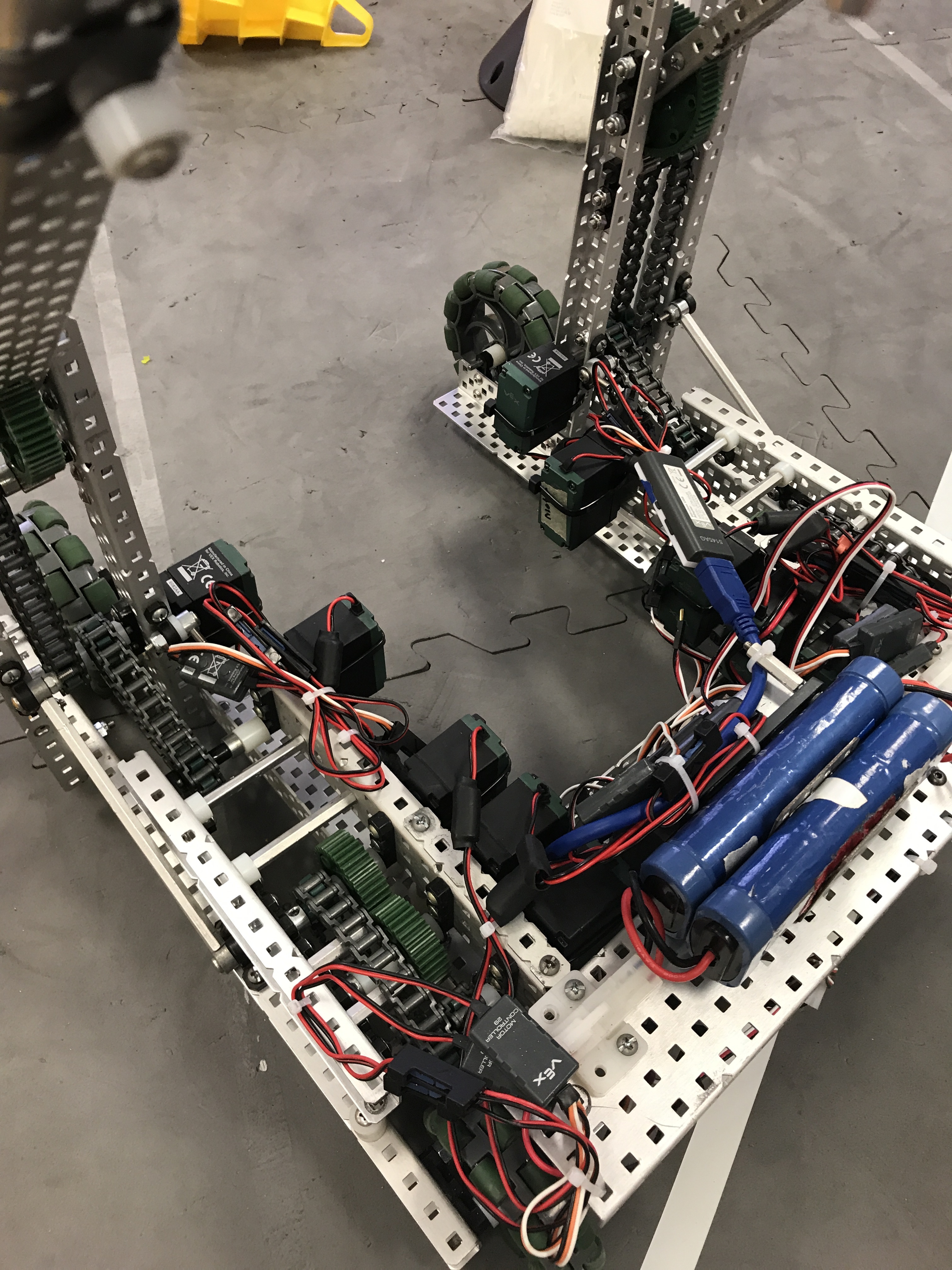

1:1 Turbo 6 Motors
The motors are powering the two back 3.75" wheels. Just for a tip, the front is 4" to go over the 10 pt zone easier.
I haven’t really seen any problems with the type of wheel (If it’s not meconium) for the amount of traction, so I think it’s a viable option. I just had too much friction with the gearbox, so next time I’m keeping it simple ![]()
I think it’s partly the CORTEX in addition to the mechanism, but I’ll double-check tomorrow ![]()
Even if the cone is fallen down and sideways or just fallen down (straight) and upright?

What was the rationale for having the front and back wheels be different sizes, and were the wheels placed so that the robot was level when resting on the floor or was it slightly slanted. Being that the front and back wheels were different sizes and both had the same gear ratio, did your team have any adverse experiences with robot movement, being that the front was moving at a different speed than your rear wheels. Also what made your team choose to use a turbo motor with an external 1:1 gear ratio over a standard or HS motor with external gearing to bring it to the desired speed, and are you guys planning on keeping a 6 motor drive or do you plan to switch to a reduced or higher drive motor count.

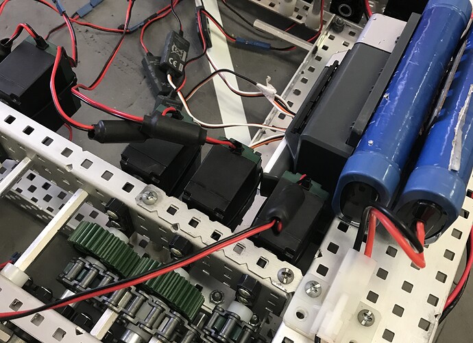

Also does your team spend any time planning out the build before building either on paper or using cad? I ask because your build quality is amazing, especially to be done in only two days. I am definitely a fan of your drive train/ electrical board.
Usually, the hot spot for speed for me is turbo with 3.25" wheels, and I was trying to do 4" wheels on the front to make it easier to go up the PVC.
I did compromise and the placement on the 4" wheels are higher so the robot is as close as possible to be level.
The only wheels powered were the back wheels (Kinda like a car). Soooo wasn’t too smart but I only had so much space to build off of.

My team is a two man team, which one isn’t able to be there so it’s just me… I don’t do CAD models, I just picture the robot out in my mind, and I can somehow tests physics in my mind as well(I kinda underestimated the weight of the mobile goal + cones tho).
Why thank you! I was actually reeeeally lucky when placing everything. One thing I did consider with this robot is that I wanted it to be back heavy to increase traction of the two back wheels, which kinda explained why everything was in one area. Thank you very much! ![]()
