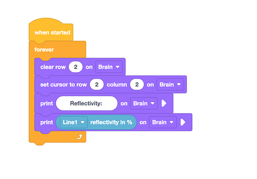

Block code only allows use of reflectivity, so these blocks
would show 10% on the screen.
Hope this helps.
