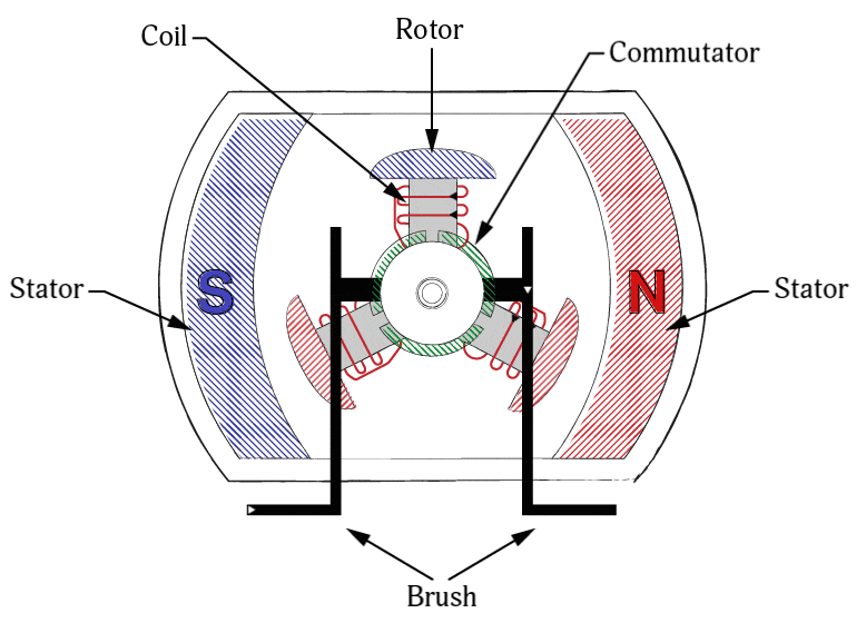

How motors work
While not completely necessary, it’s nice to understand how a motor works to understand basic concepts such as this.
brushedmotor_7
Image Source
VEX
Yay Evan I used citations are you proud of me :))
When a motor changes speed, it’s just changing how fast those electromagnets switch between negative, positive, and neutral.
A motor’s torque is determined by the strength of the magnets - how much electrical currrent flows through them.
By coding for a change in rpm, you’re telling the motor how fast to flip the polarity of those electromagnets. The maximum torque doesn’t change, as the maximum current/power it can pull stays the same.

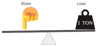

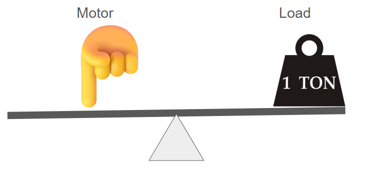

What do gear ratios do?
I like class one levers. Class one levers are funny. They also help you understand gear ratios.
Let’s say the motor is that big finger trying to push down on the seesaw, and there is a big weight on the other end.

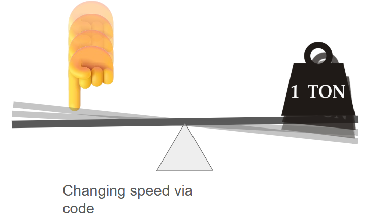

Changing the speed of the motor in the code is equivalent to this hand just pushing down faster - on the other end the load moves faster, but the hand’s max effort* it can use to lift the weight stays the same. The motor spins faster, but the torque limit stays the same.

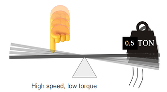

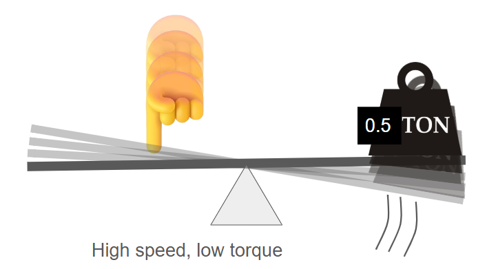

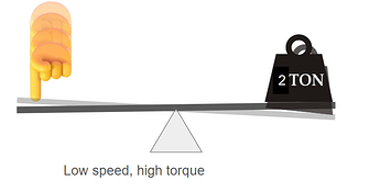

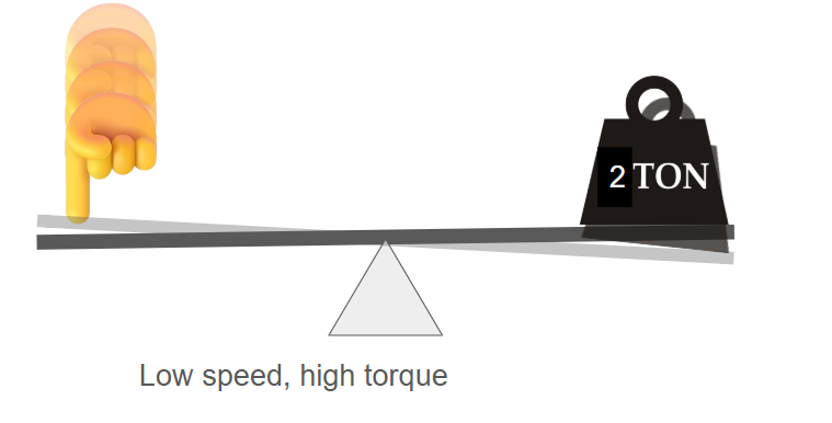

However, changing where the hand is on the seesaw is equivalent to using a gear ratio - going further out reduces the speed at which the load on the other end moves, but the finger can exert less effort* to do so or it can lift more (gearing for low speed high torque). Going further in increases the speed at which the load on the other end moves, but the finger needs to exert much more effort* to do so (gearing for high speed low torque)
