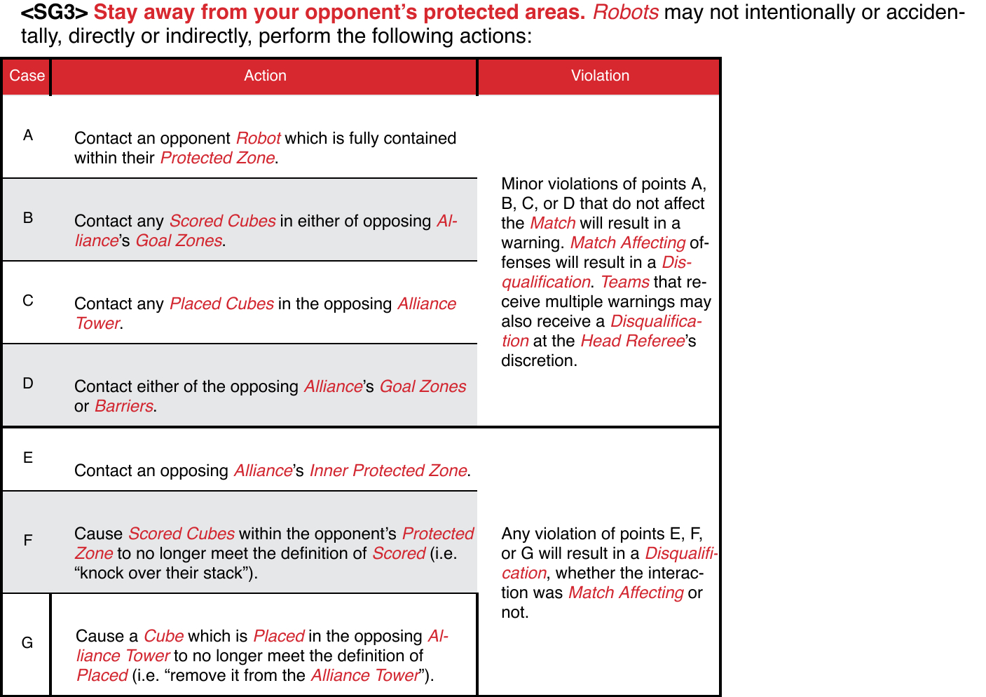

This weekend at states my team was in quarter finals and ahead by 10 points. Then our alliance partner knocked a green out of the small tower by accidentally by hitting the pole of the tower and it landed on the line of the inter protected zone. The ref cited SG7 to disqualify us. Is this a fair ruling?

According to the rules, yes. There have been Q&A responses confirming this scenario is a violation, as the cube is an extension of the robot. The robot of an opposing alliance contacting the inner protected zone is an instant dq, regardless of intention or match affecting, and because the cube is an extension of the bot, it counts as a dq. It is a terrible rule if you ask me, as it does not fill the purpose of rules, which is to facilitate fair play.

So then yes it would be a dq because they were not forced to do anything and the cube was not impacted by another team.

Causing a cube to enter your opposing alliance’s IPZ is an SG3 violation because of SG7
SG7 Use Cubes to play the game. Cubes may not be used to accomplish actions that would be otherwise illegal if they were attempted by Robot mechanisms. Examples include (but are not limited to):
• Encroaching upon an opponent’s Protected Zone per SG3.
And it’s kind of tricky, unless I’m mistaken, the white tape line isn’t part of the inner protected zone. Having a cube roll onto the line but not breaking the vertical volume past the white tape line should be ok, past the white line is a DQ. Only the referee could really assess if the cube was in the IPZ or not.
The disqualification at state was for SG3 and SG7, my team and I were at the competition and did see what happened it seemed to be a fair call by the refs.

Unfortunately, yes, using a game element to do something your robot can’t do is illegal and could result in a DQ on a case to case basis. In this case, a cube accidently falling into the inner protected zone is most likely a DQ especially if it was match affecting.
There is a table, three posts above you, that is copied from the manual and it shows that it doesn’t matter if it was match affecting or not.
