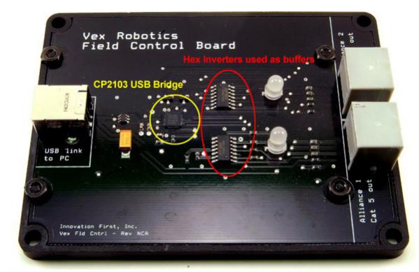

So the first place to visit is the Silicon Laboratories web site, searching on CP210x reveals they have a series of USB to RS232 bridge circuits starting with a product designation of CP210, so how to decide which one.
The tournament manager manual has some good close up photos of the field control hardware.
https://vexforum.com/attachment.php?attachmentid=4915&stc=1&d=1322940261
The silabs chip can be seen so we are on the right track. The first thing to notice is that the IC is in a 28pin package, this narrows down the possible products to three, the CP2101, CP2102 and CP2103. Zooming in on the photo suggests the device is the CP2103, the product datasheets confirm this is the most likely as, in addition to the normal serial port emulation, it has four GPIO pins that may be used as digital inputs or outputs. Silabs have an evaluation kit available for $29 so an order was placed. The evalution kit is also available from digikey for the same price.
https://vexforum.com/attachment.php?attachmentid=4912&stc=1&d=1322940218
The evaluation kit consists of a small board with the CP2103 along with cables and software. The board provides jumpers on all signals for test purposes and LED’s on the four GPIO lines.
I had fully expected that some reconfiguration of the evaluation board would be necessary, perhaps changing the USB product string to “VEX Competition Field Controller” or something like that. However, after connecting the evaluation board to the PC, allowing the drivers to load and starting the tournament manager software, I was given the option of assigning this new “Field Controller” to a match field.
Testing driver and autonomous control suggests that GPIO_1 is used as the enable/disable signal and GPIO_0 is used as driver/autonomous selection. I’m only interested in operation with VEXnet but assume one of the other GPIO signals would perhaps be transmitter enable/disable for the 75MHz systems. The match timer now operates correctly with the large timer numbers visible on the audience display.

That looks really cool would I be correct to assume that the four jumpers aligned with the LED’s control the LED’s and could be used to get the activate/disable, auton/driver signals off the board easily?
Yes, they are inline with the LEDs. Removing the jumper would disable the LED but allow another board to be piggybacked with this one. 3.3V and GND are also available. The enable/disable and driver/auto signals are inverted I think so an inverting buffer would be needed, probably use some type of open collector buffer. I may also opto isolate the signals if building a field controller as power is also available on the competition connector of the joystick. I’m pretty sure RTS was also toggling with the enable/disable so this could also be used (again indirectly, wrong levels for the joystick input).
