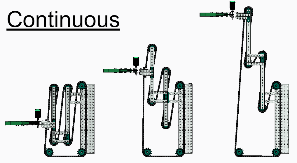

I wouldn’t use “the” clawbot but most teams are using a claw locking mechanism and a lift
here is an example of a continous lift
My team specifically is not doing an intake, and our bot will be pretty stable. I recommend a cascade/continuous lift, or if you don’t think you would have enough time (but I highly suggest not using), a regular claw bot. I think you should use a claw instead of intaking cups and pins.
