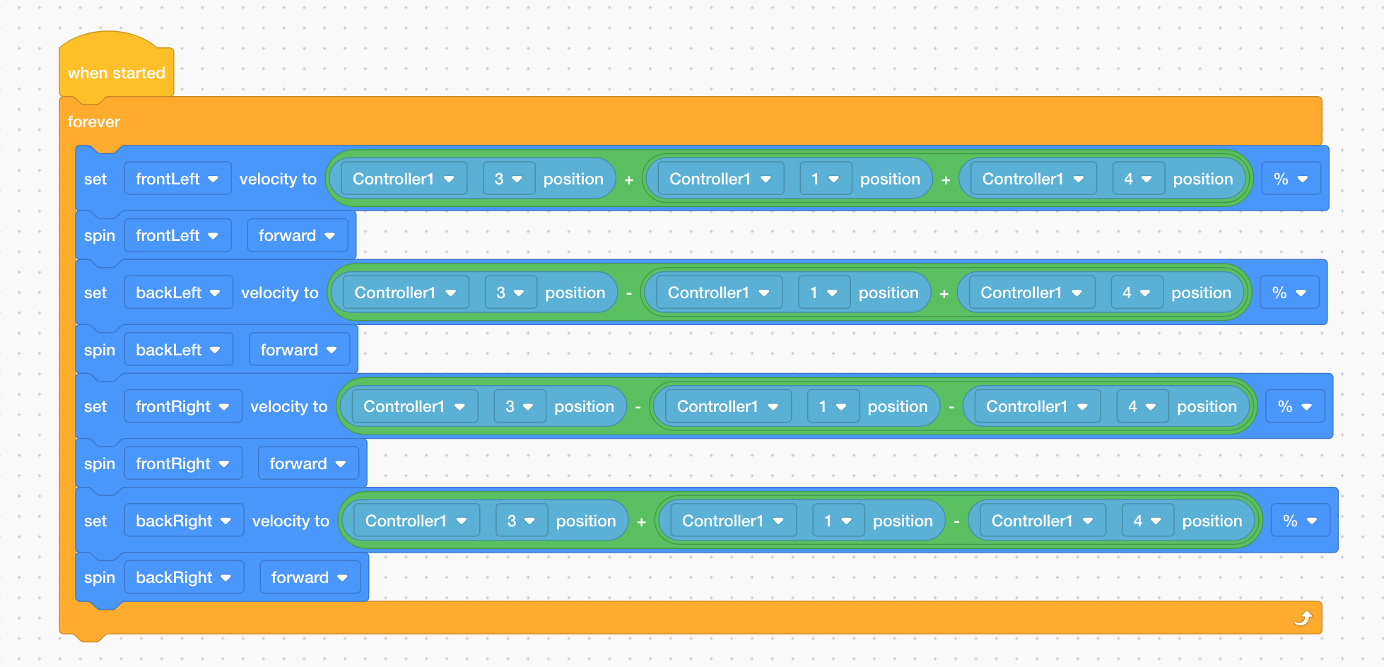

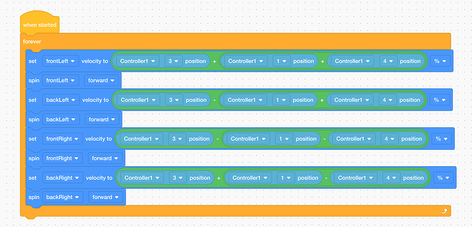

This is what I have so far. I found it off the internet and I am not sure if it will work
That looks like the general format, but it looks like it is using channel 3 for rotation and mixing up a few other channels.

But looking at this as mecanum, it still does not look correct. Assuming that the motor directions are not reversed in the configuration, it looks like Ch3 would control rotation while Ch1 and Ch4 would control linear movement. Kind of a strange set up in my view.
It does look more correct, though, IF the motor direction was reversed on both right side motors. Then the left stick is linear movement and the right stick is rotation. Its late (for me) and I could be wrong, but I think there is still an error on the back left motor. Ch1 and Ch3 should both be +, but Ch4 should be -.

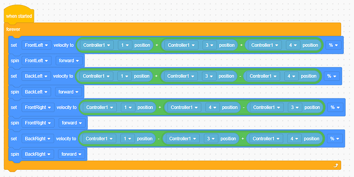

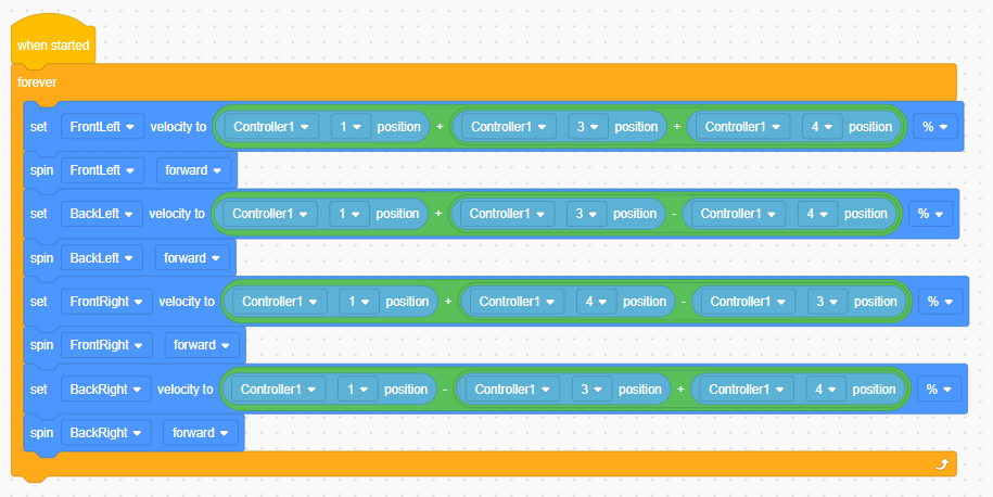

If I remember correctly, this is what it should look like if NO motors are reversed (again, you need to be careful with the nested subtraction operations).
