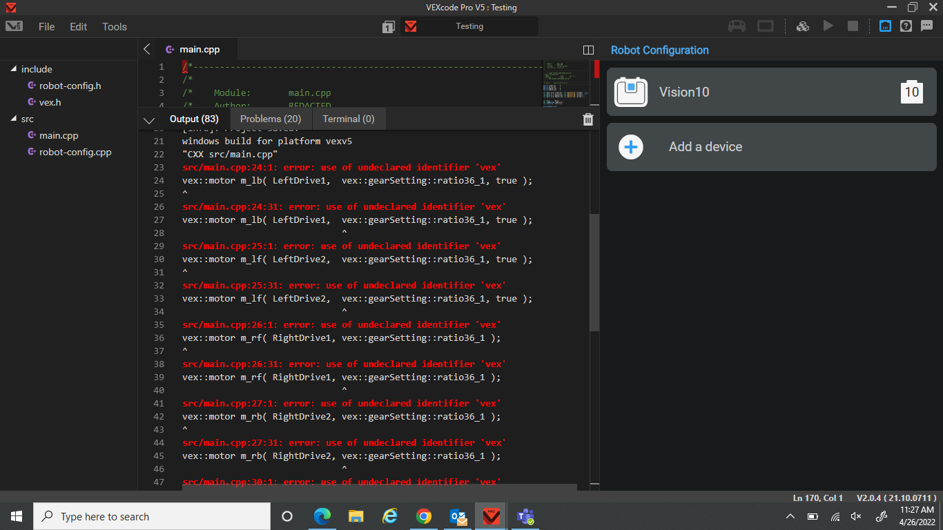

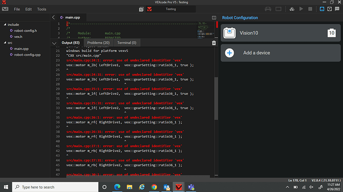

Can you do me a favor and add all of the sensors to the vexcode setup, and copy and paste your VCS code into the main.cpp file?
Compile and share a screenshot of the errors and terminal output
Oh dang, that seems strange. Can you also post your code possibly and surround the code with [code] and [/code] to format it as code in the forum?

Use #include <vex.h>
That is the vast majority of errors (I think VCS auto includes vex header file by default, I may be wrong)
This made some errors go away but then there were new ones.
Can you post them? <20char>
Also, have you configured the motors? The comments indicate that you haven’t

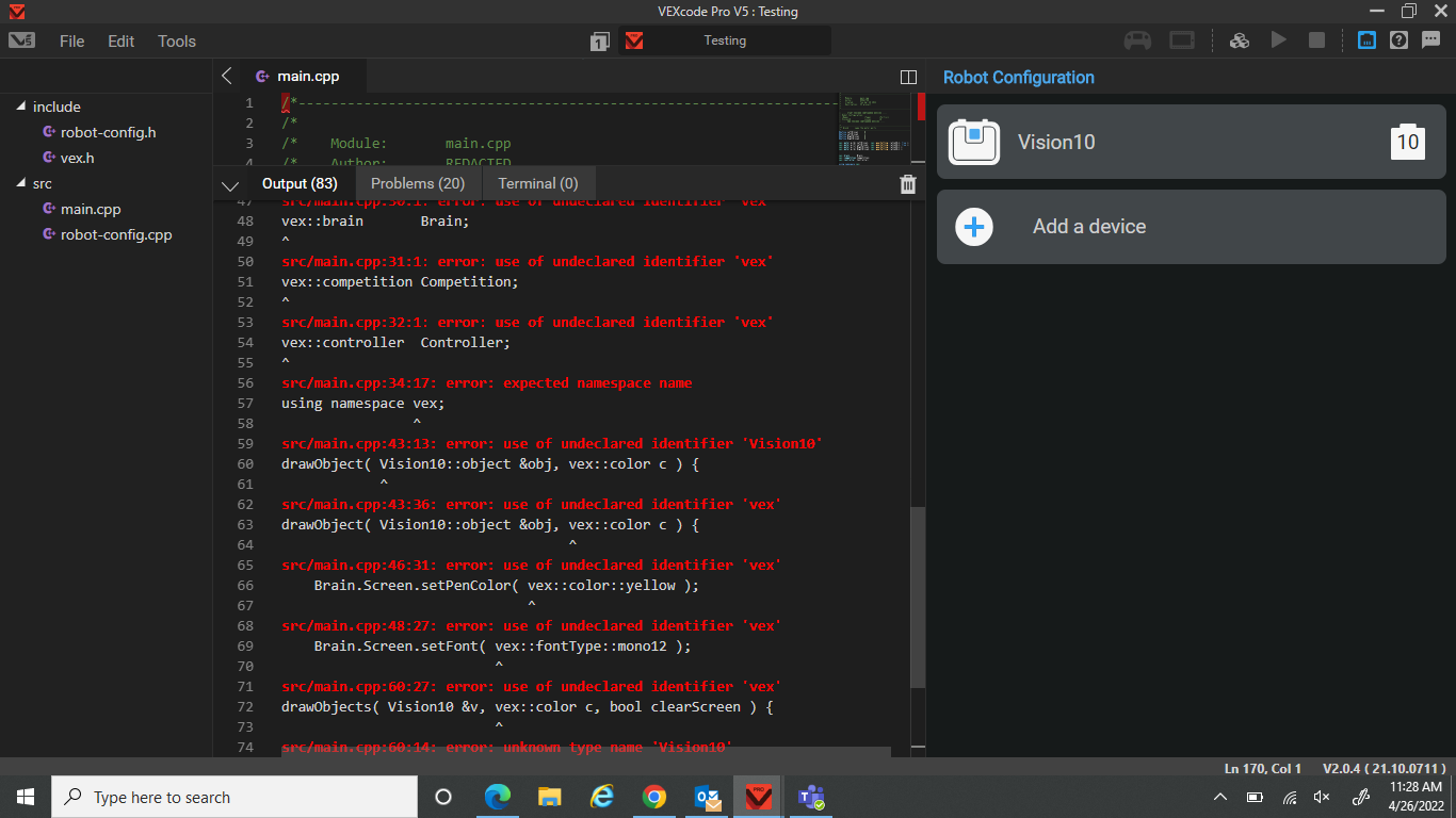

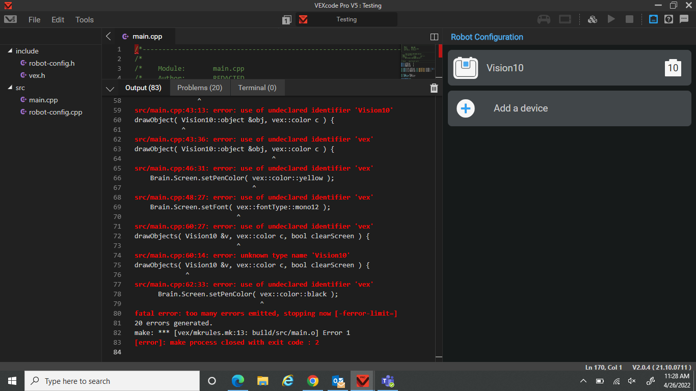

src/main.cpp:45:13: error: 'Vision10' is not a class, namespace, or enumeration
drawObject( Vision10::object &obj, vex::color c ) {
include/robot-config.h:15:15: note: 'Vision10' declared here
extern vision Vision10;
src/main.cpp:55:13: error: no member named 'LCD' in 'vex::brain'
      Brain.LCD.printAt( screen_origin_x + obj.originX + labelOffset, screen_origin_y + obj.originY-3, "Sig %o", obj.id );
src/main.cpp:57:13: error: no member named 'LCD' in 'vex::brain'
      Brain.LCD.printAt( screen_origin_x + obj.originX + labelOffset, screen_origin_y + obj.originY+10, "Sig %o", obj.id );
src/main.cpp:62:1: error: variable has incomplete type 'void'
drawObjects( Vision10 &v, vex::color c, bool clearScreen ) {
src/main.cpp:62:38: error: expected '(' for function-style cast or type construction
src/main.cpp:62:46: error: expected '(' for function-style cast or type construction
src/main.cpp:62:24: error: use of undeclared identifier 'v'
src/main.cpp:62:59: error: expected ';' after top level declarator
src/main.cpp:82:9: error: use of undeclared identifier 'turning'
        turning = true;
src/main.cpp:84:9: error: use of undeclared identifier 'turning'
        turning = false;
src/main.cpp:110:25: error: use of undeclared identifier 'Vision1'
    int numberObjects = Vision1.takeSnapshot( SIG_1 );
src/main.cpp:110:47: error: use of undeclared identifier 'SIG_1'
src/main.cpp:114:33: error: use of undeclared identifier 'Vision1'; did you mean 'Vision10'?
      vex::vision::object obj = Vision1.objects[0];
                                Vision10
src/main.cpp:161:27: error: use of undeclared identifier 'Vision1'
src/main.cpp:161:49: error: use of undeclared identifier 'SIG_1'
src/main.cpp:168:36: error: use of undeclared identifier 'Vision1'; did you mean 'Vision10'?
      Brain.Screen.print( "C %4d", Vision1.objects[0].centerY  );
                                   Vision10
src/main.cpp:171:20: error: use of undeclared identifier 'Vision1'; did you mean 'Vision10'?
      drawObjects( Vision1, vex::color::blue, true );
                   Vision10
17 errors generated.
make: *** [vex/mkrules.mk:13: build/src/main.o] Error 1
[error]: make process closed with exit code : 2
Just did, not much changed.
2 things. It is no longer Brain.LCD It is now Brain.Screen .
Secondly, review the new syntax for vision sensors. The commands have changed a lot. It is no longer just SIG_1 but actually something like VISION_SIG_1 (look at robot-config.h)
